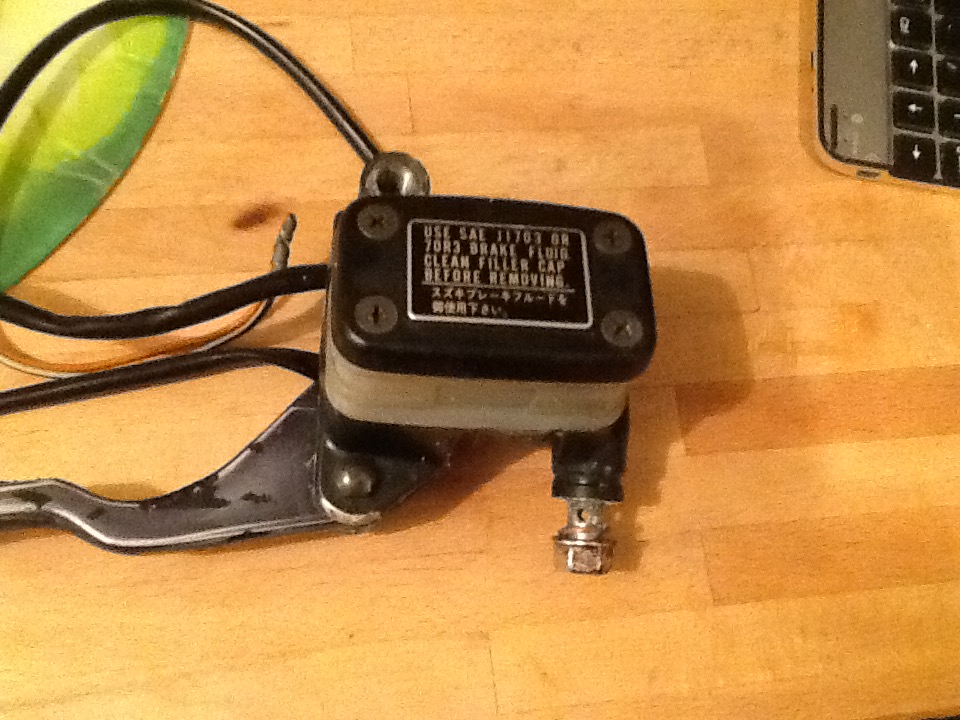

Recovered from hibernation, complete with lever and brake switch. I will need to keep the front of the clamp but you must have one .
Will send a PM with PayPal address etc. Let me know postal address on reply.
