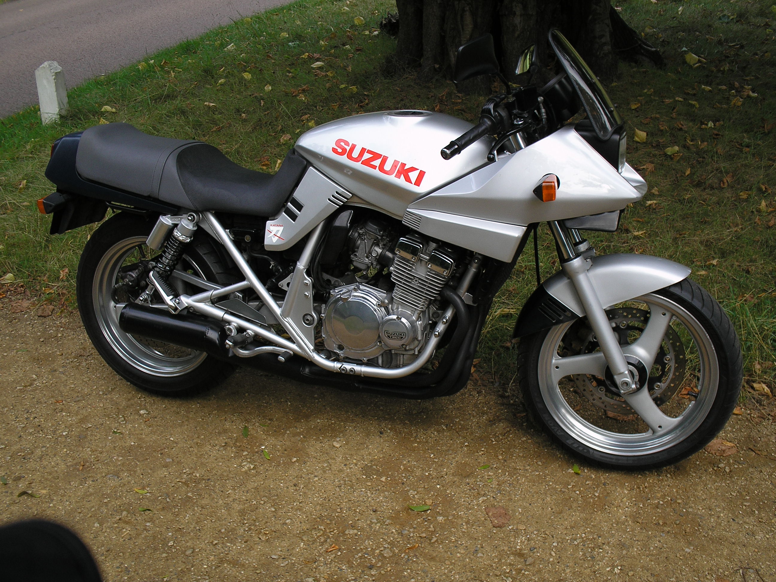

Had the same thing waking up my 250, took the battery out in October last year to trickle charge it :shock: left it with a full tank of E5 and some fuel fit petrol additive, got the litetek viton carb kit fitted as well, last week I put the battery back in, pumped up the tyres, gave the carb float bowls a tap in case the floats had got stuck (once bitten!) and after a few prods of the starter button it fired into life 8-) had a great trip around my local roads just to re-adjust to riding a bike again and is now ready for the summer (hope we get one this year) don't worry Smallkat, I won't put any pictures up :lol:

Post by pookie » Thu Mar 27, 2025 12:16 pm
Oh! I couldn't resist!
But you promised!
