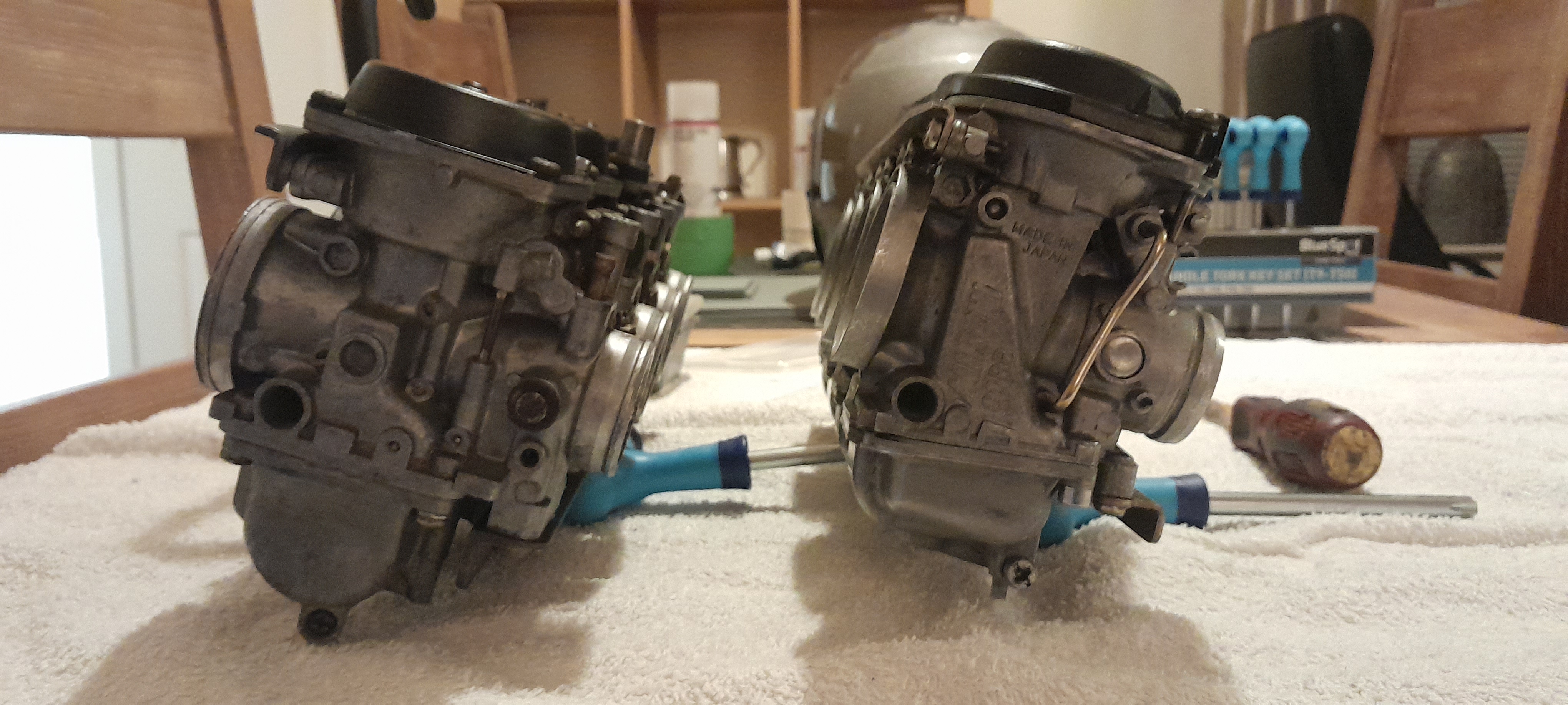

Also, why are the BS type far less prone to flooding? That is easier to answer. The float bowls are larger and deeper that the BDST's, more fluid pressure on the floats to keep them properly closed. It may be that the greater volume of fuel in the BS float chambers assists the choke circuit too..... Its my theory anyway.
Pic 1 demonstrates the deep floatbowl on the BS and the short choke mixture path compared to the BDST
So, on with the install. First find some GS550 CV carbs, from the late issue of the model. As these are aged carbs, all the usual checks must be made. Diaphrams, clear jets, no corrosion etc, Check also that the small rubber bungs covering the pilot jet housing are present and in good condition. They are available on E Bay if needed. You will also need to source #90 main jets, the pilots are fine. The slides in the BS are heavier brass items. I drilled out the air bleed hole to 6mm in the base and also shortened the return spring in the slide body to roughly two thirds its length. This to assist the vacuum actuation of the diaphram.
