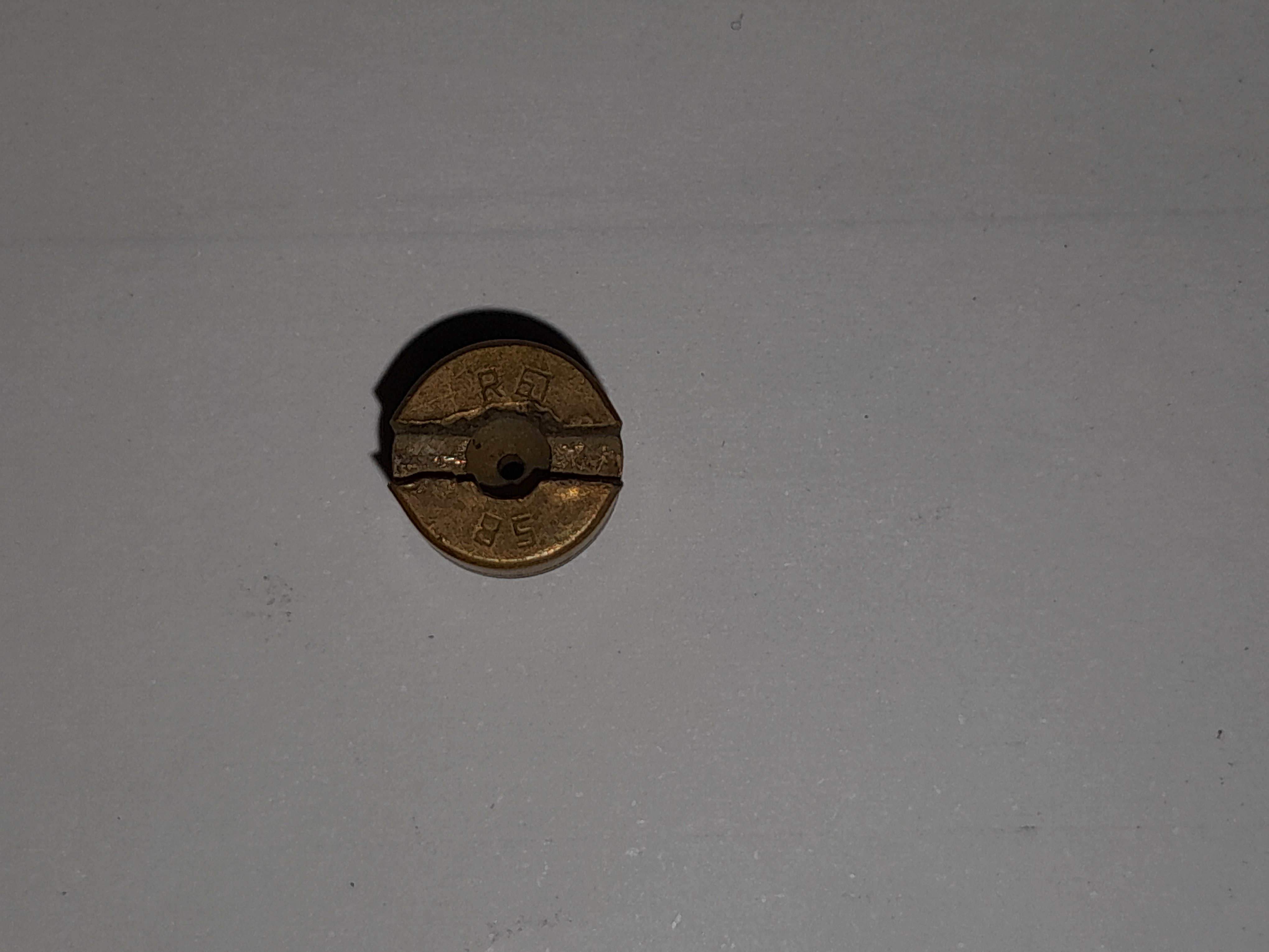

Think I've found the reason for the flat spot. Main jet reads 58, should be 80?

The main jet is 85...are you sure that the 58 is not 85 read the wrong way round ....rejetting down so far from 85 to 58 with standard zorst I'd find it hard to believe it would run well ( barring flat spot.)

As usual, you are right fossie. I was reading it round from the R, rather than from the outer edge. Trust it to be a number that can be read both ways round! Some more investigations to be undertaken.
Air filter is clean, looks new.
Symptoms are:
Runs fine at low speeds, low throttle opening, but just give that hollow, burrrrr noise when larger throttle openings are given. The wall is dead on 5000 rpm. It can be tickled higher, but does not really want to run. Its the transition between pilot and main jets. All jets are clean, carb body has beeen ultrasonically cleaned, nitron gaskets fitted. All rubbers in place and clamped tight. Not an igniter limiter, it will clear the clock in neutral.
Getting too good at whipping carbs in and out...
Cheers
