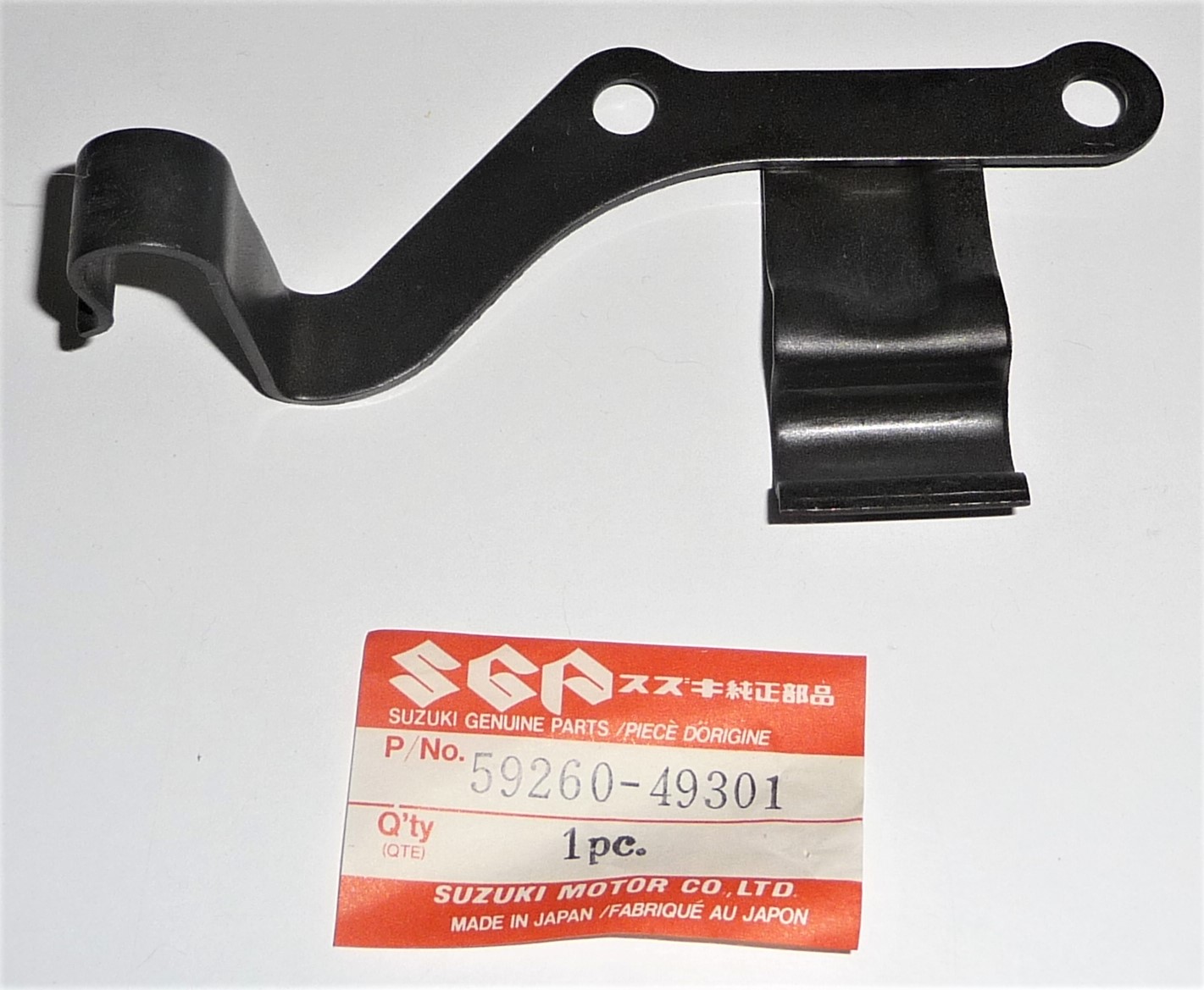

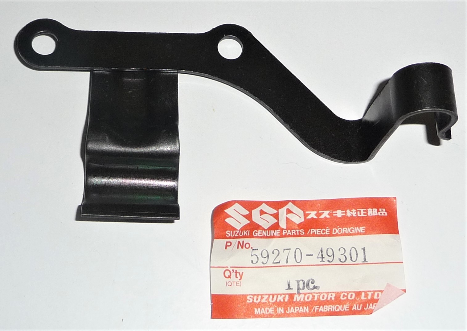

Jonty,
I have those brackets, but I can't find your post that asked for them!
Here's some photo's:
