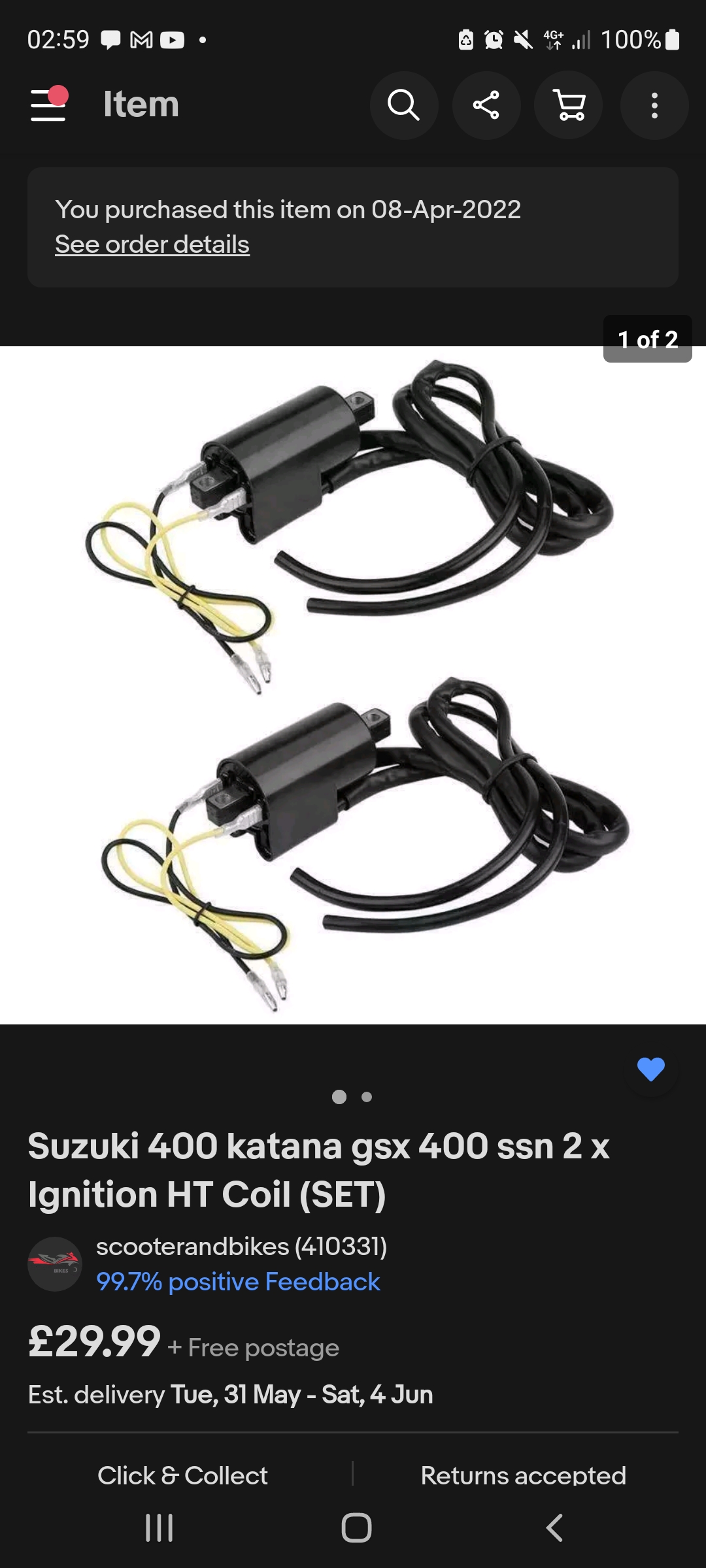

BTW, where did you get the coils from and how much?
Have you figured out the root cause?

These have definitely helped not got to the route cause yet haven't had the time , would defo like to attempt to get a choke cable together for it?

At that price, I am going to get some, just to rule one more thing out. I presume all mounting holes line up and the wires are correct?

The mounts on the coils line up fine however I found on the righthand coil I had to use slightly longer bolts and build up the washers but no big deal really.....the leads were spot on ... they made a big difference to the bike .....very reasonable priced......
