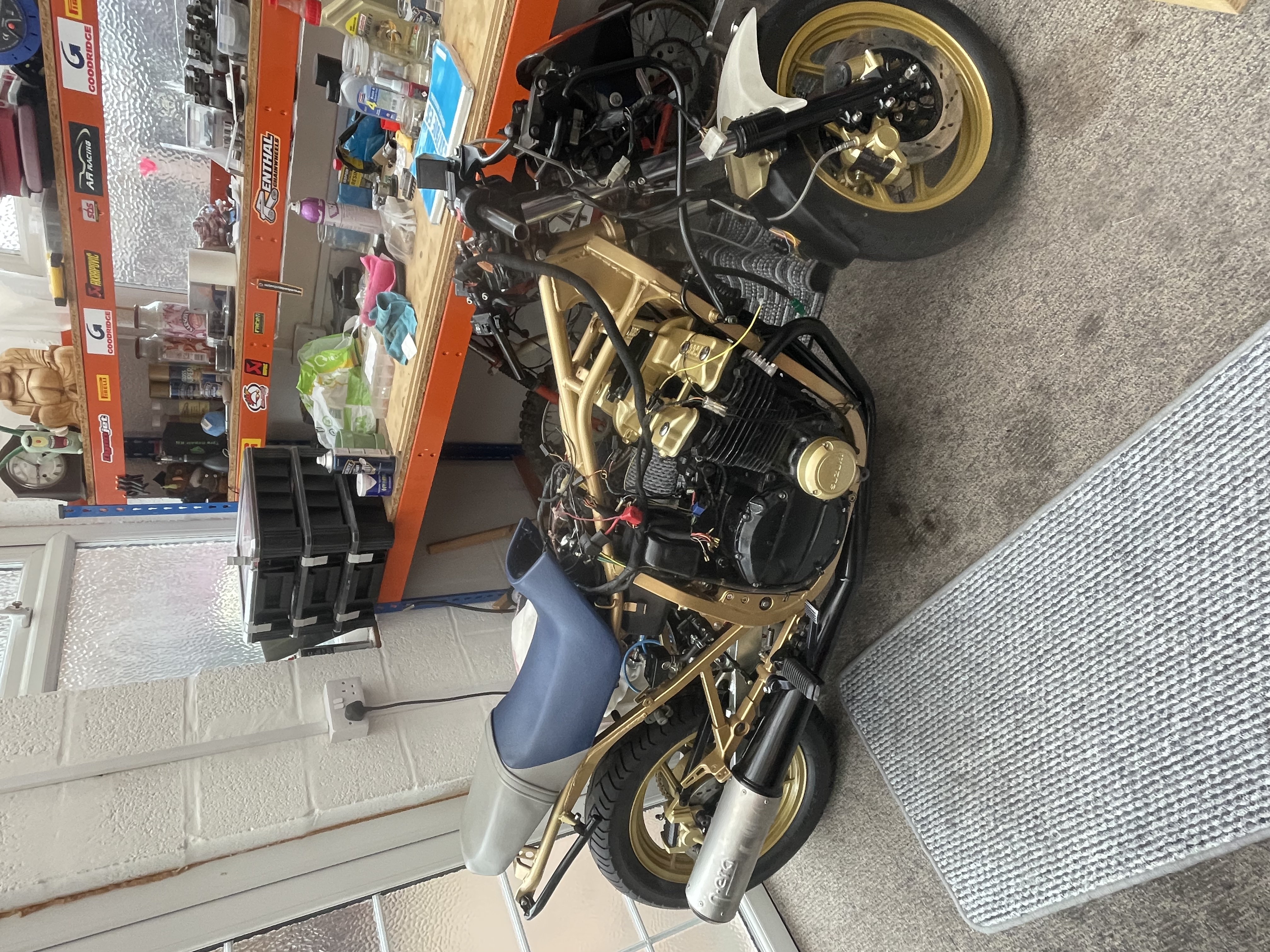

I bought a basket case pop up and the plate I have don’t look right. I also have two different rectifiers.
She’s slowly coming together.

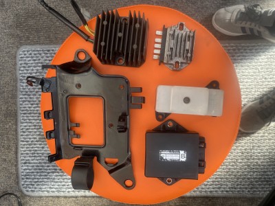

Thanks fossie for the reply. Here are the parts.
I’ve looked on the micro fiche on Fowlers website for the electrical mounting plate and it doesn’t like the one I have.
Thé smaller of the two rectifiers fits the connecter on the loom so I know that’s the original.

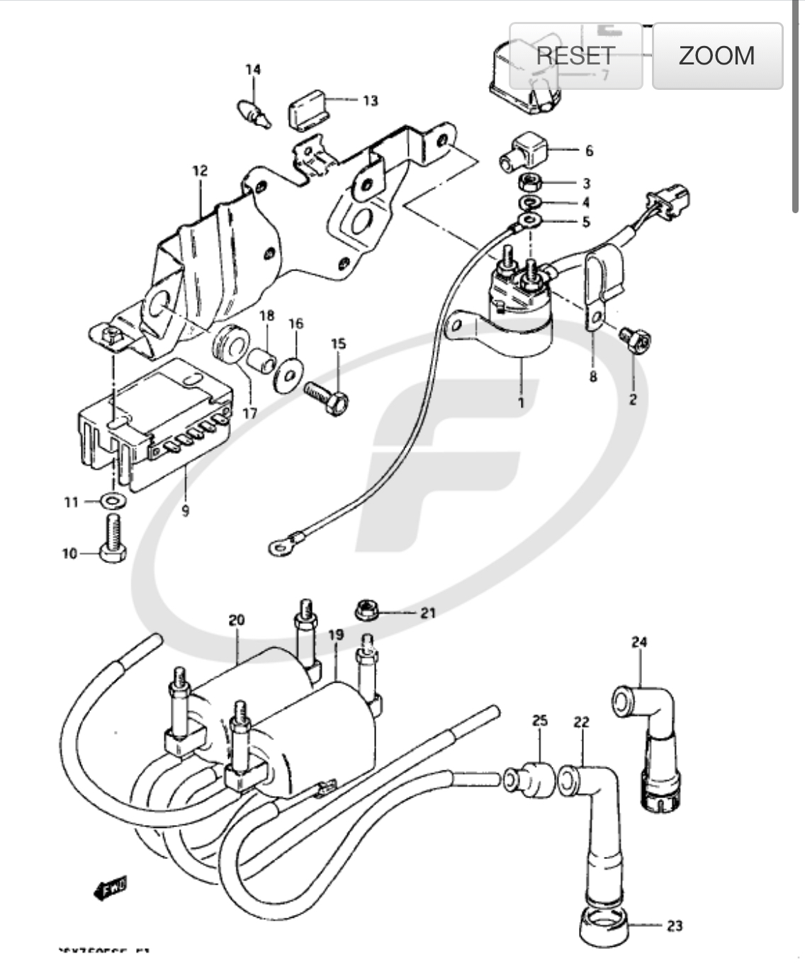

I guess this is what I need and the igniter fits on here too?

The larger reg/rec is that from an earlier 80's bike , if it's 5 wires is a Suzuki ...possibly a Kat...if 6 wires it's a *onda .
The plate is from a non pop up katana , yes the one you need is as in the parts diagram.
As said it's easier to source one from a Suzuki GSX 750 ES ,they are the same as is the cdi , fuse box and reg/ rec ...so if you found one complete , job done! :(
