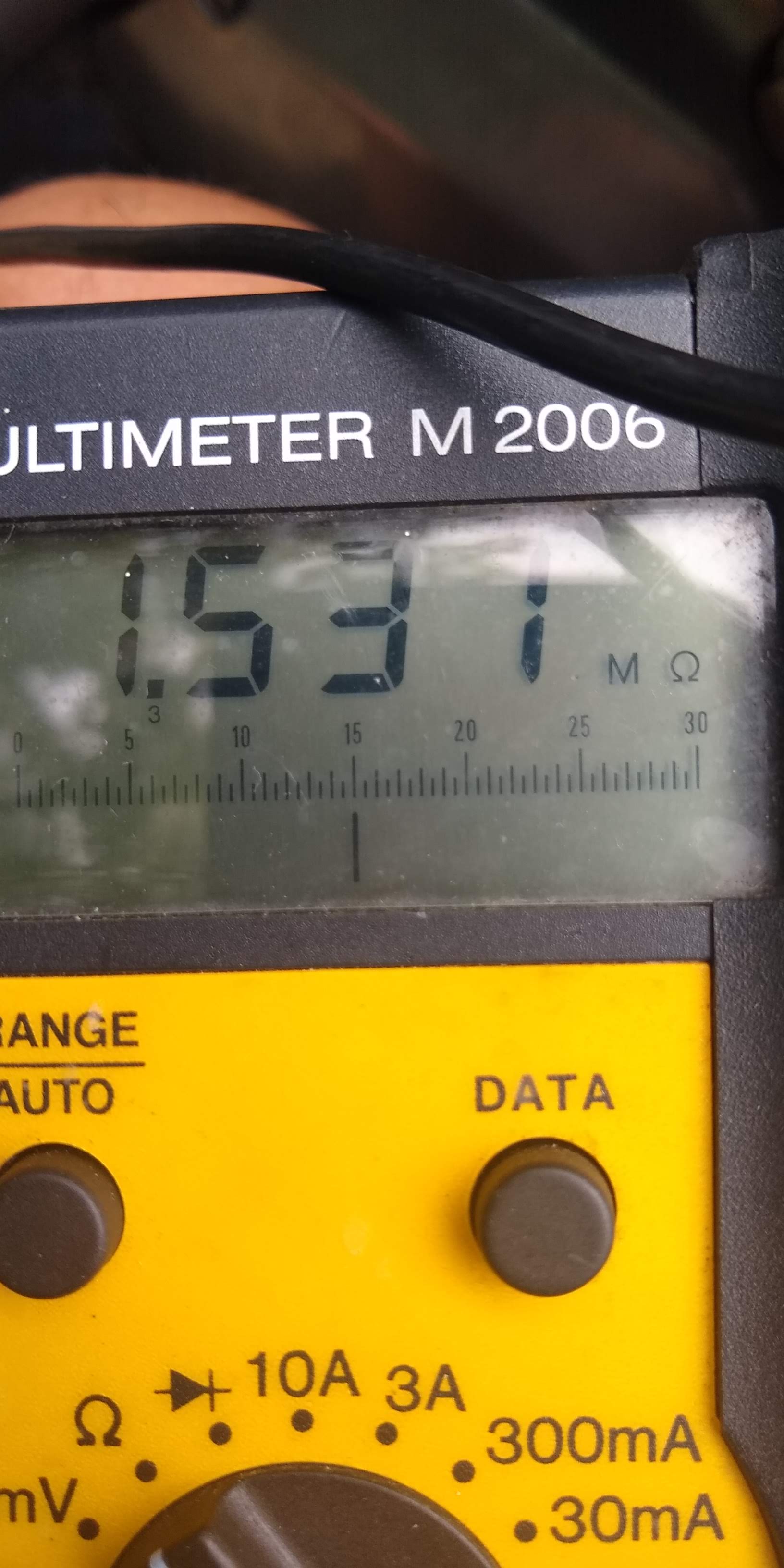

So on to the phase to ground insulation checks..
First test
2nd. Well that’s a bit Meh!
3rd phase was unstable and all over the place! So that’s the alternator fried. Didn’t bother doing phase output voltage checks :lol:

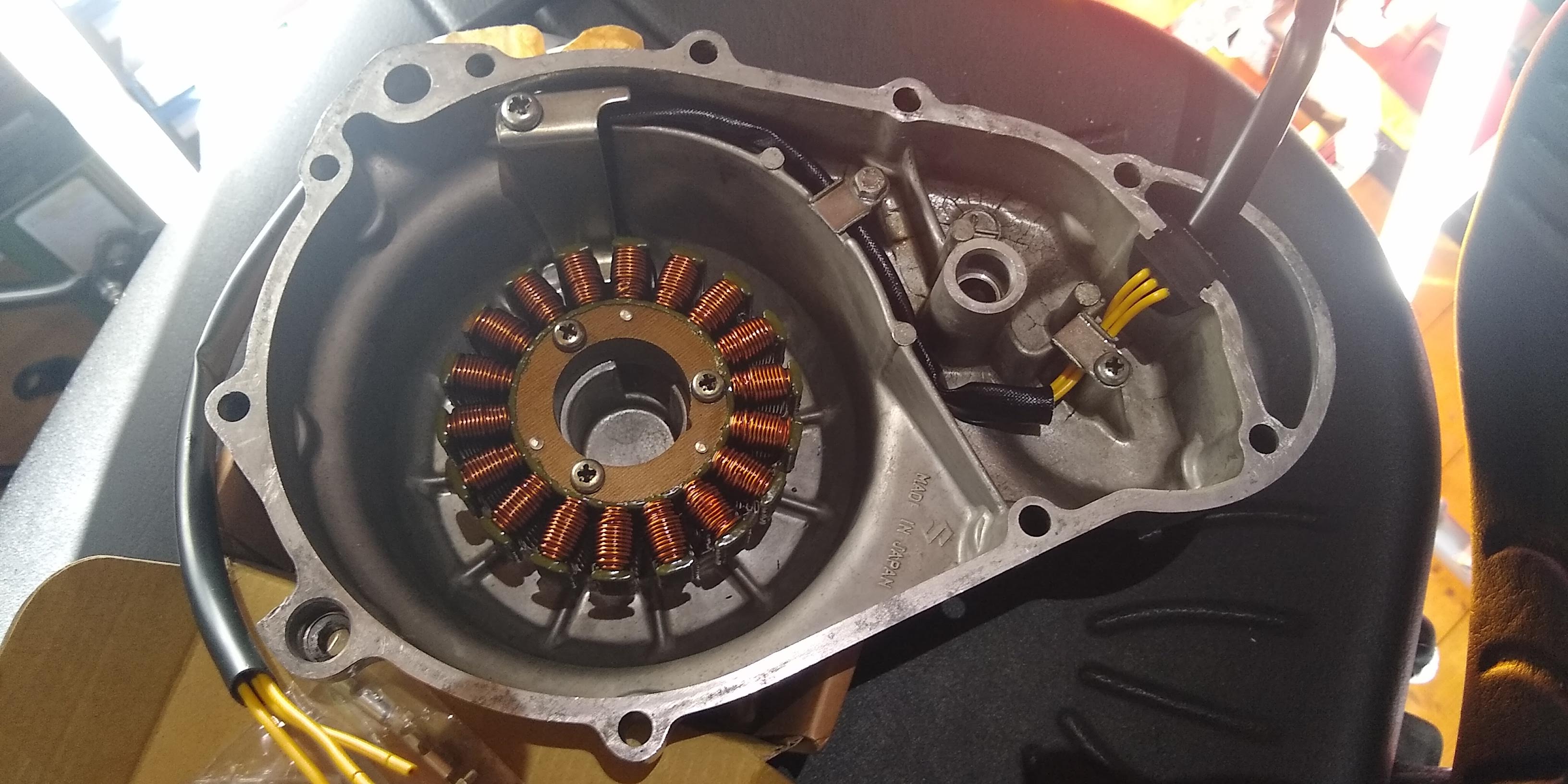

The genny cover come off to reveal a truly blackened alternator!
The alternator and the cable retainers need to come off, aided by the percussion screwdriver!
Clean up the cover gasket faces and all the grubbiness on the outside.
The rubber grommet that the alternator leads pass out of the hot oily bit into the hot non-oily bit needs to be reused as you don’t get one on the new alternator. After a little bit of work you get this…

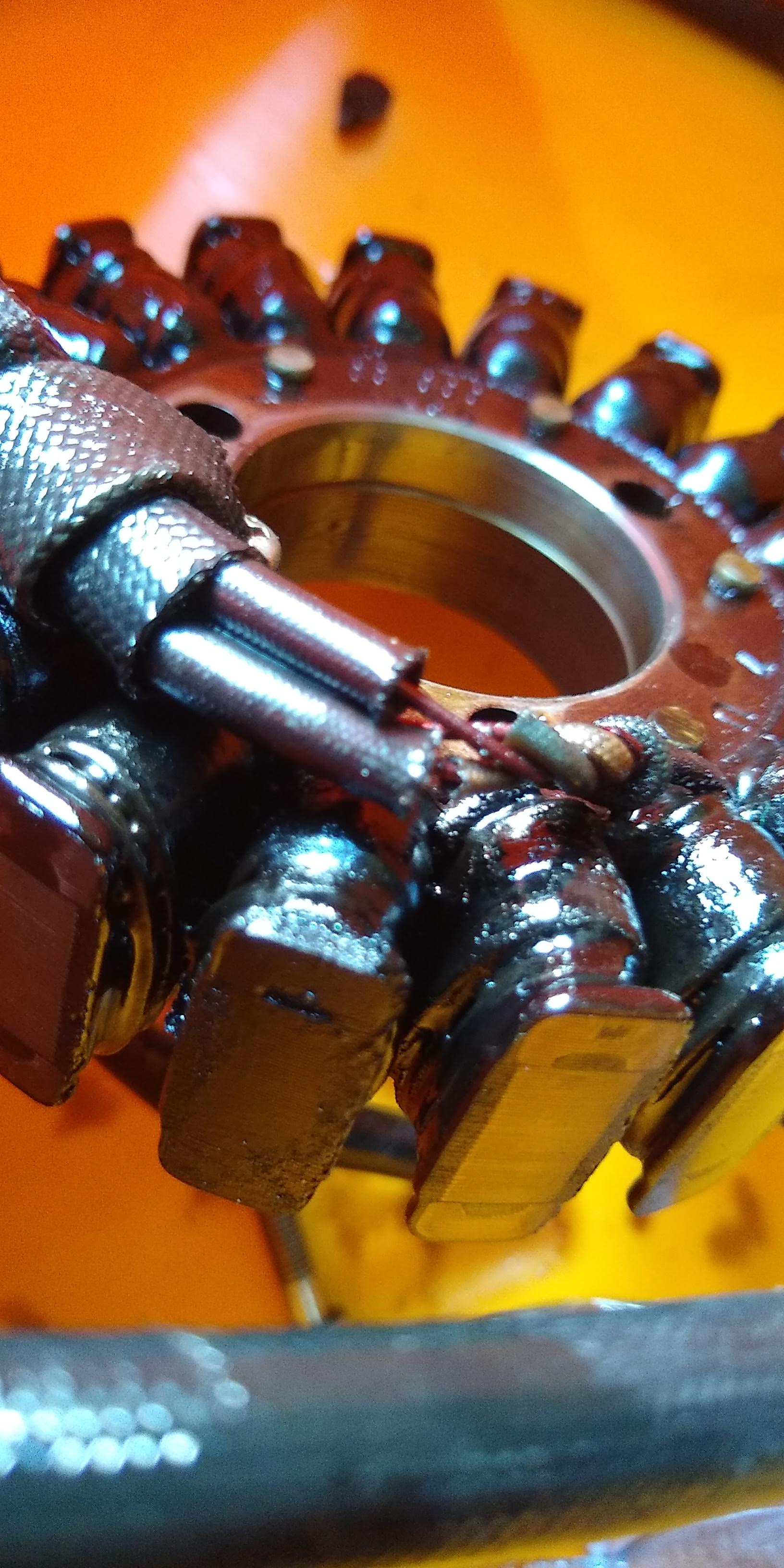

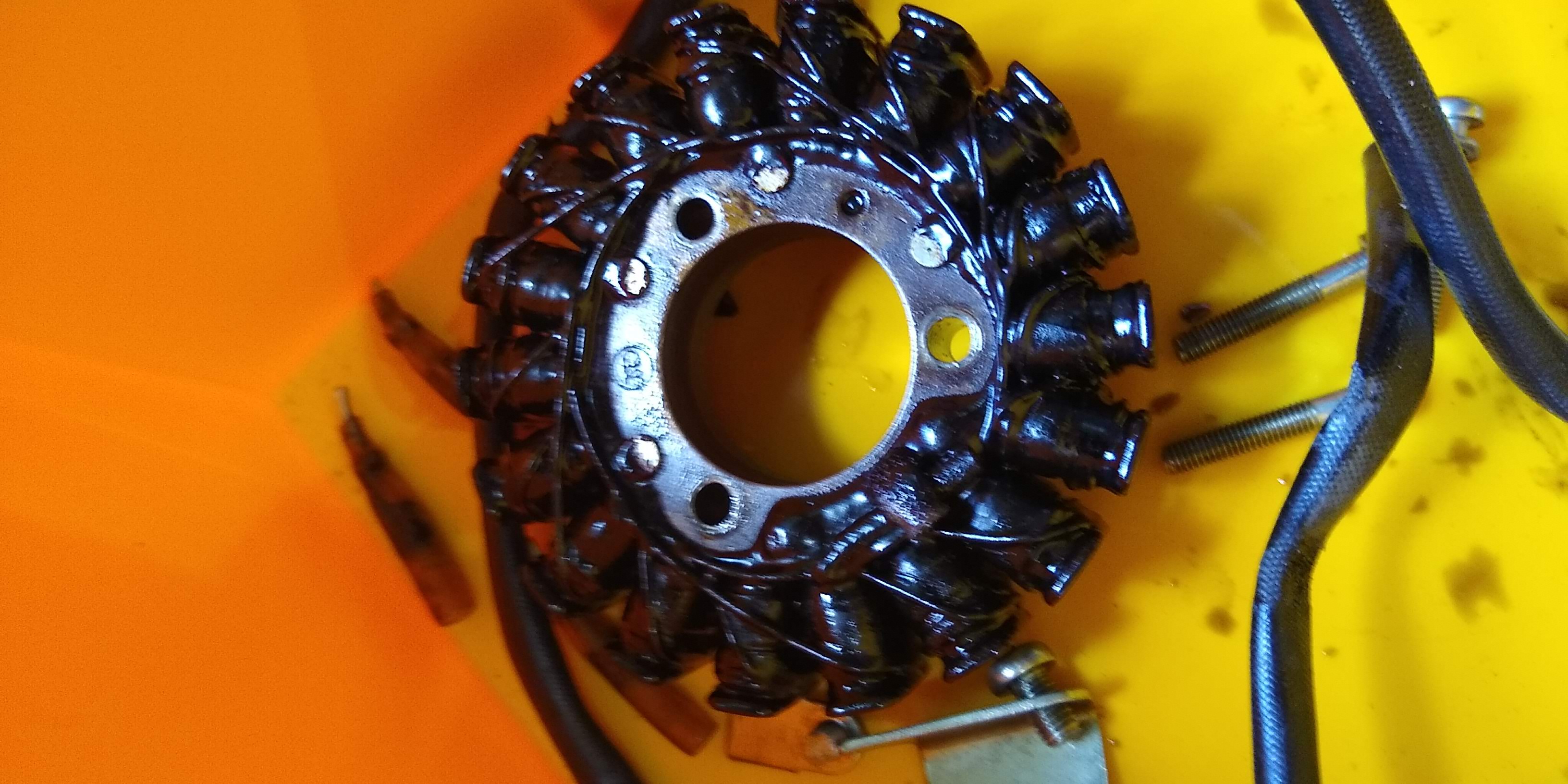

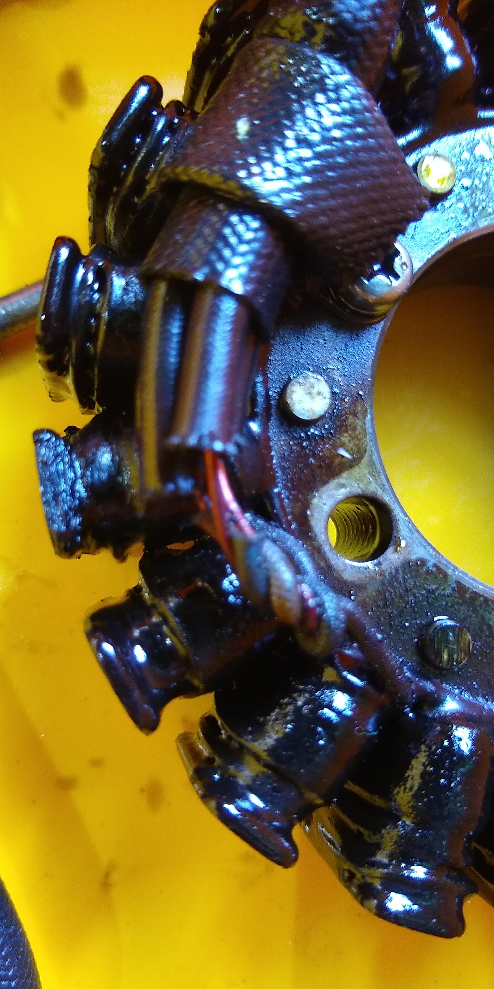

Just for info. This is what the old alternator looked like…
Don’t think there’s many volts left in that!

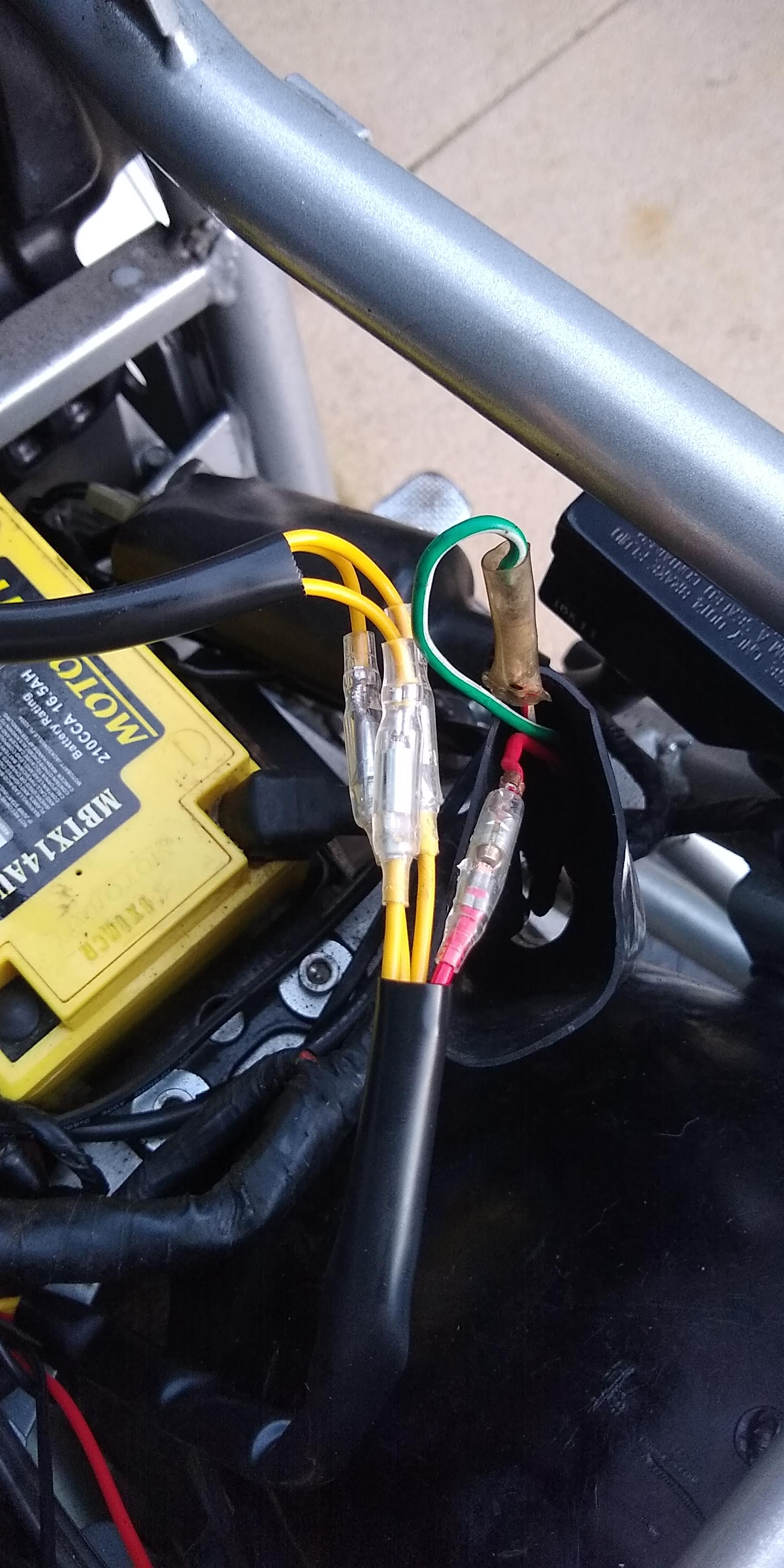

The reg/rec fitted easily enough with a bit of jiggling of the fuse holder. The new item has more fins and is just a little bit bigger than the Suzuki original.
Nice new bullet connectors made up with a smear of dielectric grease.
All three phases wired direct to the reg/rec, easy as it’s 3 times yellow to yellow.
White-red to Green-white is the original switched phase to/from the lighting switch.

Post by johnr » Mon Oct 04, 2021 6:24 pm
did you check te link from one alternator phase to the headlight switch? terrible idea, all three phase output of the alternator should go into the three inputs of the reg rec diirectly, remove the loop that goes to the headlight, well, disconnect it and leave the wires in situ. the link through the headlight switch was a terrible suzuki idea thats long since been proven to be bobbins.
