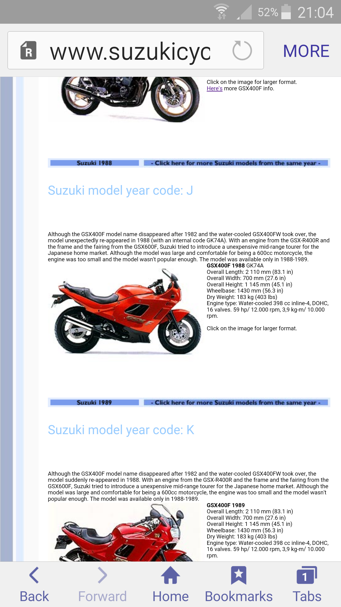

Cheers for the reply guys and sorry for the late reply. Been in the garage trying to get it fired up (carbs not pulling fuel into the head) Yeah noticed that if a use the gsx400f whem searching al get the earlier 80s bikes. Yes mines is the fully faired one the gsx600f frame with the gsxr400 engine from what av read online about it. Any manual av tried to find for it has been in japenese too lol. Its thisbone in the pic Ibhave

Give it trying with the carbs , it is pointless unless you get them ultrasonic cleaned. The old petrol will be varnish now and all the jets gummed up.
