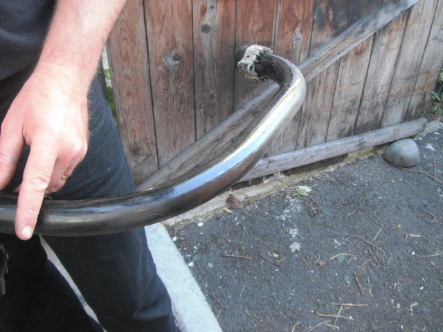

Piece added to show what is involved in fitting Marving silencers.
Take the original suzuki downpipe silencer
Cut the downpipe about here
take the centre pipes and cut off collector
