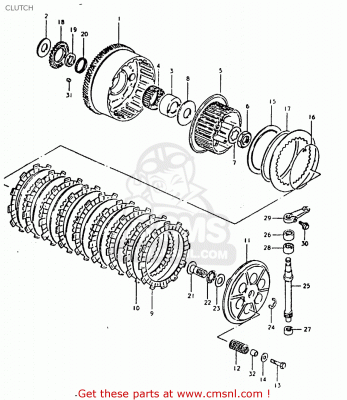

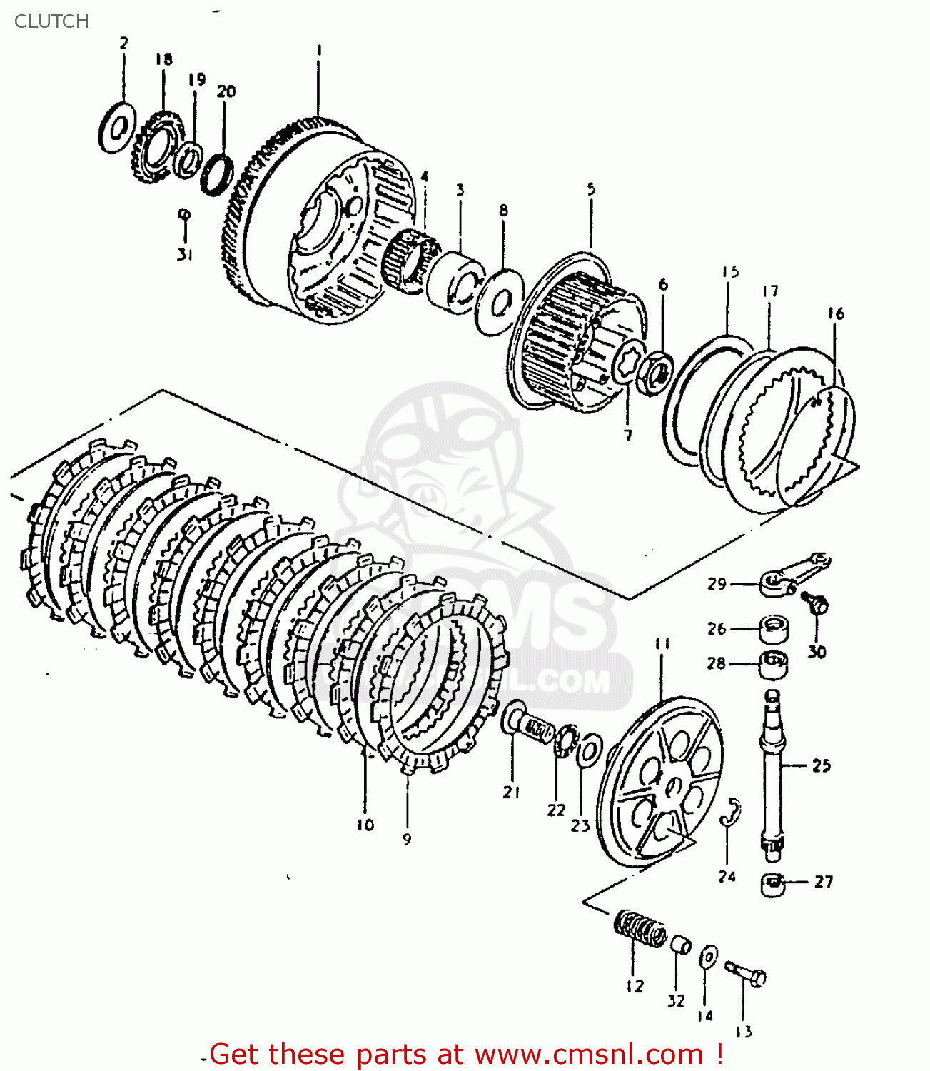

As you asked in your email here is how I reset the clutch arm.
From the picture above
Item #21 Clutch, Rack Release
#25 Pinion, Clutch Release
#29 Arm, Clutch Release
#25 will rotate freely in the clutch cover
#21 will also rotate in the clutch centre and will only allow the clutch cover to be refitted when lined up correctly to engage with the gear teeth on #25
Re-fit the clutch cover but do not worry where #29 arm ends up
When you have the cover secured remove the arm, turn the Pinion to take up the free play in the gear. (Re-reading my previous post I think I told you a fib!) As you look at the splined end of the Pinion turn it Clock Wise* to take up the play.
Then re-fit the clutch arm on the splined end of the pinion and adjust the cable so that they are about 90 degrees to each other. The photo of the clutch arm with the verniers shows where it needs to be.
If you set the clutch cable up with 2-5 mm free play #21 will not be loading the radial needle bearing in use.
If you set it up like this and you can pull the clutch lever all the way back to the bar/grip then you should get enough movement to release the clutch pack.

What I have noticed on the back of the driven gear there are two notches that fit into the oil pump gear. There are also two grooves at 90 degrees to these nitches and looking at the diagram there should be two rubber damping plugs (31 on diagram). I do not nave these plugs. I have been trying all day to get an image of these plugs for reference. Could this be the problem?
Has to be something that was done before I got the bike, so anything I have done so far is not the issue?
I will try your suggestion tomorrow, to be honest, I got nothing else I can think of!
