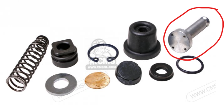

Friend got NOS one (last one!) from Suzuki Performance Spares in end with slightly different part number (earlier probably) of 59600-49810
The parts look like this:
The ones linked to all look to be different (esp. the metal push rod thingy), possible a later bike so I don't think they will work, which also goes for the 1100 / 1000 / 750 / 650 Katana's.
As an idea for the (1100 / 1000 / 750) Katana (if you need to get one repaired) someone on the FB Gropup fitted a whole master cylinder from a GSXR-1100K (if you can find one!)

Hmmmm.Uncle Bob wrote: ↑Wed Jan 29, 2025 9:41 amFriend got NOS one (last one!) from Suzuki Performance Spares in end with slightly different part number (earlier probably) of 59600-49810
Thanks
It was a while ago but, I think I got one of those for Skruffy Kat. And to be honest it was that kit that lead me to Past Parts to refurb my master cylinder.
If the metal parts of the innards are serviceable then the seals may fit. It would be worth seeing some photos of the bits coming out of the master cylinder compared to the bits in the new kit.
Like the member on the FB Gropup, I am fitting a master cylinder from an early slabby, as the only one I had from a Kat had clearly been “Tarmac Surfing”
