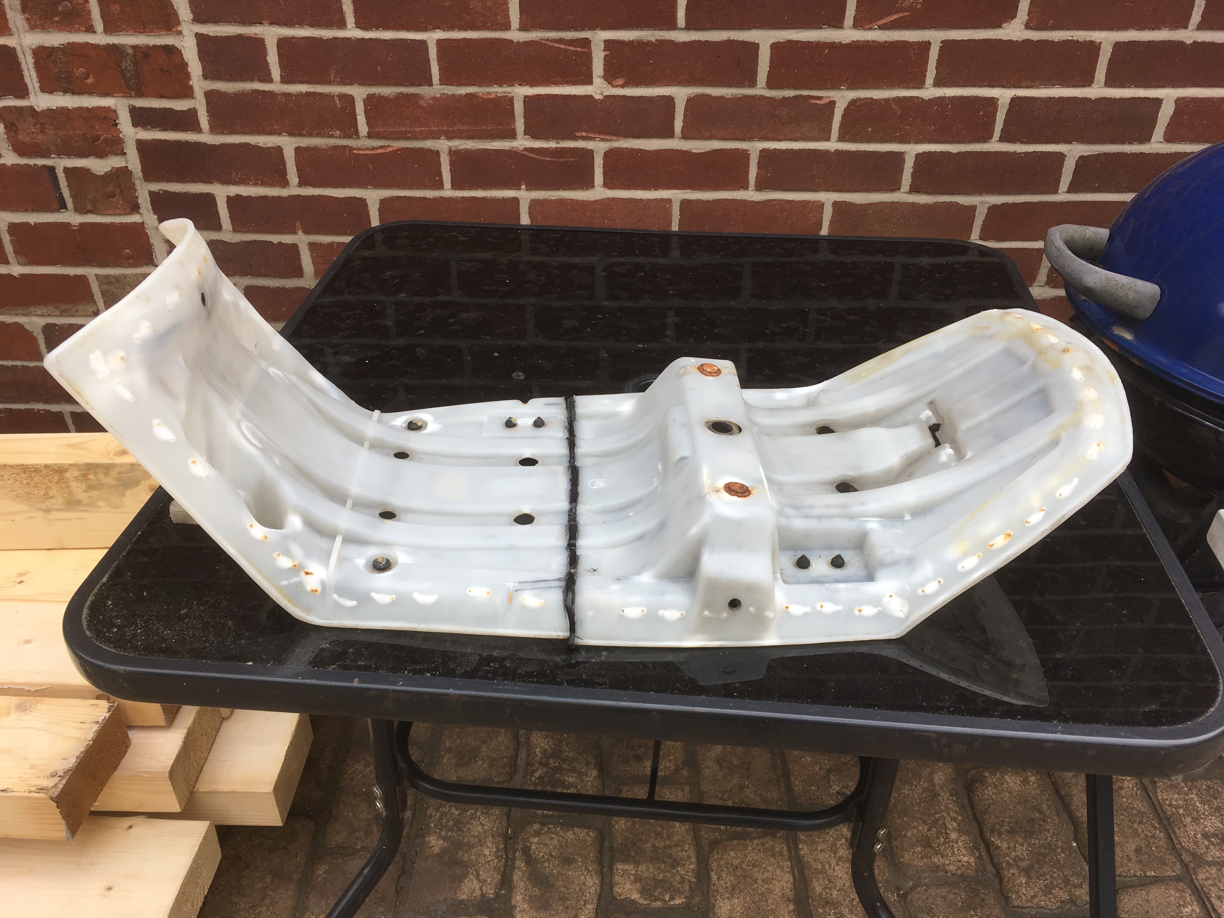

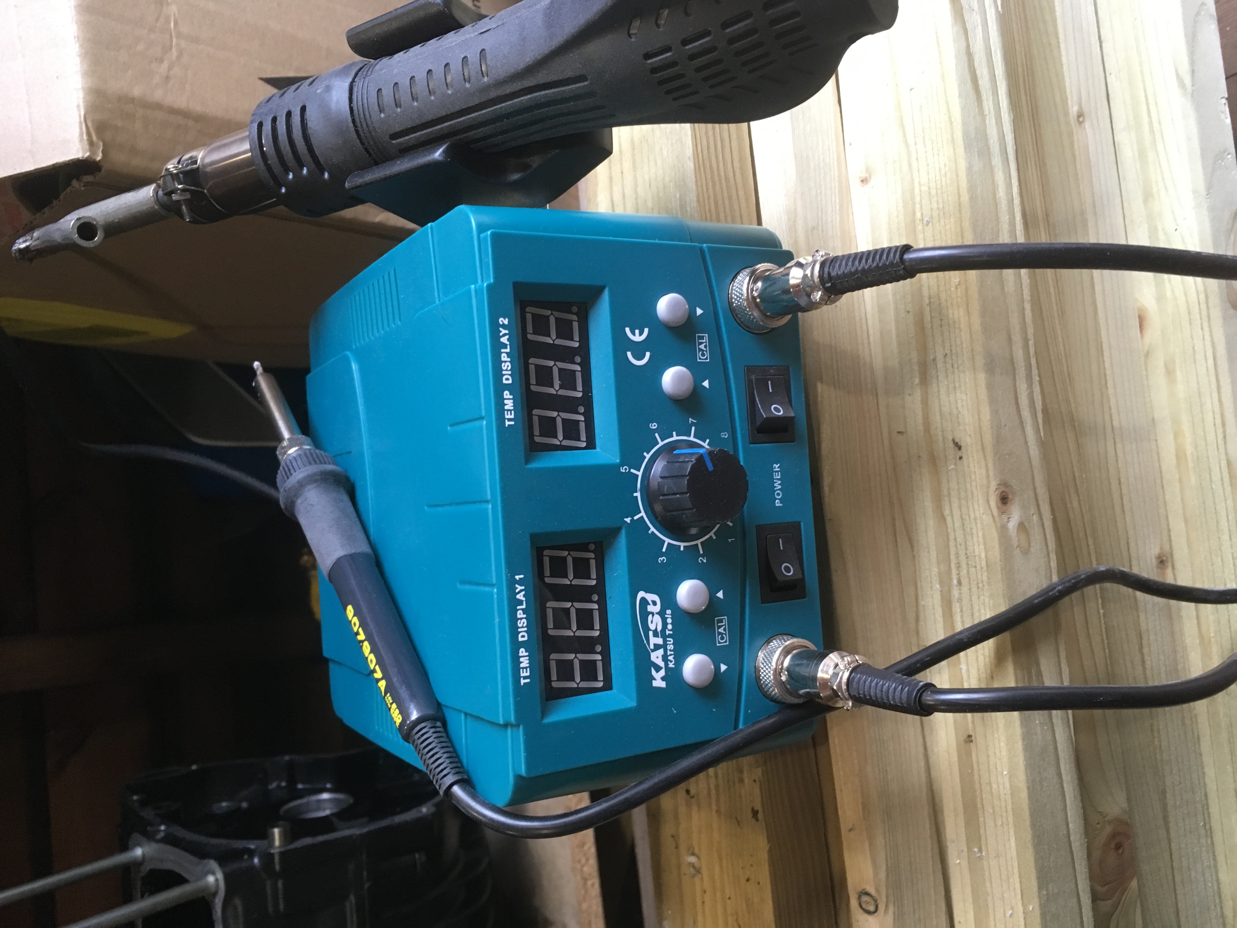

Post by Rustynail » Sat Sep 14, 2019 1:23 pm
If you identify what plastic the panel is and buy some plastic welding rods of the same type you can get some good results with the welder in the photo. This is a seat base I welded
