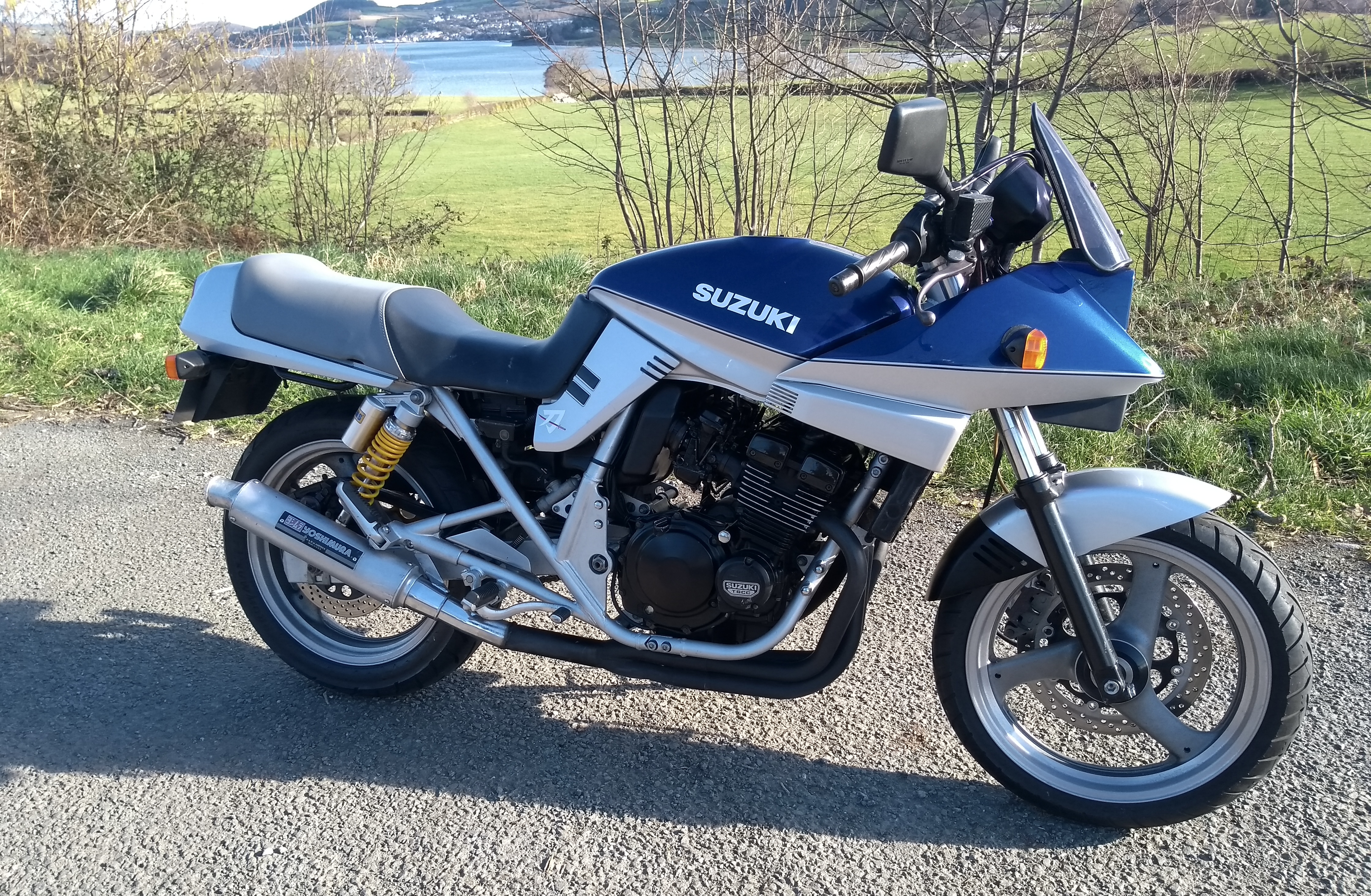

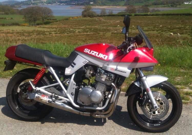

Hi, I have a 400 as well, not any problems when I was running it until the Cdi unit failed and I put it off the road. That was a few years ago, getting it fixed up now, replaced the Cdi twice
. You will enjoy it when you finish sorting it out. Here’s my 400 along with my 250, pictures around 12 years apart, 250 one today.
