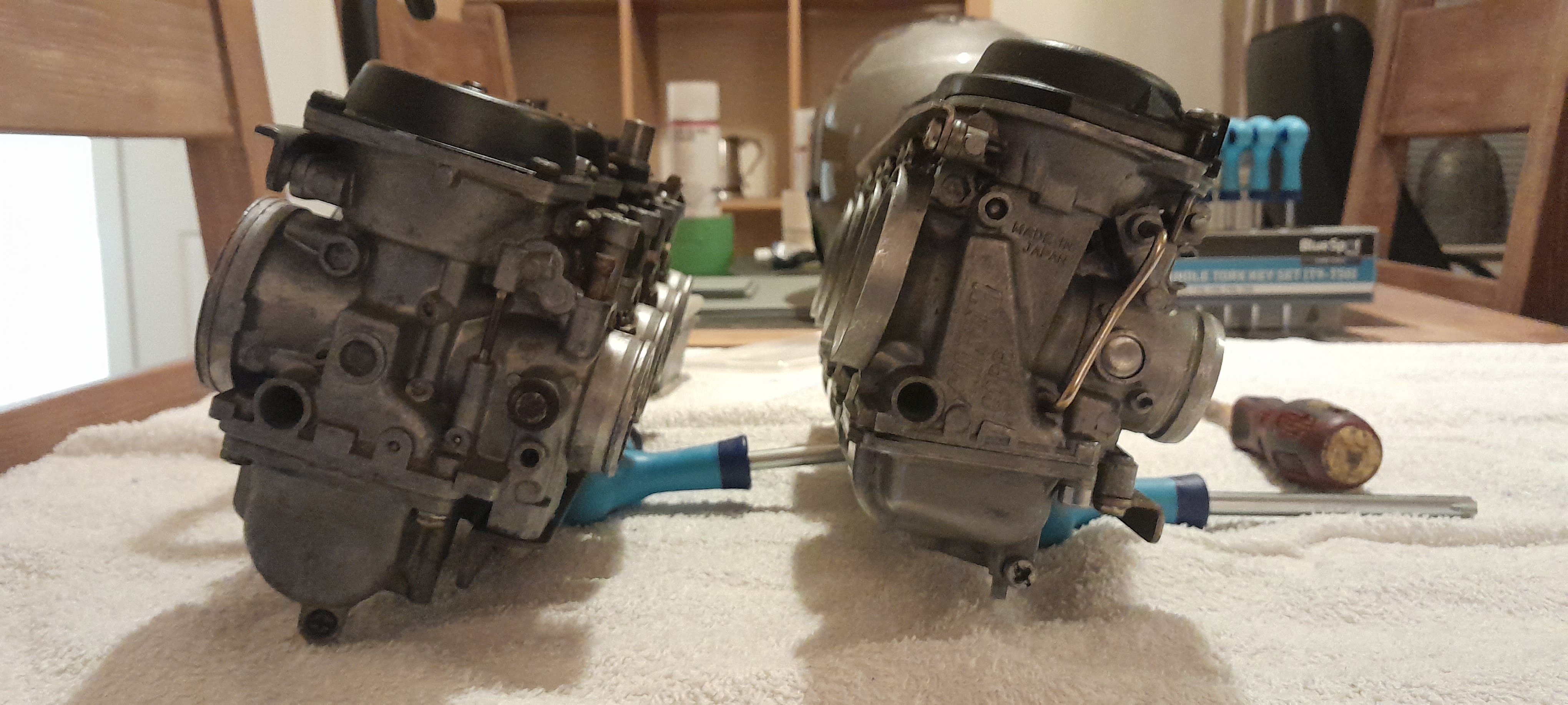

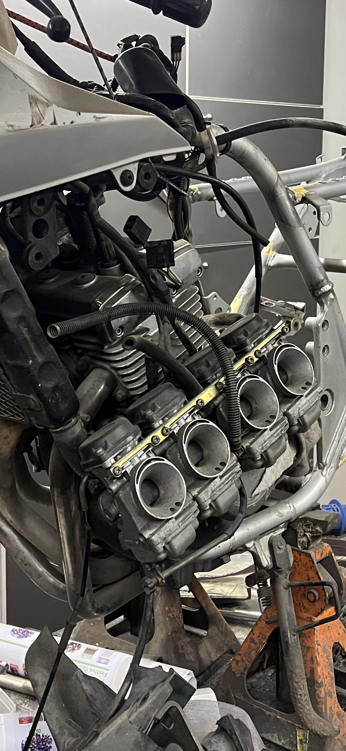

Pic 1 demonstrates the deep floatbowl on the BS and the short choke mixture path compared to the BDST So, on with the install. First find some GS550 CV carbs, from the late issue of the model. As these are aged carbs, all the usual checks must be made. Diaphrams, clear jets, no corrosion etc, Check also that the small rubber bungs covering the pilot jet housing are present and in good condition. They are available on E Bay if needed. You will also need to source #90 main jets, the pilots are fine. The slides in the BS are heavier brass items. I drilled out the air bleed hole to 6mm in the base and also shortened the return spring in the slide body to roughly two thirds its length. This to assist the vacuum actuation of the diaphram. The last step in the process is to swap the needles from the BDST's into the BS slides. As they come, the BS needles are a straight, minimum taper design. The Kats needles are heavily tapered. I found that the straight needles gave a yawning flat spot right at 4000 rpm, the transition from pilot to main jet. Although the Kat's needles are smaller in diameter, using these gives a nice transition through this rev range. After that, it is throttle opening and main jet that controls fuelling. I did move the needle clip down, (richer) by one notch and that is where I have left well alone.

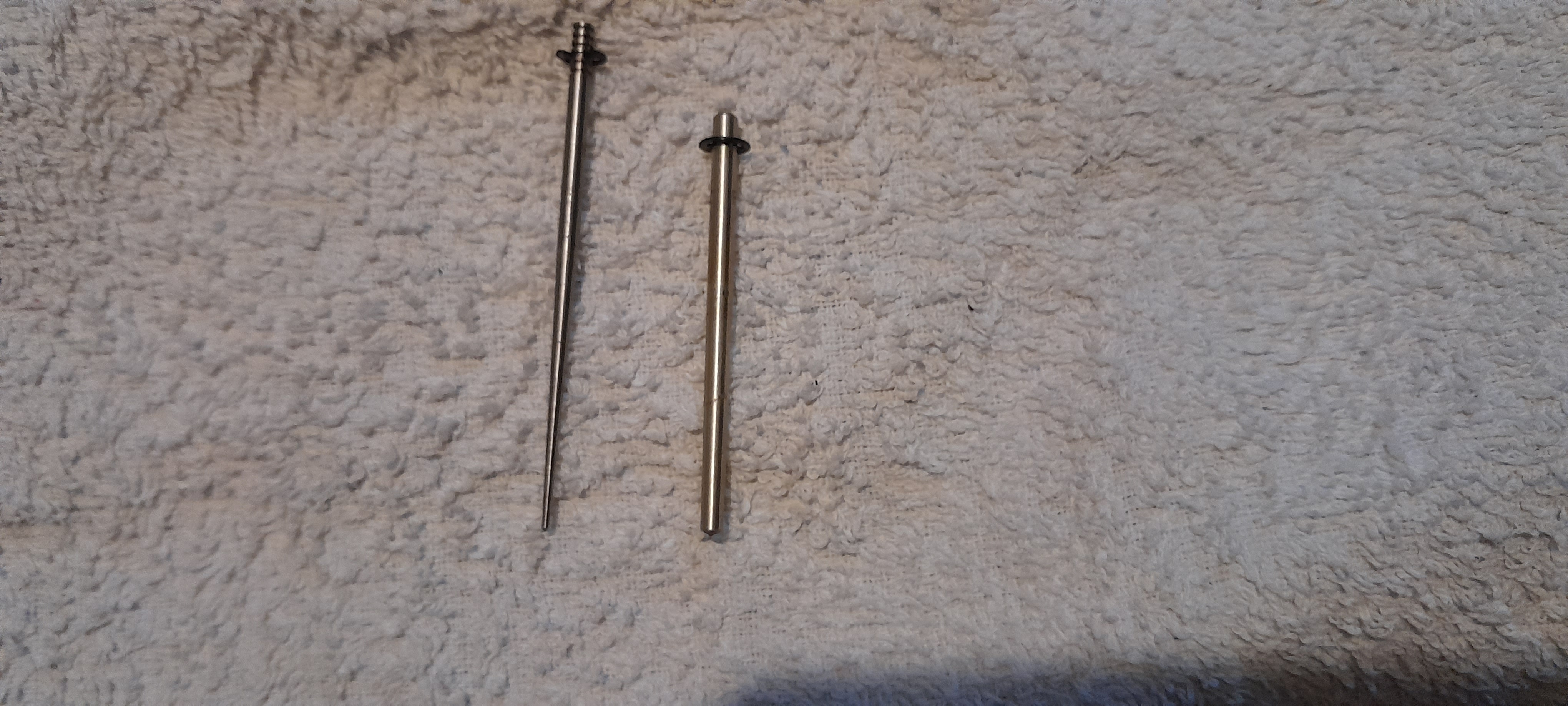

(tapered needle for demonstration, not from BDST but similar taper compared to straight needle from BS) Plug readings show a slightly rich mixture at 90 main jets, preferable to slightly lean with the stock 85 main jets, given the revs these things can reach.

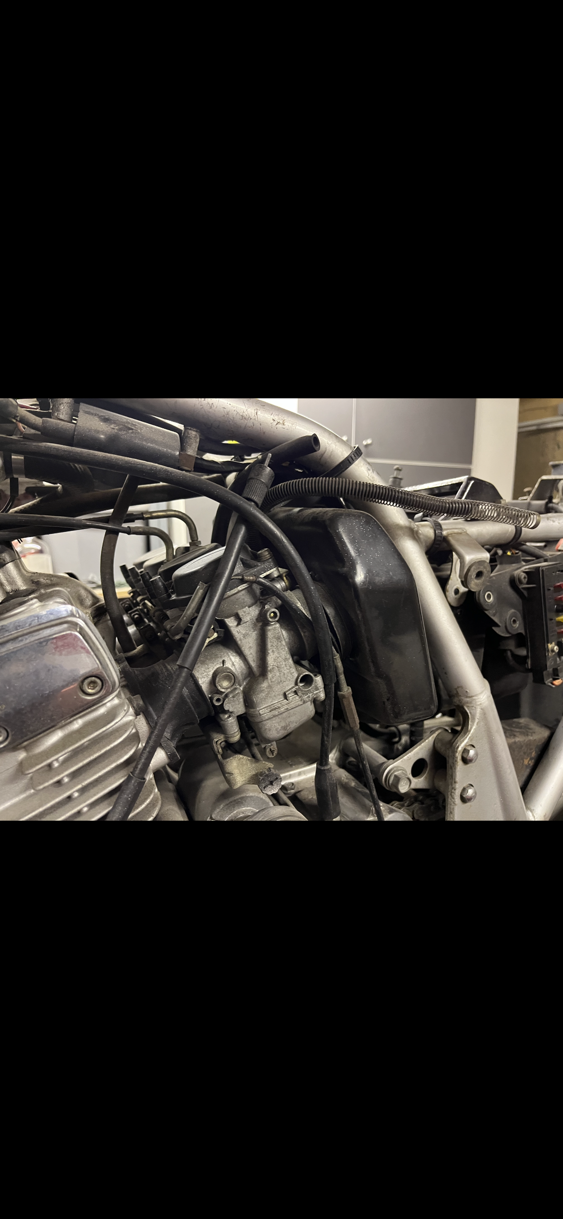

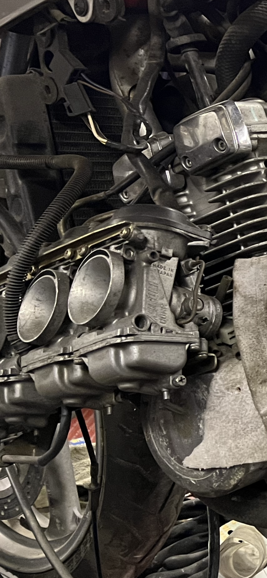

That’s good reading John, I’m just about to head forward from the back of the bike frame repair to the carbs next although mines the 250 not 400. I’m wondering if I should bypass a service kit and upgrade but what I can upgrade with considering mines a narrow engine?

Not sure what the carbs are on the 250, I do know its a different engine type, a photo of them might help.
