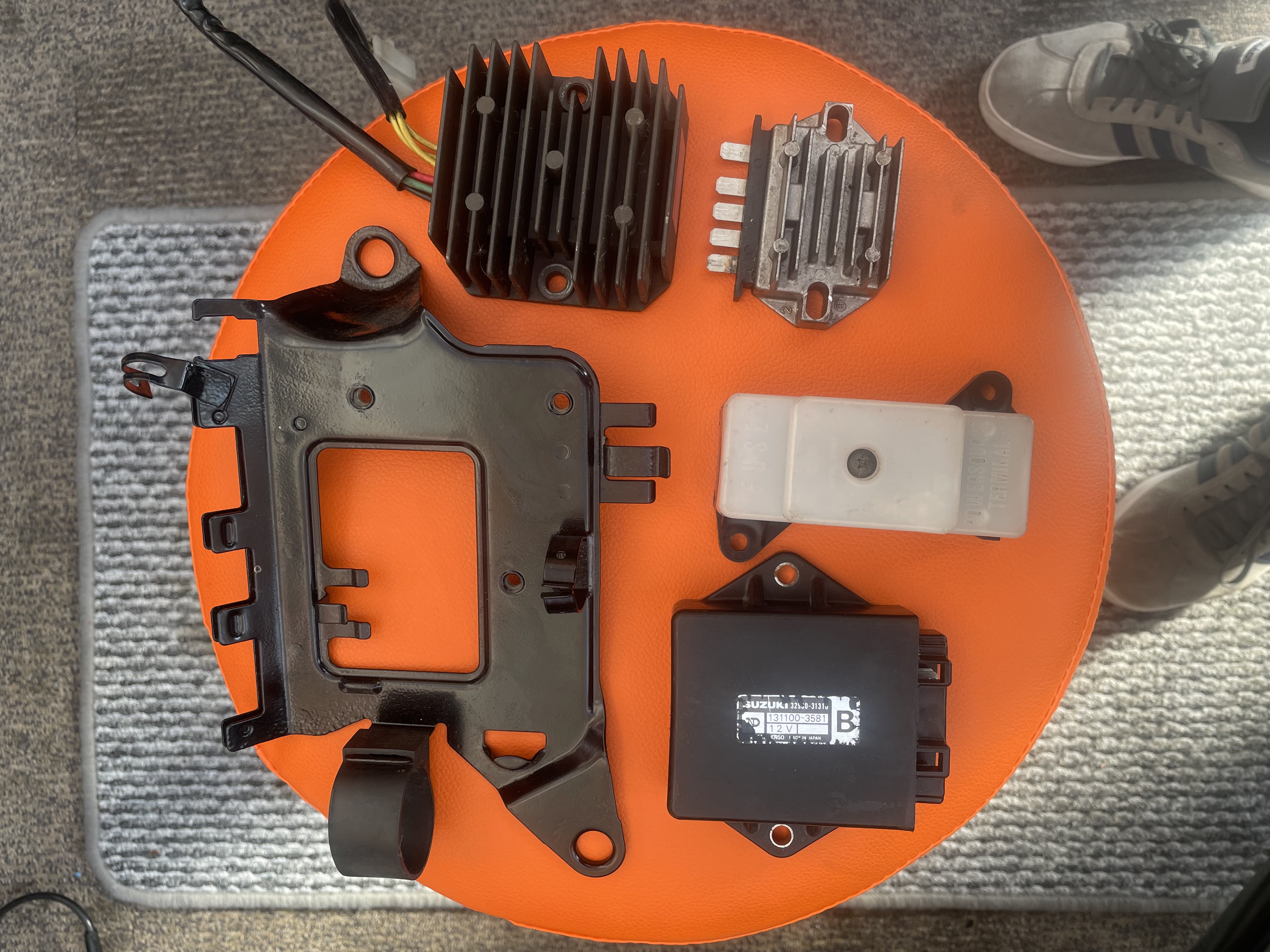

Hi can anyone confirm that 47411-08A00-000 part number is the correct mounting plate for the igniter and fuse box for my GSX750SE 1985
I bought a basket case pop up and the plate I have don’t look right. I also have two different rectifiers.

Best post a picture of the mount plates & rectifier so we can guide better.
0800A is a pop up part number ....
But the mount plate is th same as an ES ..
As for rectifiers , one is probably from a superdream ..a common upgrade/ bodge back in to day!

Thanks fossie for the reply. Here are the parts.

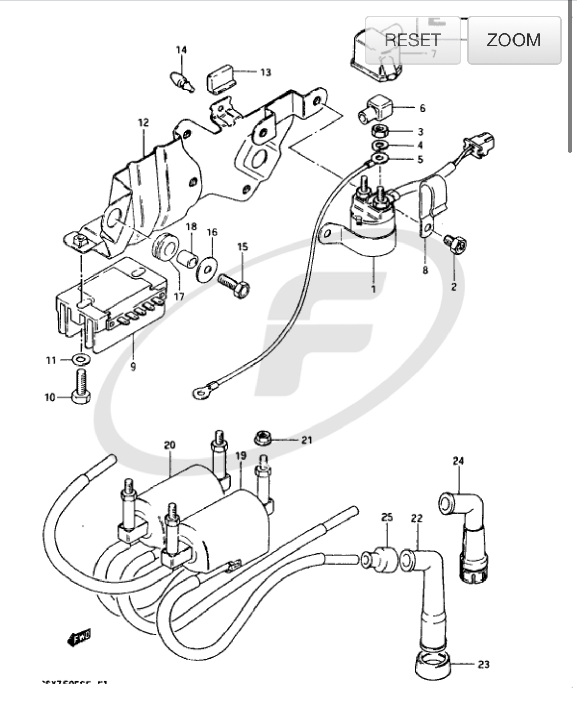

I’ve looked on the micro fiche on Fowlers website for the electrical mounting plate and it doesn’t like the one I have.
Thé smaller of the two rectifiers fits the connecter on the loom so I know that’s the original.

The larger reg/rec is that from an earlier 80's bike , if it's 5 wires is a Suzuki ...possibly a Kat...if 6 wires it's a *onda .
The plate is from a non pop up katana , yes the one you need is as in the parts diagram.
As said it's easier to source one from a Suzuki GSX 750 ES ,they are the same as is the cdi , fuse box and reg/ rec ...so if you found one complete , job done!
Like this unfortunately without the grubbins ...but they have them as well!
https://www.ebay.co.uk/itm/313191358750 ... SwlkBgQOxL
