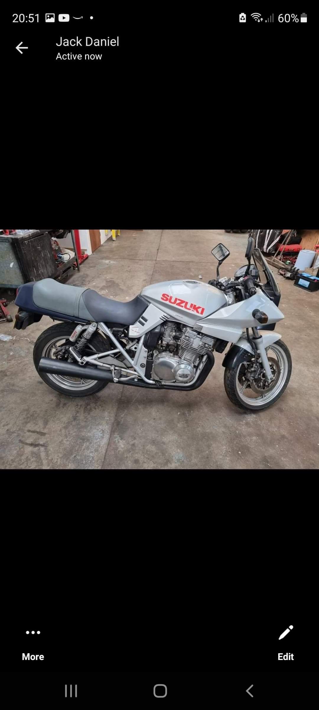

I received this picture today , just thought I'd share because it's easier to relate to the patient when you know them :roll:
It may just be the angle of the picture .....but you can see similarities between blix's old 400 and this one! :( :lol:

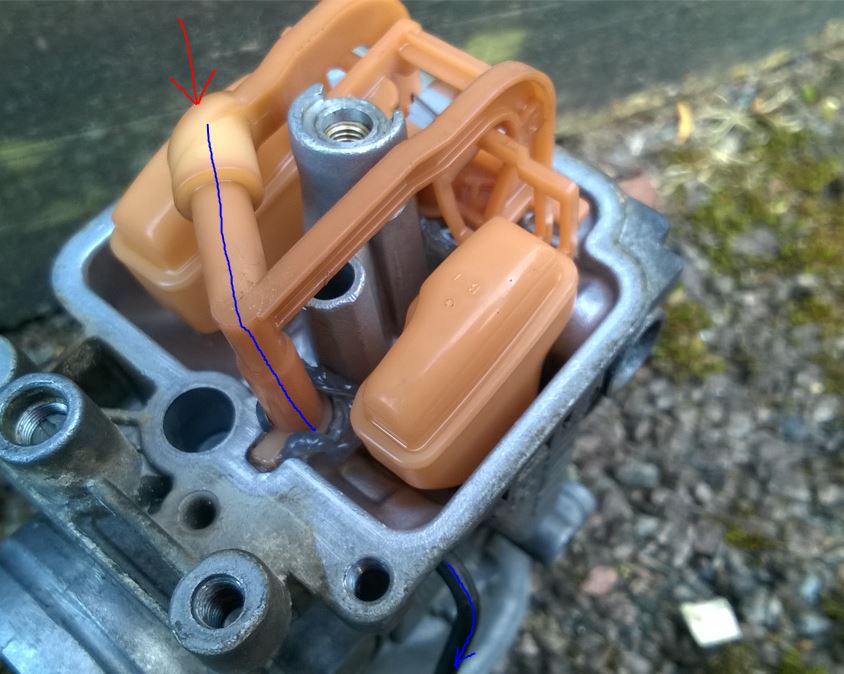

The prime circuit runs through the float and that needs to be checked to be clear right up to the plunger at the top. Bill didn't say if they were. I would take the float out and use brake cleaner (or carb cleaner) sprayed in the each end to make sure it comes out the other end (see image - red arrow is In. While the float is out spray brake cleaner into the carb where the float attaches and check it comes out of the plunger at the top of the carb. I had to do this with the 250 recently, all float orifices were blocked. Also although different design I just did the 1100 that has stood still June 2019 as all of those were blocked as well.

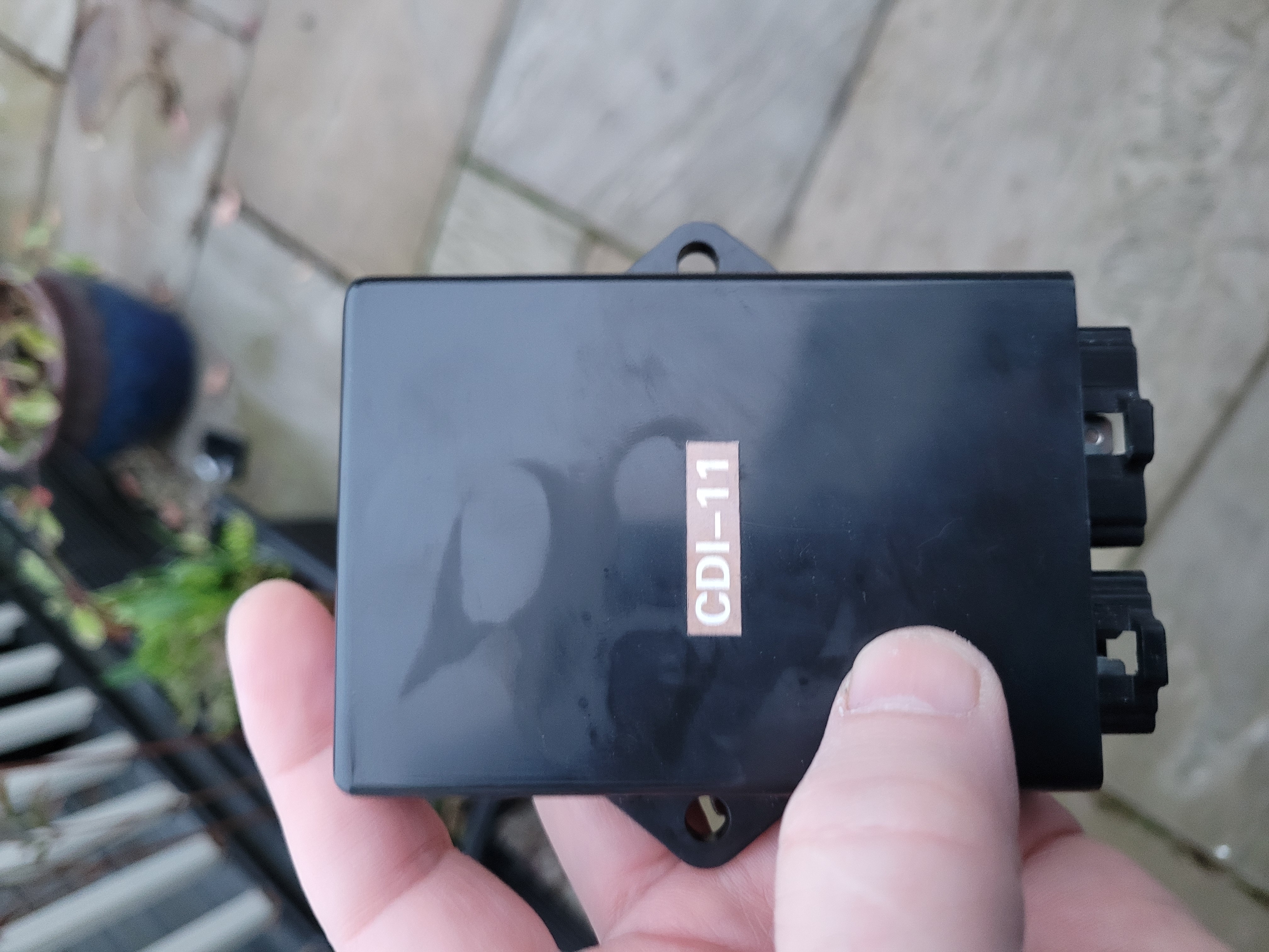

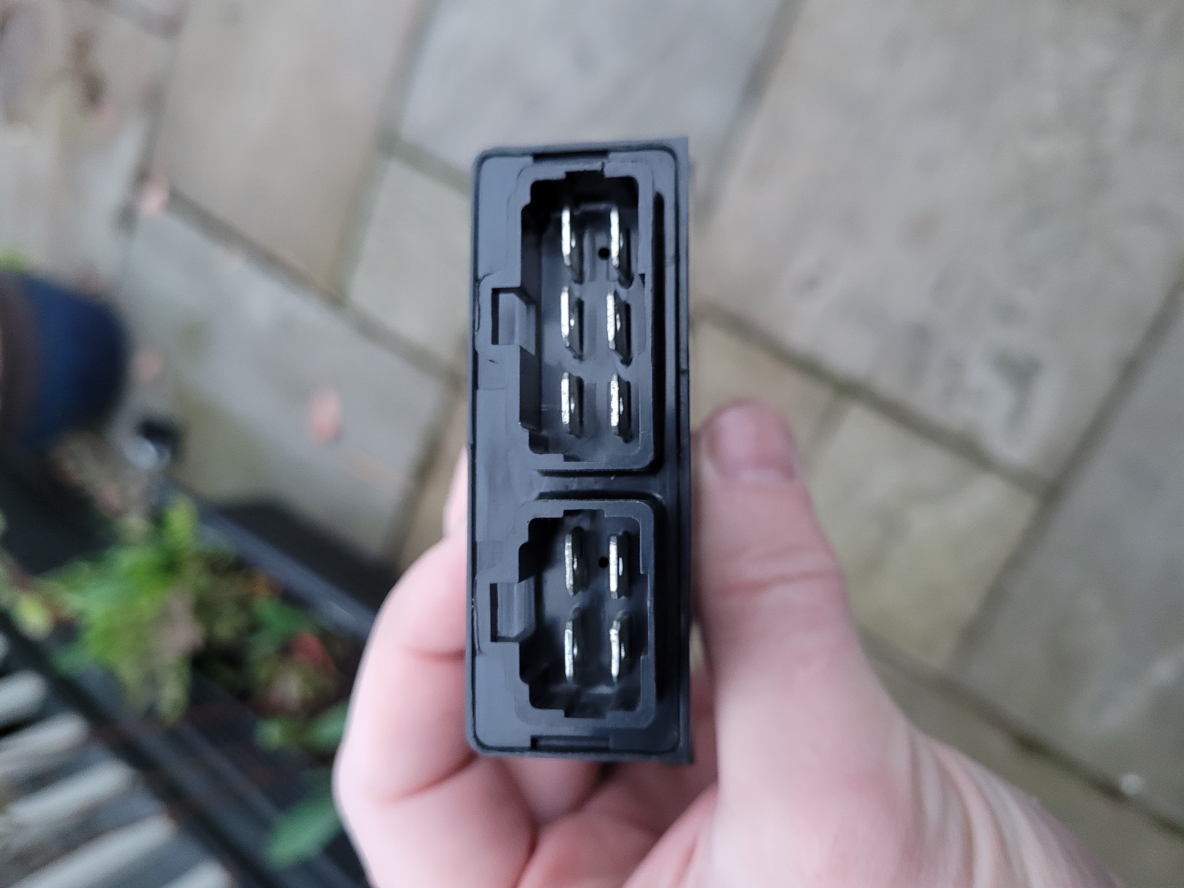

Would anybody have a photo of the original cdi they could share,I believe my current one is a aftermarket ?

This is my current suspect cdi ?
