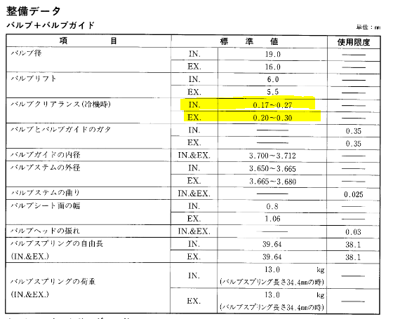

Hi. Does anybody know the valve clearances on the 250 kat? I'm working to the bandit specs at the moment and it seems like they check out but I just wanted to double check if anybody was in the know..
Intake: 0.17-0.27 mm
Exhaust: 0.20-0.30 mm
Is what I'm working with at the moment but let me know if they're different for the Kat.
Thanks.
Posts: 1748
Has thanked: 592 times
Been thanked: 227 times
Re: 250 Valve Clearances
Post by Uncle Bob » Fri May 25, 2018 4:38 pm
Missed this posting somewhere along the line. Yes they look to be the same as the values you state.
