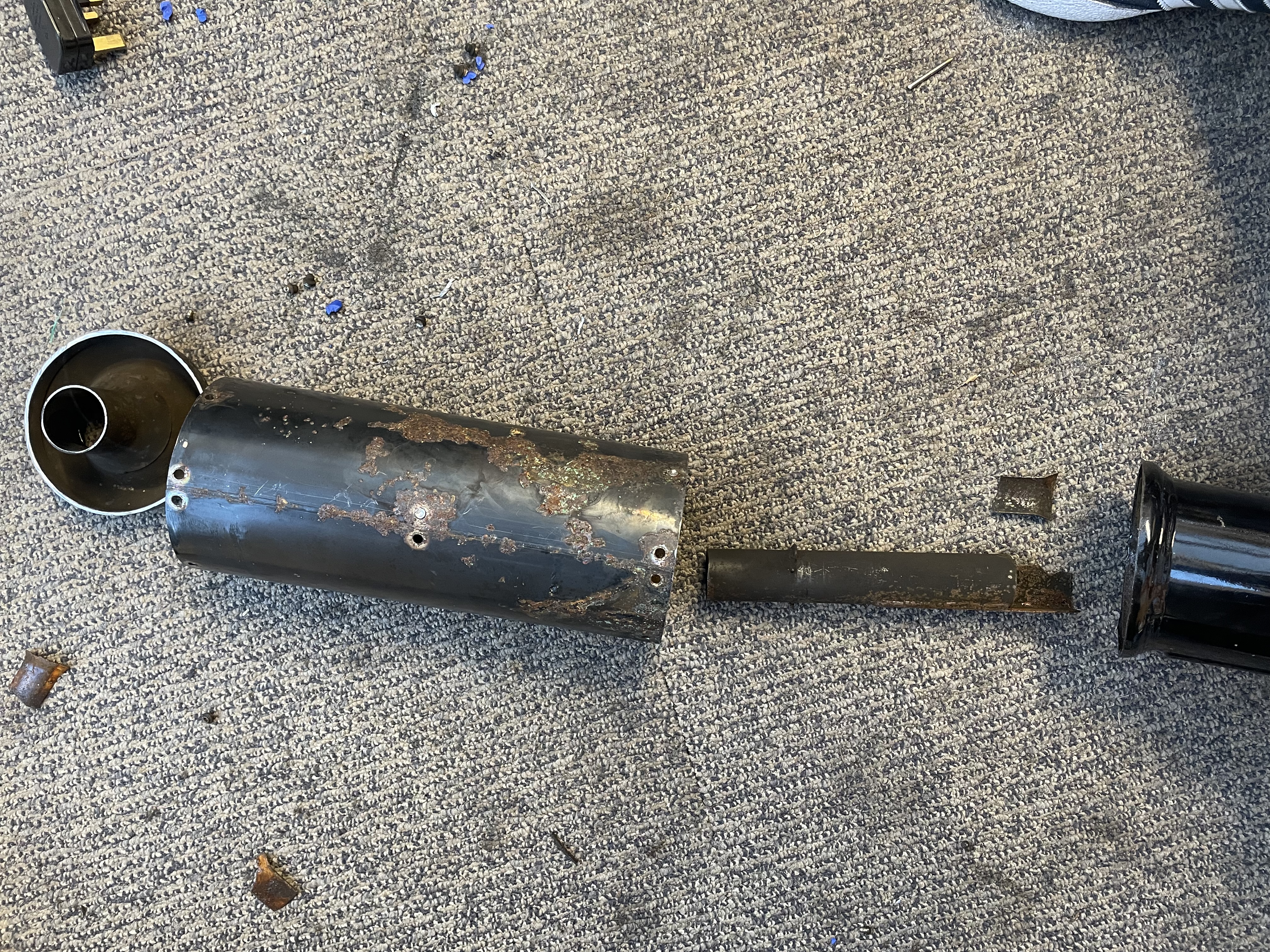

This is a how not to do it, so you can do it right. My Zorst looked in quite good Nick and after cutting it up it will definitely be around longer than me.
I had a rattle coming from the end can area presumably the baffle had rotted and come loose, this was the case.
Removing the rivets will not allow the end cap to be pulled out, it’s welded. Only the Ali Neta cover will come off.
Dont cut thé end off! the baffle is the other end it goes into the down pipe part.
as you look at the Ali cover (whilst on bike) you need to cut the right hand side this will expose the loose baffle. I shall now hand this mess to a mate who hopefully can salvage it. In the mean time searching for decent downpipes or getting some made.
