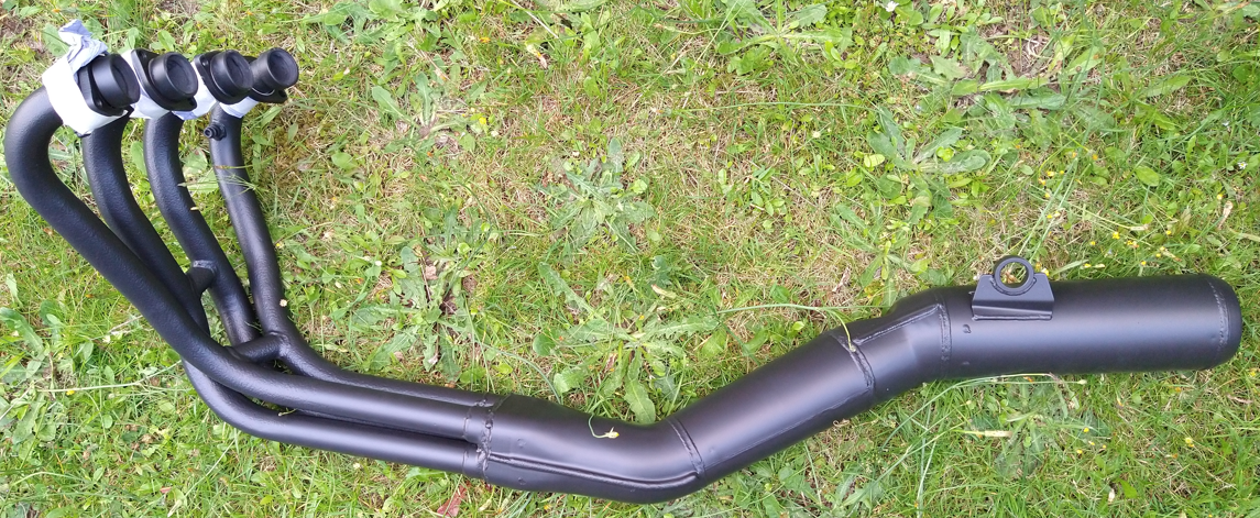

I've used Aerocoat in the past as well. Last time was for the PC50 frame and parts which they must have dropped as the exhaust bracket was bend in badly and bending it back cracked the finish. Also the swing was bent in as well and I had to use a scissor jack to push it out. They took ages as well. I'm not sure I'll use them again. I think maybe the son has taken over now so not the same...?
I have used Colorcoat which used to be near the Lotus factory but have moved to Morningthorpe now (even nearer me!) and also I have heard Lustre Coating also down the A140 past Newton Flotman (where Seastar Motorcycles are) are good as well.

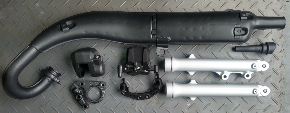

However I'd look at Ceracote as a finish. It's a lot finer (thinner) and looks great, but won't cover imperfections. I used High Caliber Coatings at Stradbroke in Suffolk who I found out about from CMM as Steve Cooper used them. You won't get potential issues when / if powder coating isn't done correctly and it rusts from underneath. Really nice guy runs it on his own, had some good chats with him when dropping stuff off, you need to call ahead. though It will be more expensive but I don't think it's overly so.
For example 250 Katana exhaust was about £140 ( 2 years ago - it's still sitting in the loft of the garage!)
Kawasaki F7 exhaust, X7 and 250 Katana brake calipers, X7 fork sliders (these about £220 I think for all parts shown)

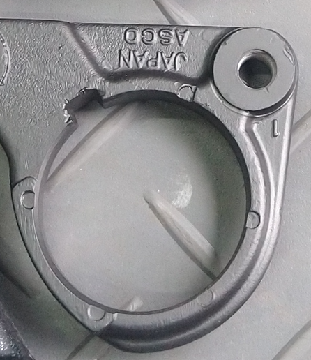

Detail on the X7 caliper
