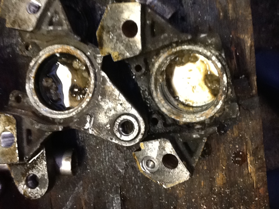

So how did these brakes actually work without any indication of an issue ?
I only went to check because although the brakes worked fine the feel was a bit wooden .
Looks like Jimnys sock is needed!
Ooher dosen't look healthy.

Jeez. Thank god you have been religiously changing the fluid every two years.

😂 Yep every 22 years religiously .....well it used to belong to a vicar 🤓
Re: Floaters brakes!
Post by johnr » Fri May 27, 2022 12:01 am
Exactly how long were they 'floating' in the canal then?

at least the pistons came out :D

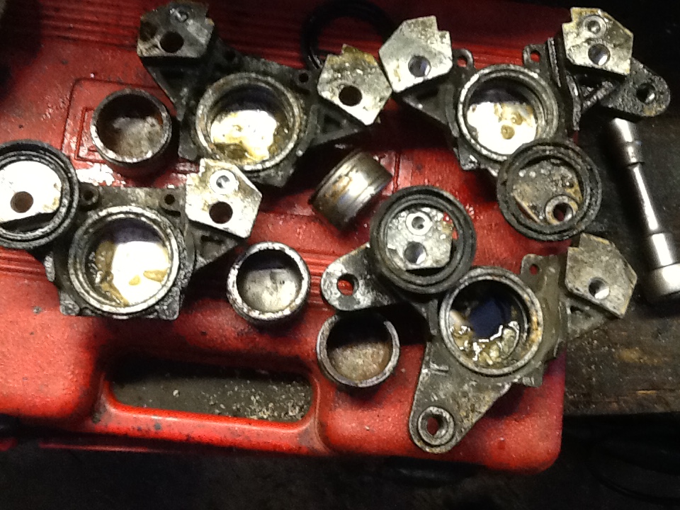

That's the bizarre thing the Pistons moved freely and just popped out . There wasn't a lot of crystallisation in the rubber boots , or pitting on the actual Pistons .
I actually cleaned the mastercyl first and bleed fresh fluid through ...They just returned to the wooden * onda feel .
Anyhow they are stripped and being painted now .....another 5 minute job eh?
