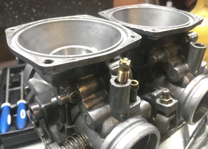

I have a dilemma! The pilot jet on my no2 carb is stuck fast and there isn't a lot of head left either. Do I leave it alone or enlist the help of a specialist. If I do the latter does anyone have any recommendations? Many thanks Scott

It was working it's just as I have to take the head off, I thought I'd do the carbs with service kits from NRP. It's the only one that's like it

Soak in white wine vinegar, dissolves the crud, have used this on the jets when they have come out, so should help to eat away the corrosion sticking the jet in, need a very good fitting screwdriver.

I’m guessing its the fuel jet that sits behind the little rubber plug in the float bowl?
Soaking in the vinegar sounds like a plan.
Do you have an ultra sonic cleaner?
Are you happy to split the bank of carbs? It’s not that scary once you have tracked down all the springs :lol:
To remove it if it is properly stuck will need a fine pillar drill and some v small left handed drills. So a job for the brave, a professional or a brave professional.
As El Presidente said, you can always replace it. 32 or 34mm choke. I’m sure I have a spare somewhere.....

It's exactly the one under the rubber plug. Yes I have an ultrasound cleaner I ran it through a good few cycles hoping it would ease it out. Bank is already stripped
