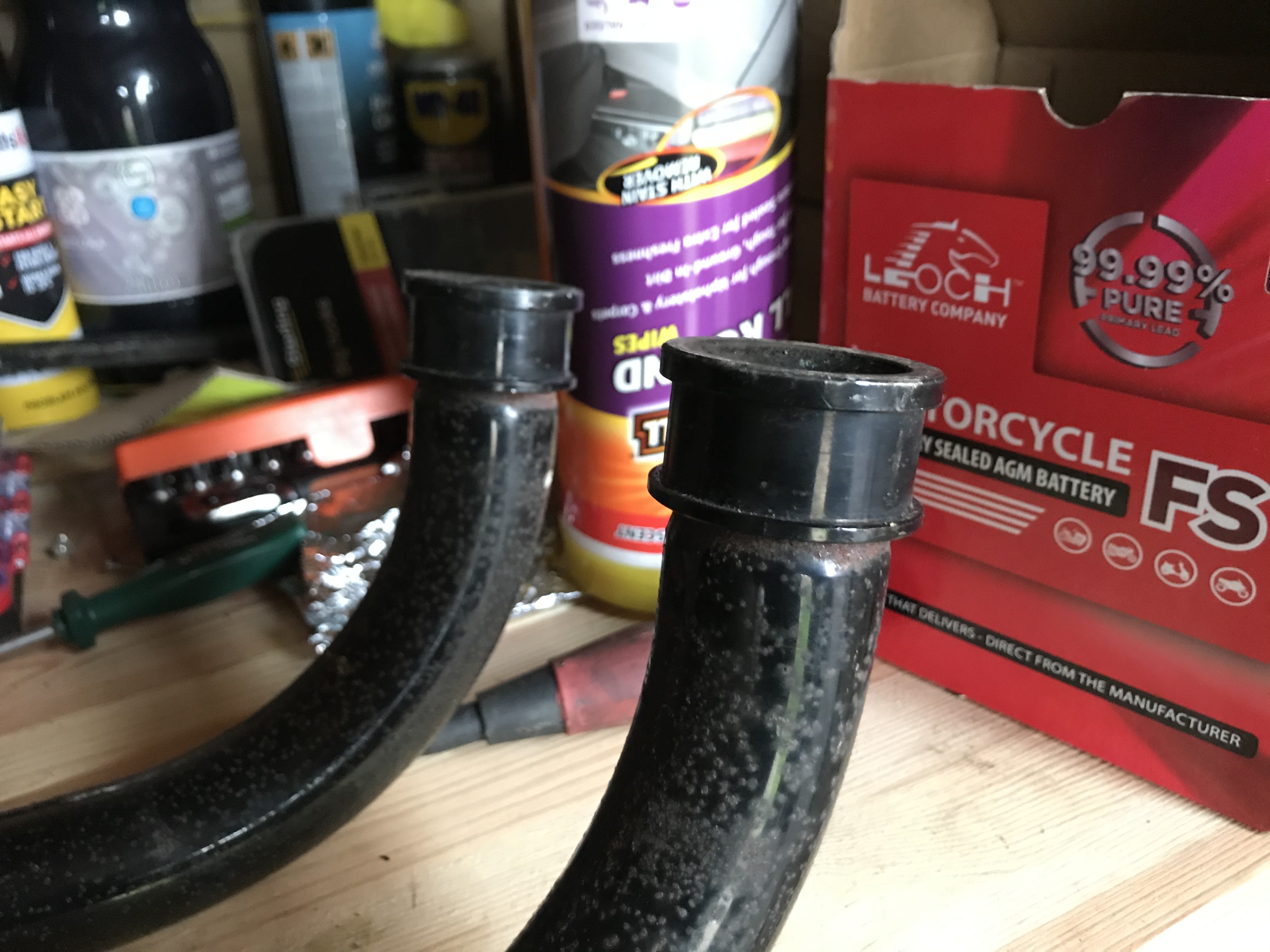

I just purchased a set of centre downpipes for my Pop up.
Just received and find that the clamps are missing and the collets don’t seem to be right
Could somebody tell me what should be fitted

Can't remember what mind look like , will look at weekend, for now measure the diameter , the pop up is less than the S1/2. Which these could be ...GSX 750 1983 could be either if you didn't know so could have been wrongly marked up.

Pop Ups have captive clamps on centre pipes that don't come off.. they're put on at manufacture.
You'll have to manufacture some collets and find some clamps, obviously.
I recently had to buy a whole bike just for the centre downpipes.. proper hen's teeth, so I'm amazed you found a dent and rust free set.

Yep , the clamps are on the downpipes on the ES/SE ...Those on the S1/2 are in 2 halves .
Which is why I suggest measuring the diameter before you go further . It could be that these are pop up ones but some muppet has cut off the clamps to get it off the bike OR it never had any because it's not the correct one.

I have checked the collets and as you suggested they are very slightly larger than the exhaust port
The pipe centre line up to the engine so I am wondering if I can just remove the existing collets and replace

This would suggest that this exhaust is incorrect , so filing the collects is only the start of your problems / project.. Next will be the bends will be different ....then of course the diameter means it won't fit into the collector as it will be wider on the bike .

I think I will need to try and source an aftermarket exhaust to at least get me back on the road
