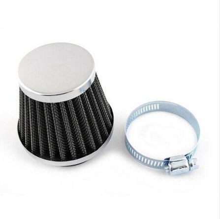

Looking to replace it, has anyone used one of these different shaped after market ones which look a bit more robust. Not sure what they're made of, paper or foam? eg https://www.ebay.co.uk/itm/MS-Air-filte ... 1811032911
Having said that, I think I may just bite the bullet and order a Genuine Suzuki one from Robinsons @ £38.

I’ve always found using pod filters entails altering the jetting.

Go genuine as you will have a whole lot of pain for not much gain. If memory serves me correctly the same filter is in the gsx400f from the 80's. I got mine from ebay genuine NOS but not for genuine price. I'll double check and get back

Don't go pod filters ....the 650 one is washable and cheap enough and yes same as 400f.

Will avoid the pod one if it requires re-jetting. Seems like too much trouble. Not even sure it would fit properly with a jubilee clip since the attachment hole on the airbox is D-shaped rather than O-shaped.
