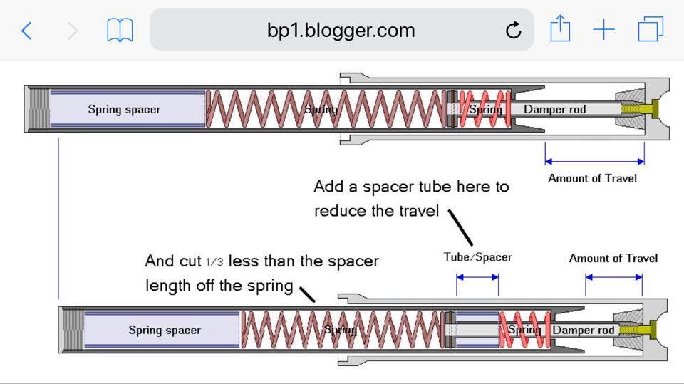

Sparki sent me an image of a mod that normally achieves this: So I have finally taken the frontend off today and stripped down but for the life of me I cannot see why they are about 2cm shorter. I had a spare (knackered) set of 1100 forks which I stripped for comparison. I have taken some images. Can anyone tell me how the Swiss Kat ones are 2cm shorter when inside they look the same - see images below:

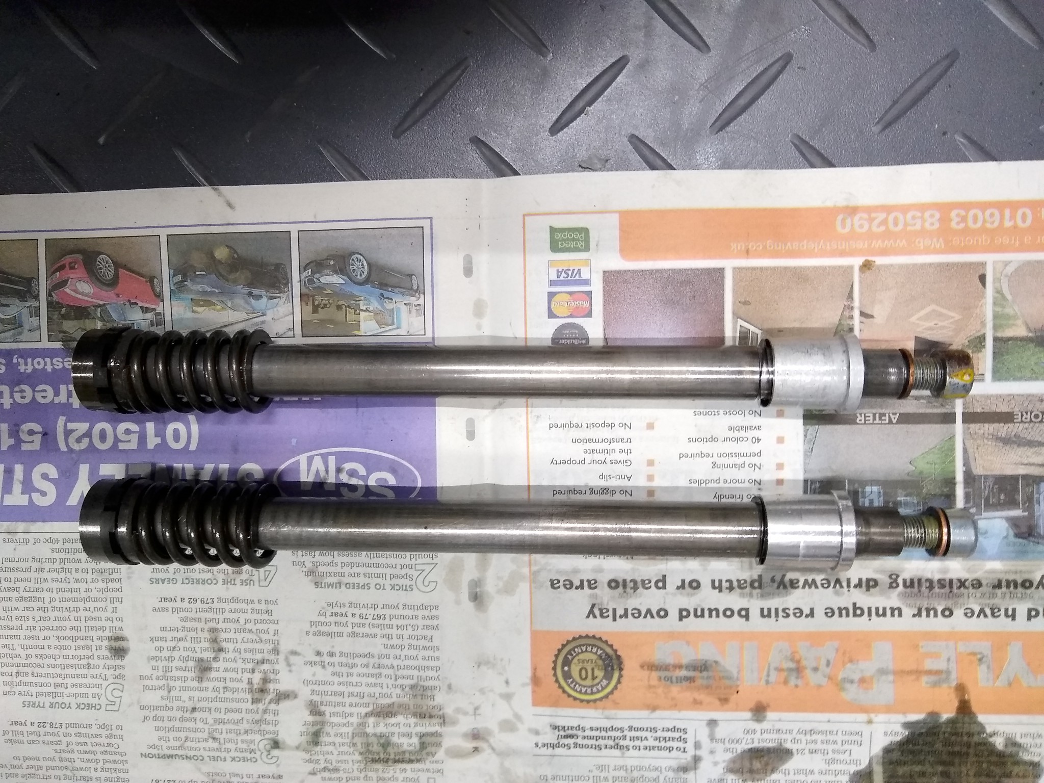

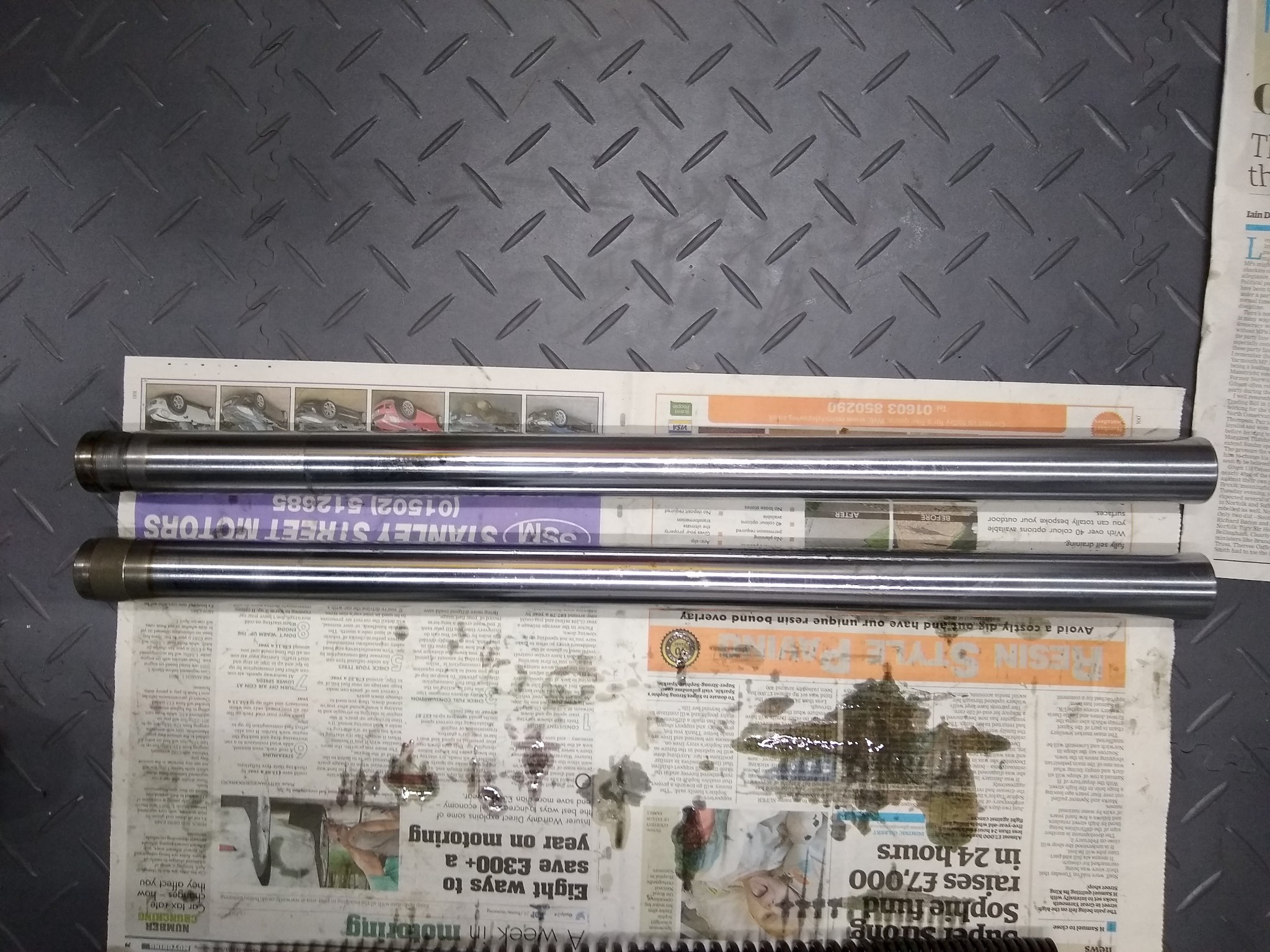

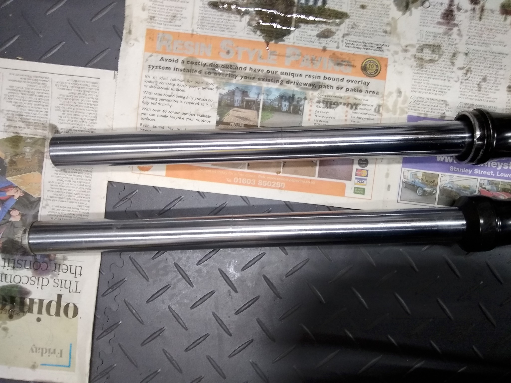

Ok the sliders are the same so I have just shown the top here (Swiss top, Spare 1100 below). Clearly you can see the Swiss ones are shorter. Here are the damper rods as removed (Swiss top, Spare 1100 below) - look the same and no spacer as Sparki's image would suggest there should be. Here are the Stanchions as well (Swiss top, Spare 1100 below) which are identical. Forks tops, top spacer and springs were also the same.
