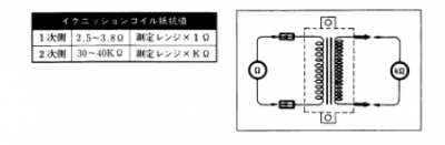

So the 400 > 1200 project i have the 1200 Bandit coils but the 400 coils fit without any brackets making so can i use the 400 Katana coils on a 1200 motor?
1200 = Primary winding resistance 2.0 > 4.0 ohms, Secondary 30 > 40 k ohms
But i dont know the specification of the 400 coils?
Anyone words of wisdom?

From the 400 manual:

Many thanks so yes on the 400 coils good.
