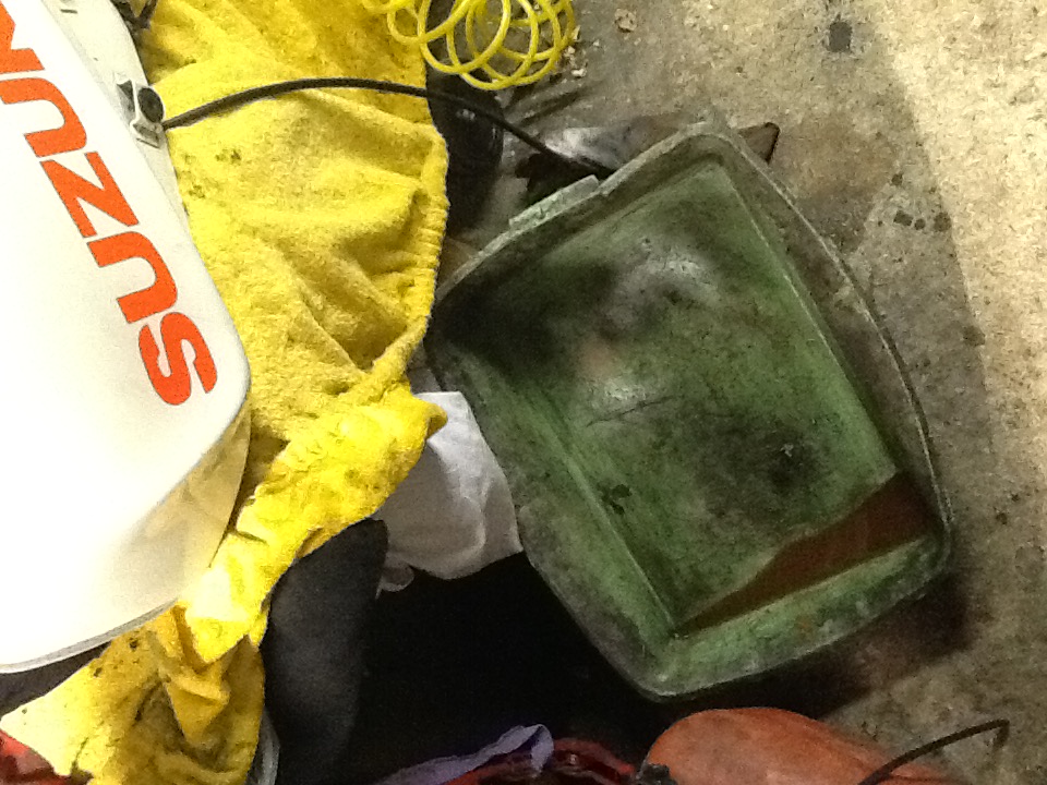

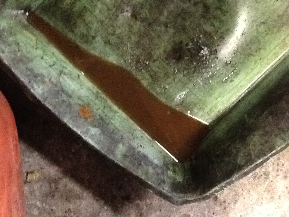

Anyway tap stripped further .....uuuum rusty colour gunge caked in tap.
An inline filter was also fitted.
Last drop of fuel from tank looks like..... :?
Closer
Problem found I believe....
Now the tank is dry ...it looks fine from top and through fuel tank opening.
