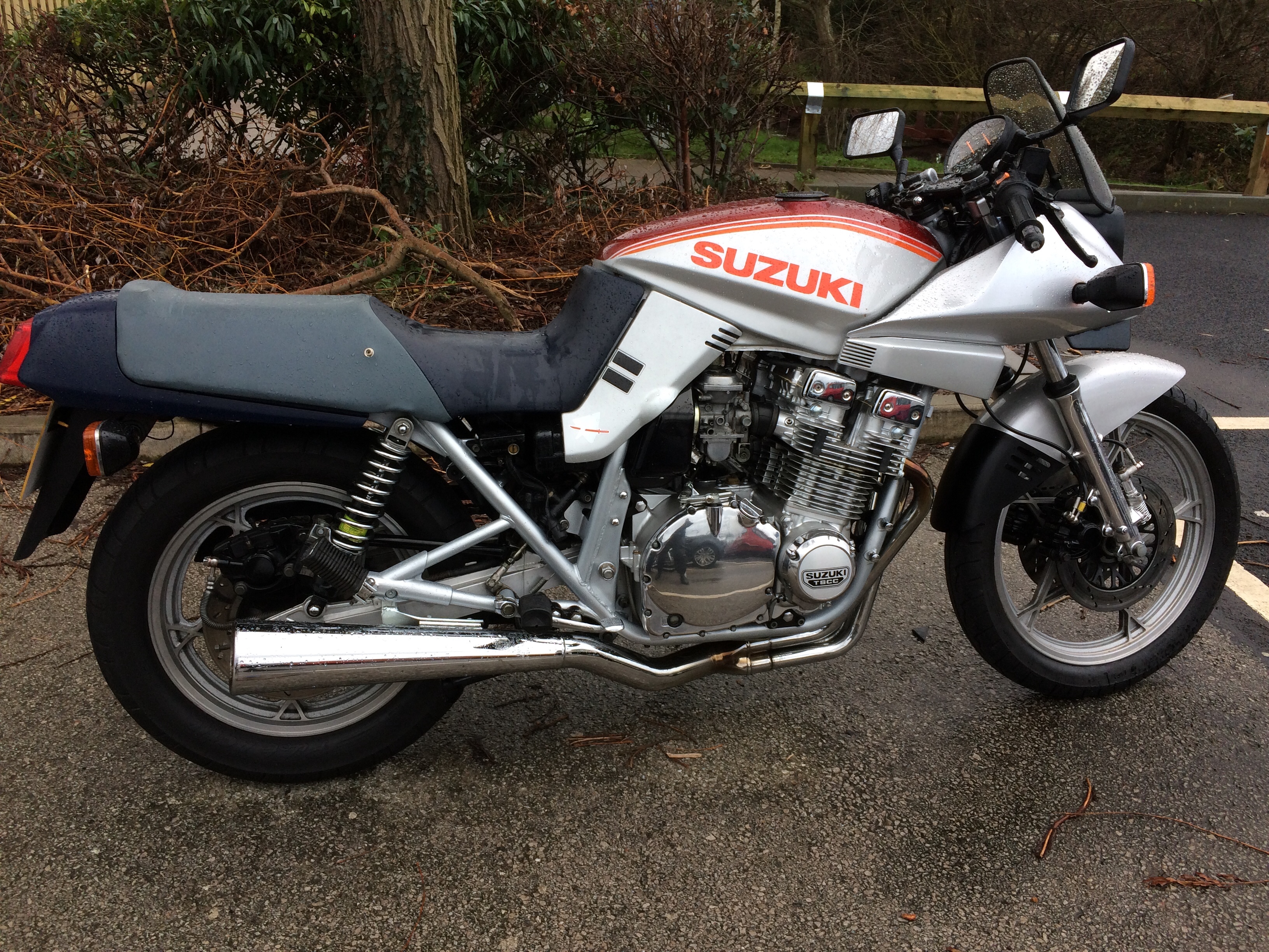

After sorting my carbs out I thought I would treat the old girl to fresh oil & filters all went well until on start up it started smoking like a good un? At first I thought I might have overfilled it slightly but after leaving it to settle for an hour the oil was half way up the sight glass. While I was having carb problems I noticed on one of the many test runs it was smoking when I pulled away from a stop but it seemed to clear up. It’s always smoked from cold but clears up quickly. As a desperate last thought I’m going to check the cam box breather tube isn’t twisted or kinked but after that it looks like I’ve got to strip the top end and check bores/pistons/rings etc. I’m a bit pissed off now as the bike was supposed to have had a new top end and cost me north of £7k with the deal I did on my old Kettle. Anyone got any ideas before I strip it or dump it in the canal near Fossie?

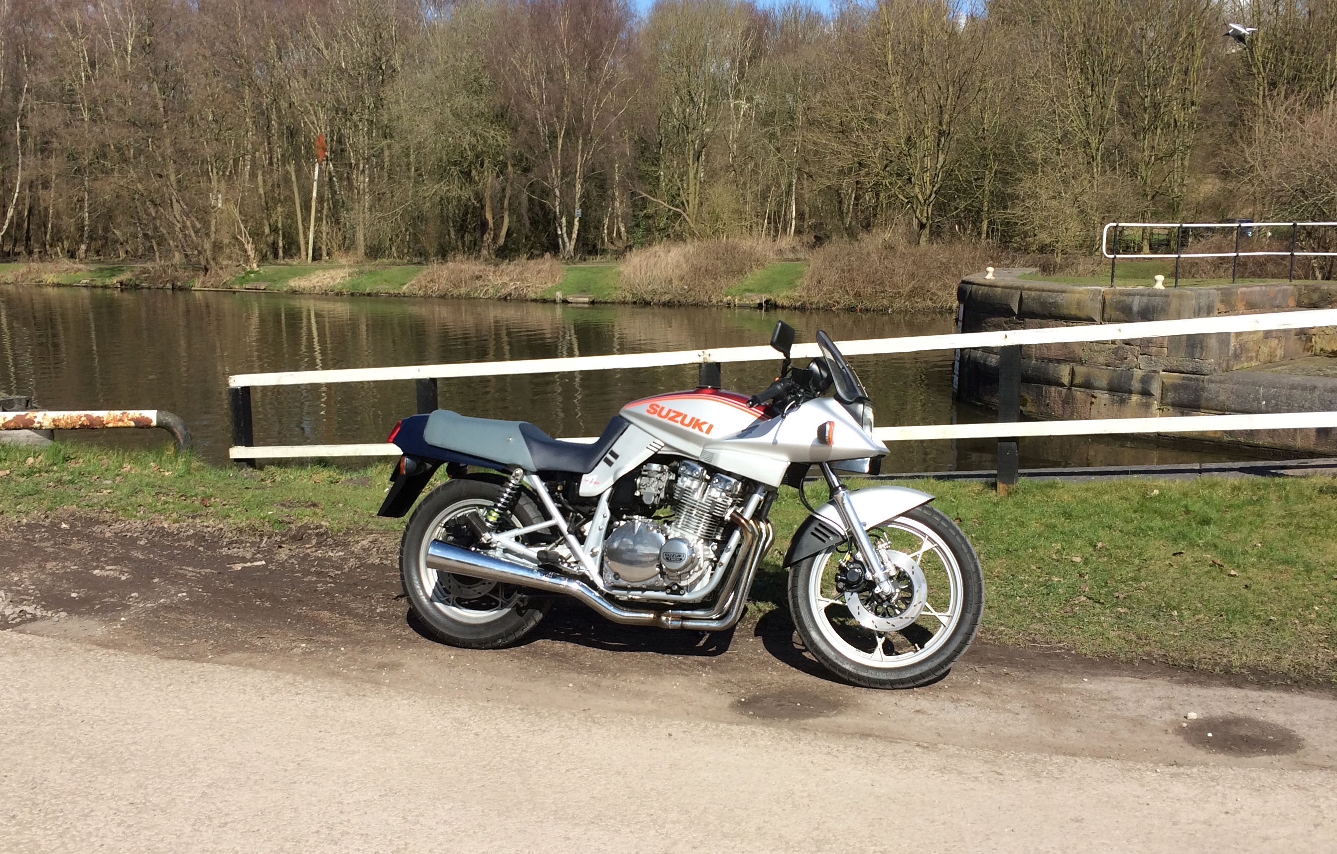

Well just back from my run out and after the initial couple of miles where she smoked like a good un the smoke screen stopped altogether? I only did a short run of 65 miles and even after stopping for a brew for 20mins there was no smoke even on start up
I’m now at a complete loss to explain what’s going on? So apart from a carb rebalance she’s good to go and only time will tell if I can trust it on long journeys. Here’s a pic where I stopped for a brew and a break.
