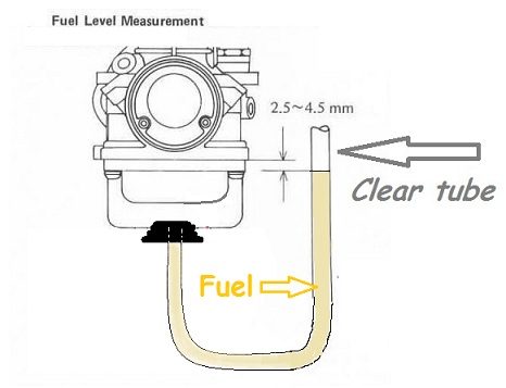

I got 2 of these:
https://www.ebay.co.uk/itm/Mikuni-Carb- ... 2778152771
and did it the way of + from the gasket face, though I can't remember the value (it's something like 2-3mm but I'm sure someone will be more accurate).
