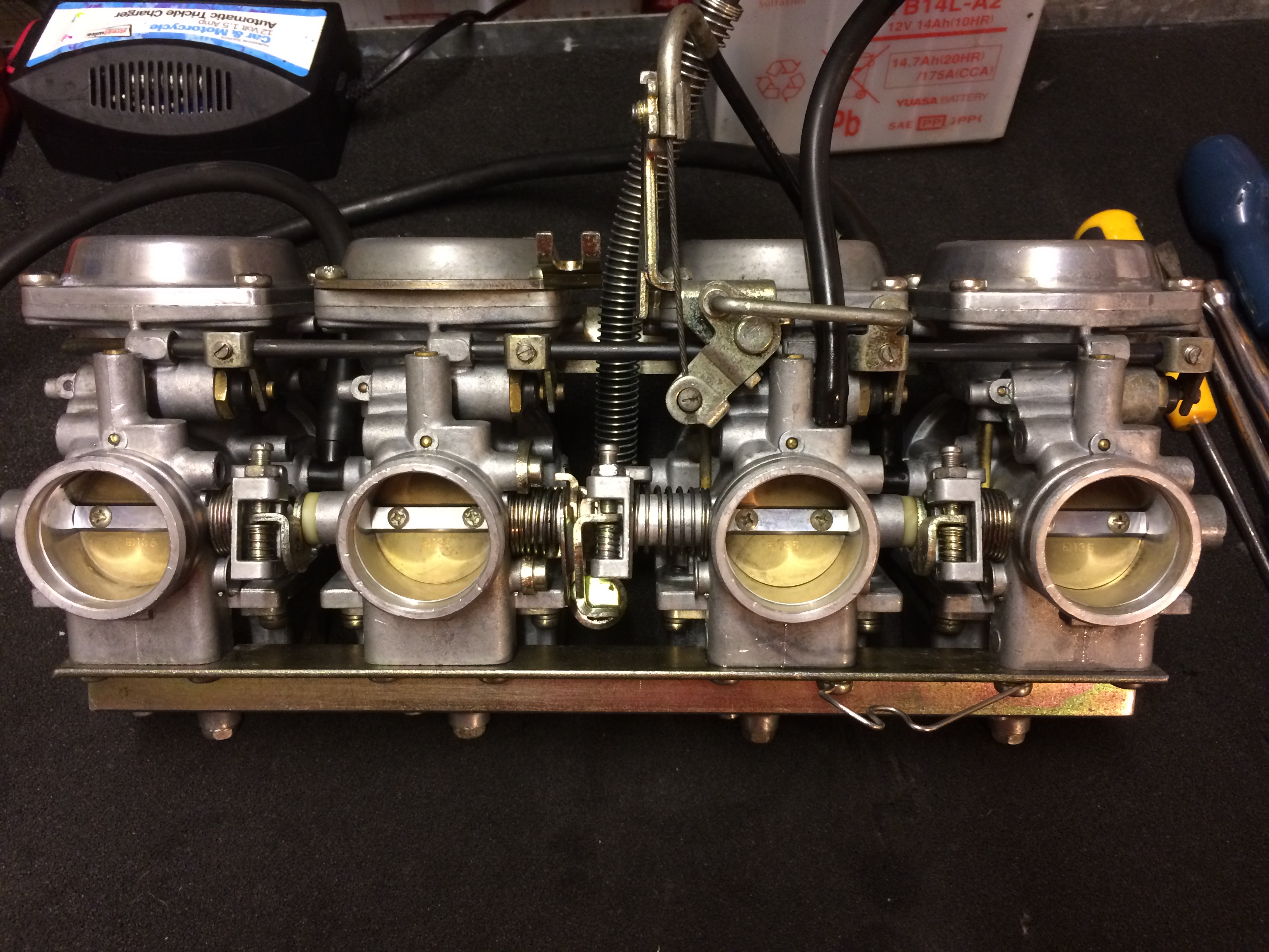

My Kat is running really rich, so rich that it doesn’t need choke even on the coldest mornings and if I try to use choke it just kills the motor. The plugs are black as a badgers bottom and sooty as hell.
I’m going to pull the carbs off it and have a poke around to find out what’s amiss. I’ll stick em in the ultrasonic bath and give them a good clean while I’m at it. Are there any pitfalls I need to avoid while removing and replacing the carb banks from the bike and any known issues when I get inside them?

A good few hours spent on the beast today removing the carbs and stripping & ultrasonic cleaning the first two. I removed the air filter box first only to find I didn’t need to
ah well I took the battery out and put it in trickle charge while I carried on removing the carbs. As I was told this isn’t the easiest of jobs and plenty of swearing was used to aid removal. I can see it’s going to be a real pain putting them back on the bike. I’ve stripped the first two carbs and apart from being filthy outside they looked pretty good internally so I’ve not found any obvious reason it’s running so rich? I’ve scrupiously cleaned the float valves and made sure the choke plungers are seating properly plus I’ve checked the float heights and main/pilot jet sizes and everything’s as it should be. I’ll finish ultrasonic cleaning the remaining two carbs and put everything back on the bike tomorrow and see how she goes. Fingers crossed.

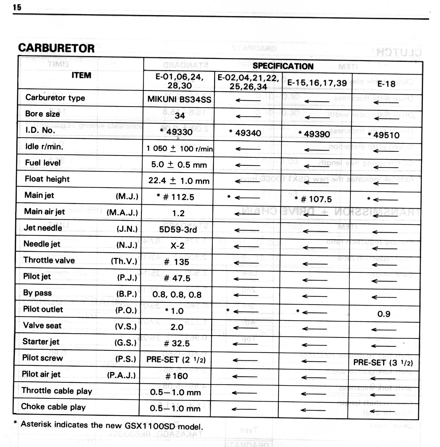

Sounds like the pilot screw and yes they are in the LiteTek kit (Pilot Screw O-Ring OR-005). I have added the Carb specs section from the manual for the SD so you can compare numbers and see if yours match or are indeed different.
Re: Running rich
Brilliant thanks for that Rob, I’ve saved that chart for further use. All the bits in the carbs are as shown on the chart so there doesn’t seem to be any problems with previous owners “improving” the carburation. Even the float height is correct!. Just have to see if things have improved when I start her up tomorrow.
