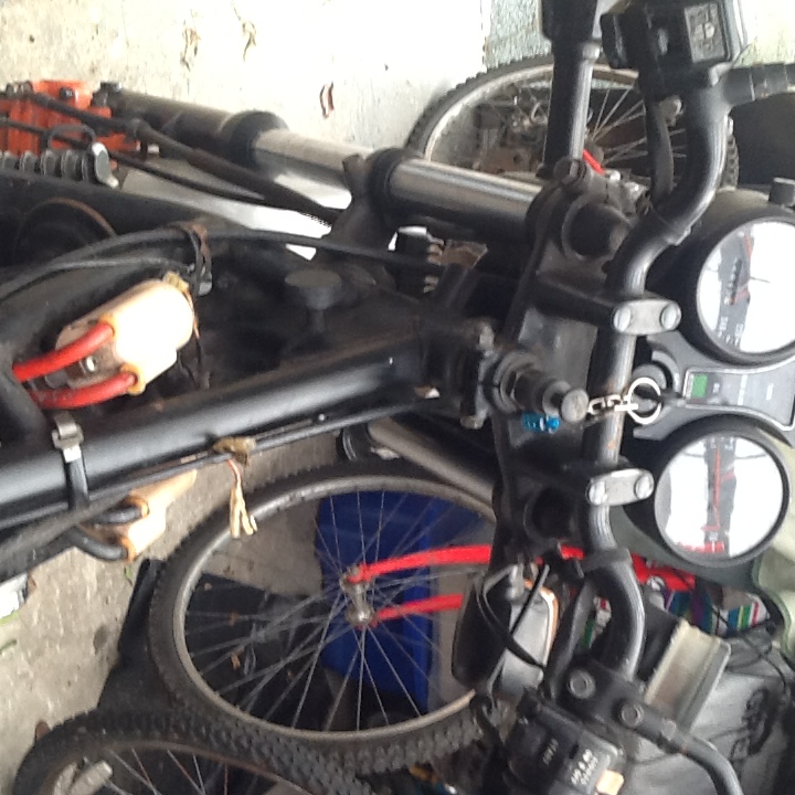

You will notice that the Rev counter happily sits at 1000 rpm... While the orange/white and yellow / black wires for the coil feed are in fact not connected , they are on show by the throttle cable.
On the plus side the carbs are indeed clean....and I was able to practice getting 650 carbs on and off......5 mins each operation :lol: :ugeek:
