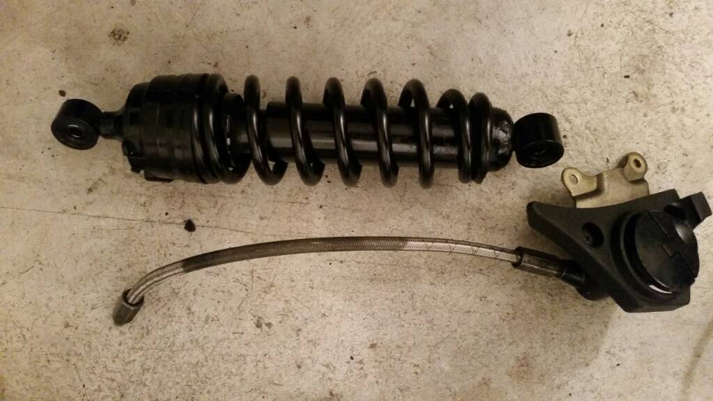

Post by KatanaBob » Sun Dec 18, 2016 6:42 pm
Sent from my SM-G900F using Tapatalk

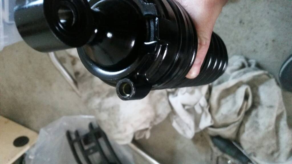

The line was connected. When i unscrewed it there was only a little oil in the line, none in the shock. I have two of these and both were the same. The one in the bike was leaking so i bought this one to replace it i just dont know how much oil i should add?

Post by fossie » Mon Dec 19, 2016 12:34 am
Interesting ....it looks like the original but that is cable operated and not refillable as it is sealed.

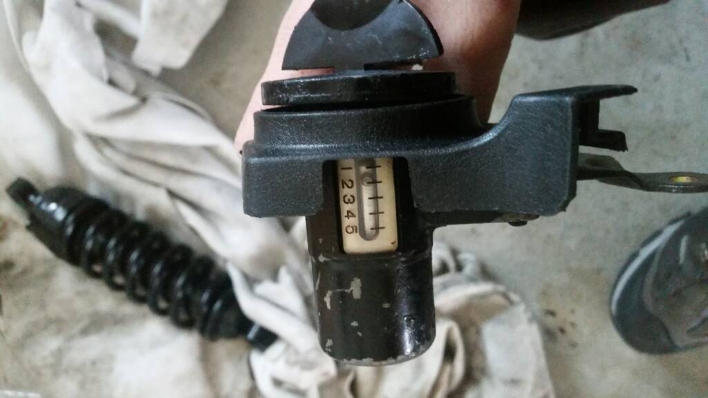

Post by KatanaBob » Mon Dec 19, 2016 7:32 am

Post by fossie » Mon Dec 19, 2016 7:46 pm
Well they do look indeed as if of a pop up (gsx750 SE). The Es ones had another dial although the same diameter etc, but non had a braided line and non are repairable or refillable as they are filled and welded at the factory hence no reference to amount.
No oil will come out as it is sealed in where that hose goes to is where the cable goes to with a peg to adjust.
Where did you get these from?
Either way any replacement original shock is over 30 years old so even if very low mileage won't be at its best. An aftermarket monoshock is the better option.
