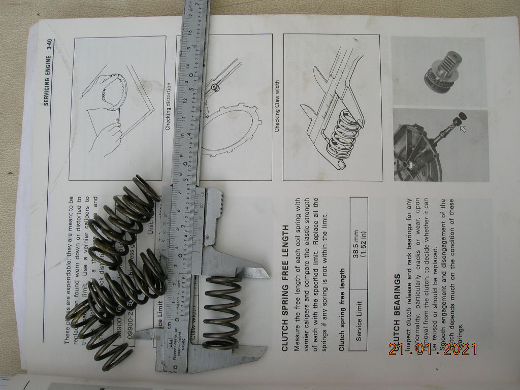

I found the old clutch springs that I replaced when the clutch on my bike was slipping. Photo shows the longest at 38.5mm. Others are shorter, so they are all bit tired. The WSM shows the service limit at 38.5mm.
Kryten, it looks to me as if your springs are 39.9mm long and not 49.9mm as you said, unless I am reading your vernier incorrectly?
David
You are correct. 39.9mm. Finger trouble on the keyboard while multi tasking!
