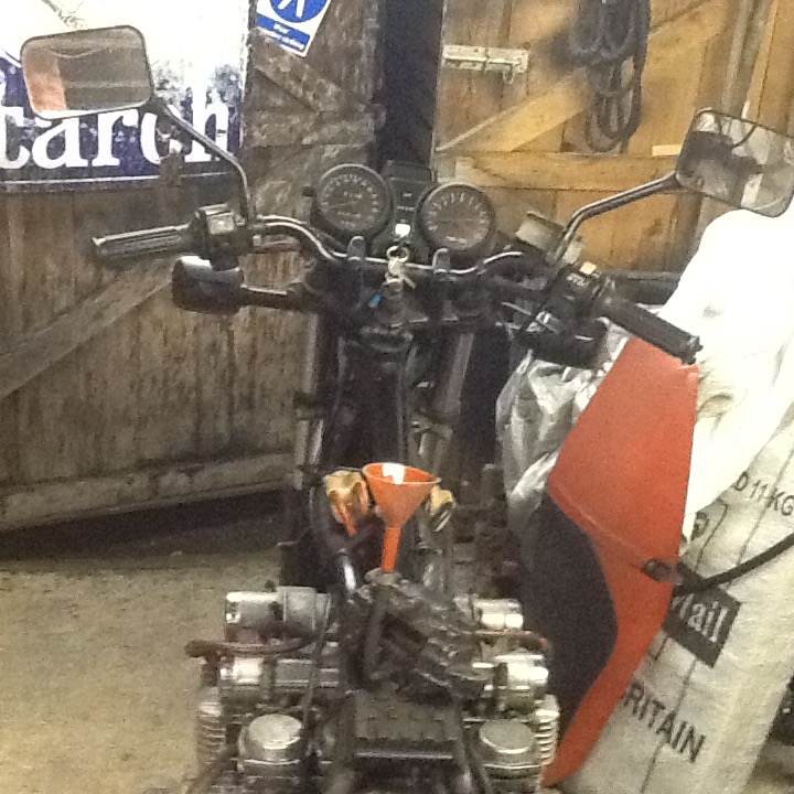

Note smoke from both sides ......equally........ No real reason for this photo except people like pictures of bikes ticking over on 4 cyls ......when they are supposed to.

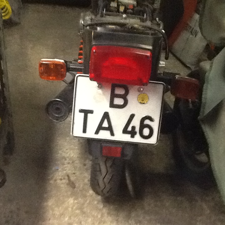

Clearly Brexit to blame........the bike was registered in Berlin , home to Mrs Merkel.....
