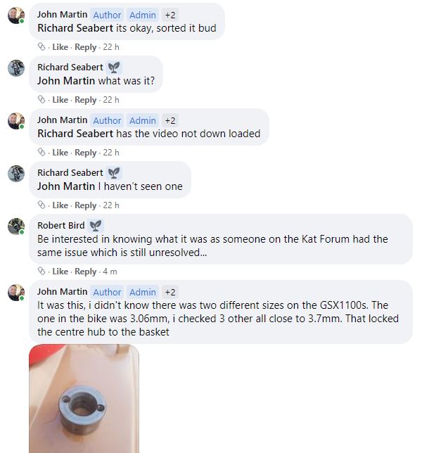

John Martin just had a similar issue with his Charity Katana rebuild and it is fixed now, here's a screen shot of part of the post - not sure if your issue will be the same or not...

Is the problem the bearing that fits into the Primary Driven Gear? There is a spacer and the bearing between the spacer and the primary driven gear. I checked the condition of one on my bike and all seemed good. What is John etc referring to when measuring this bearing? What exactly are they measuring? Seems such a small tolerance they are talking about?

I'm not sure, I'm only passing on the info I saw in the post as John had a similar issue. I'm not sure what measurement the 3.06mm and 3.7mm refer to. you'll have to ask John.
Basically if you haven't seen he's just restored a Katana as a charity build ( https://www.facebook.com/groups/167716501327189 ) and when he put the clutch back together as he has spares (from various GSX's of the era) he used the best parts he had, but as it turned out the part he shows in the picture he thought was the same was in fact 0.6mm difference and that was enough for the clutch to lock.
You can see the thread in the Charity Bike Build on FB as linked above, then you'll see the post and can ask. BTW FBJ on here is John (he did post just after the one I did with the screen shot).
That might not be your issue but thought it was worth passing on...

I have just been messaging John Martin on FB. He really nice bloke and has suggested things I need to check.
