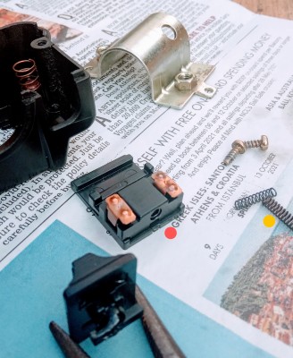

Hi...hoping someone can help.
Almost finished a self rewire of my Kat...everything seems ok other than main lamp. Tracked it back to broken hi/low beam etc switch. Sorted out the problem (I think!) but stupidly having never taken the switch assembly apart, didn't take pictures first.
I have 2 springs which go somewhere but have no idea where (yellow dot). Also in pic (red dot) is a small spring in the little hole.
Feel stupid but hoping for help :( :D ...thanks

I believe those springs are captive behind those brass sliders?

Thanks...I have those two springs in place under the sliders, so something else. Cheers

IIRC there's two springs that slot into the sliding part that make it return to center. It's truly a POS to work on and you can never get them fixed if they're broken.

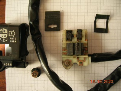

Three times over the years I have had the turn/main/dip button fall off whilst I have been out riding. Perhaps I use the indicators too much??
Twice I replaced it with a genuine Suzuki assembly. After it came off the third time I managed to grab hold of the button and use it to make an improved metal slider part that goes in the switch. This has not come out (yet!).
I still have one original switch unit, without the button. I have partially stripped it and here is a photo of the inside. If you need me to take it apart further just let me know. I can also take higher resolution photos.
I'm not too sure about the location of the two black parts at the top. They fell out as I took the switch apart. I do know that the flimsy plastic part goes back in first, then the thicker part with the slots in it, but I'm not yet sure which way around they go.

Thanks David...that's a great help. Shows clearly where one of the springs goes :D I know how the two black bits of plastic fit...so just one more spring and a small ball bearing to go. It is a pain putting it back together but once I know how the last two bits fit will persevere till done :)
