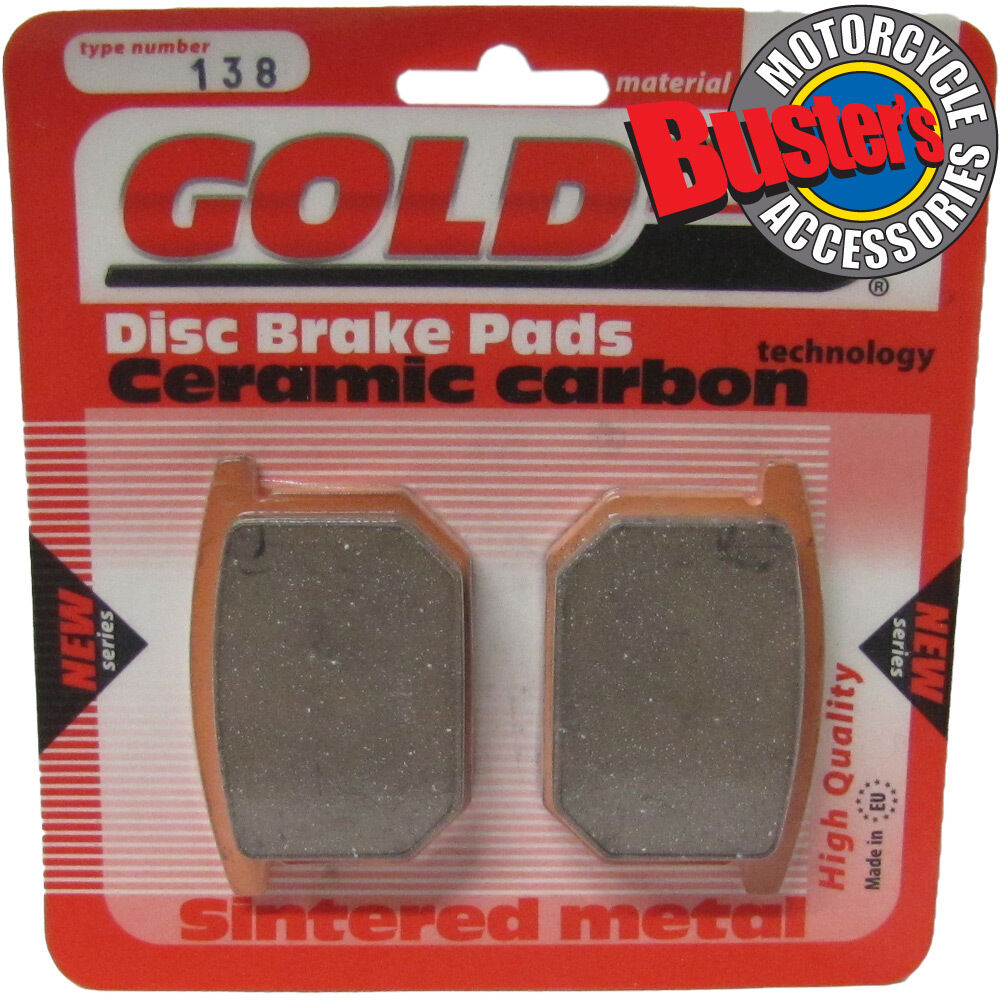

Anyone know any good brands which are currently available?
Ebay turned up these cheap Goldfren brand ones for £13 a pair. Anyone used them?
I remember on my old Suzuki GS 125, the particular brand used made a big difference. EBC gave poor performance, but the genuine Suzuki ones were very good.
Thanks in advance.

The best performance ones for a 650 were Vesrah ( OEM under a different name) SBS (Scandinavian brake services..) EBC ones were made in 3 compounds , the backing colour denotes different compounds ..I used black because they were a touring one and gave more miles ..and left your discs intact longer ...green more Kevlar better braking but less miles ..Gold .more metal sintering .same braking because that's the limit of the actual brakes But ate the discs.
The ones advertised are generally what is available now as everything is sintered. People expect to replace discs as a service item nowadays . So brake pad manufacturers make less compounds.
Ideally what do you need the brakes to do ? While dispatching my 650's for 20 odd years , the only issues I had were cooking the rear brake a few times while filtering exuberantly! They came back after 1/2 hr.....
I suppose nowadays it depends on what's available.
As an aside the company bikes we use now ...( was 650 Bandit ..now v strom650 ) have used these brake pads with no question as to performance , but we asked for them not to be used now because they don't last long enough in our job only last 4000 miles so need changing I between services.

Someone recommended those Goldfren pads to me, said they made a lot of difference to an early GSX they had, so as someone who always bought EBC I thought I would give them a try... that was over a year ago, and they are still sitting on the shelf in their packaging, so at present I don't know how they perform :o
