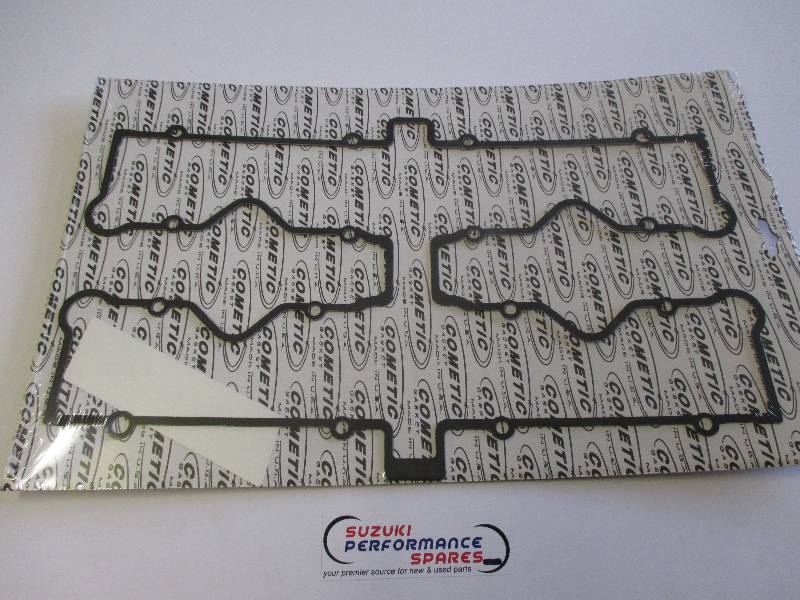

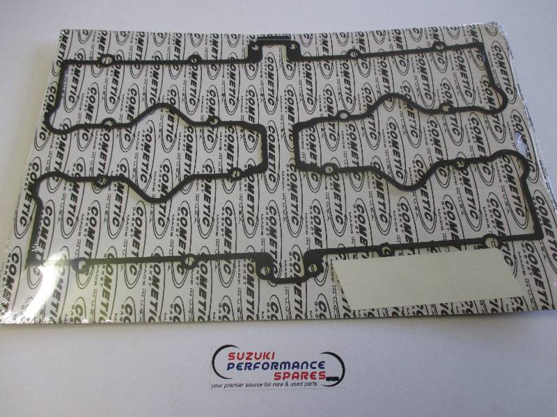

There is quite a difference between the earlier 20 Bolt cylinder heads and the later 24 bolt versions.
Borrowed these photos from Suzuki Performance Spares:
24 Bolts
20 Bolts
The 2 gaskets have not been pictured the same way round but you can see the difference.
There are changes in the spacing of the original 4 bolts front and back of the cam chain tunnel.
So unfortunately they are not interchangeable.
Here's a link to their website:
https://www.suzukiperformancespares.co. ... sket/2196/
I am not promoting their business by the way. Just acknowledging the info from their website. There are other Cometic/Performance/OEM sellers.
