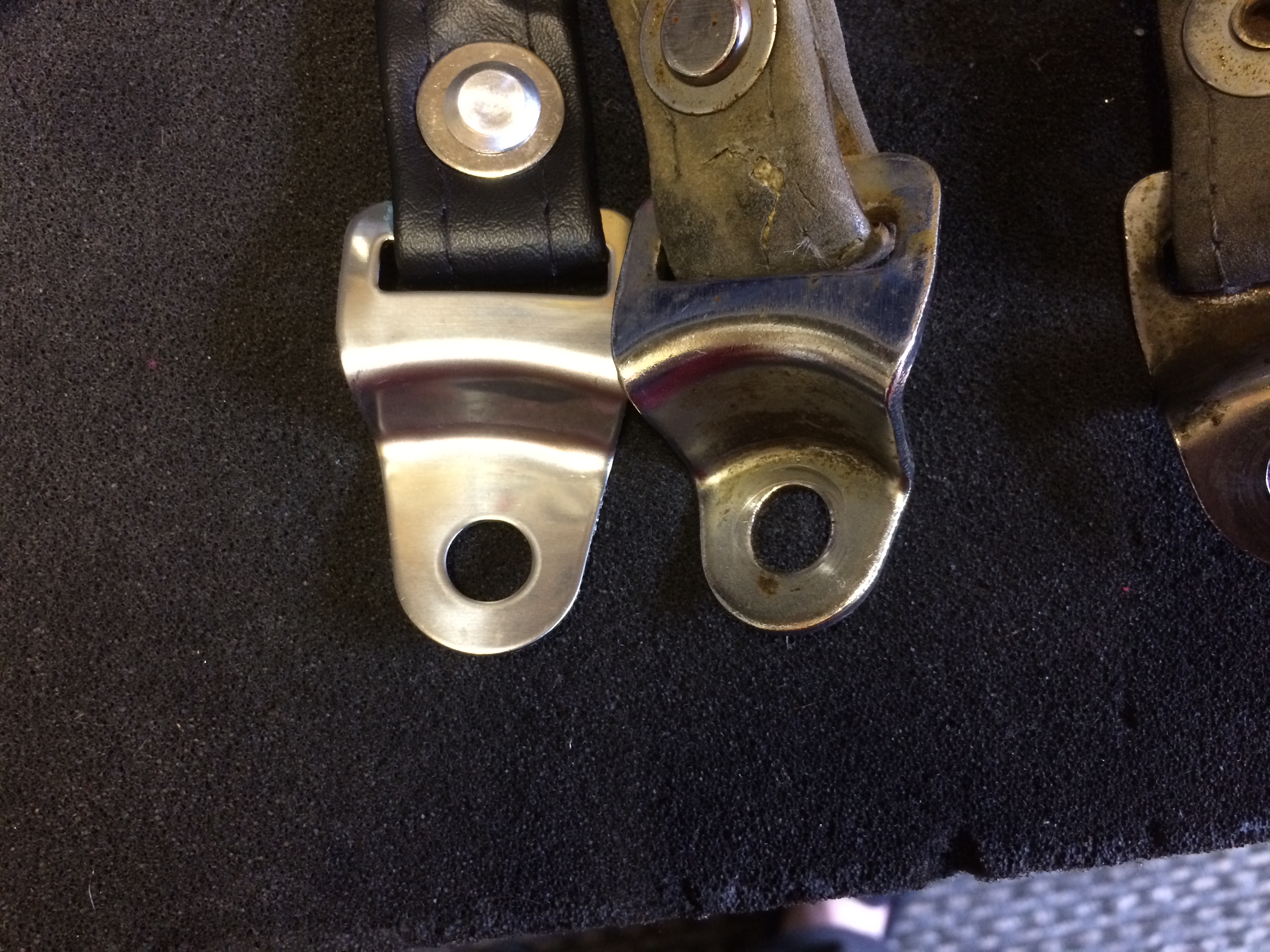

and as the brackets looked very close I bit the bullet and bought one. They turned up the other day so I got stuck in tonight and I’m chuffed with the result. Here’s some photos incase someone else needs one without paying £60 odd plus postage from Japan.
Fossies original (right) and the new strap

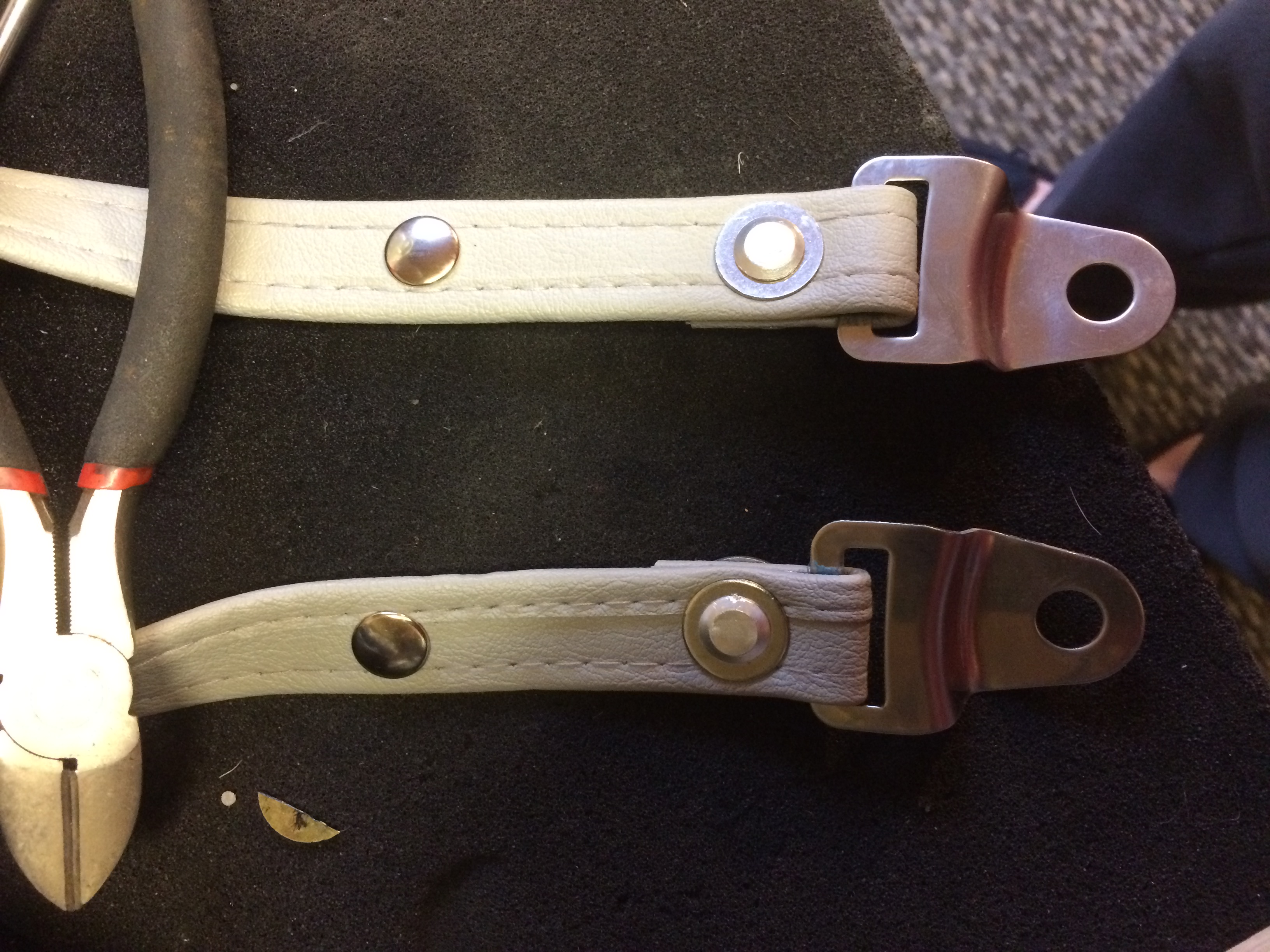

New strap made up with fittings stripped from the eBay strap

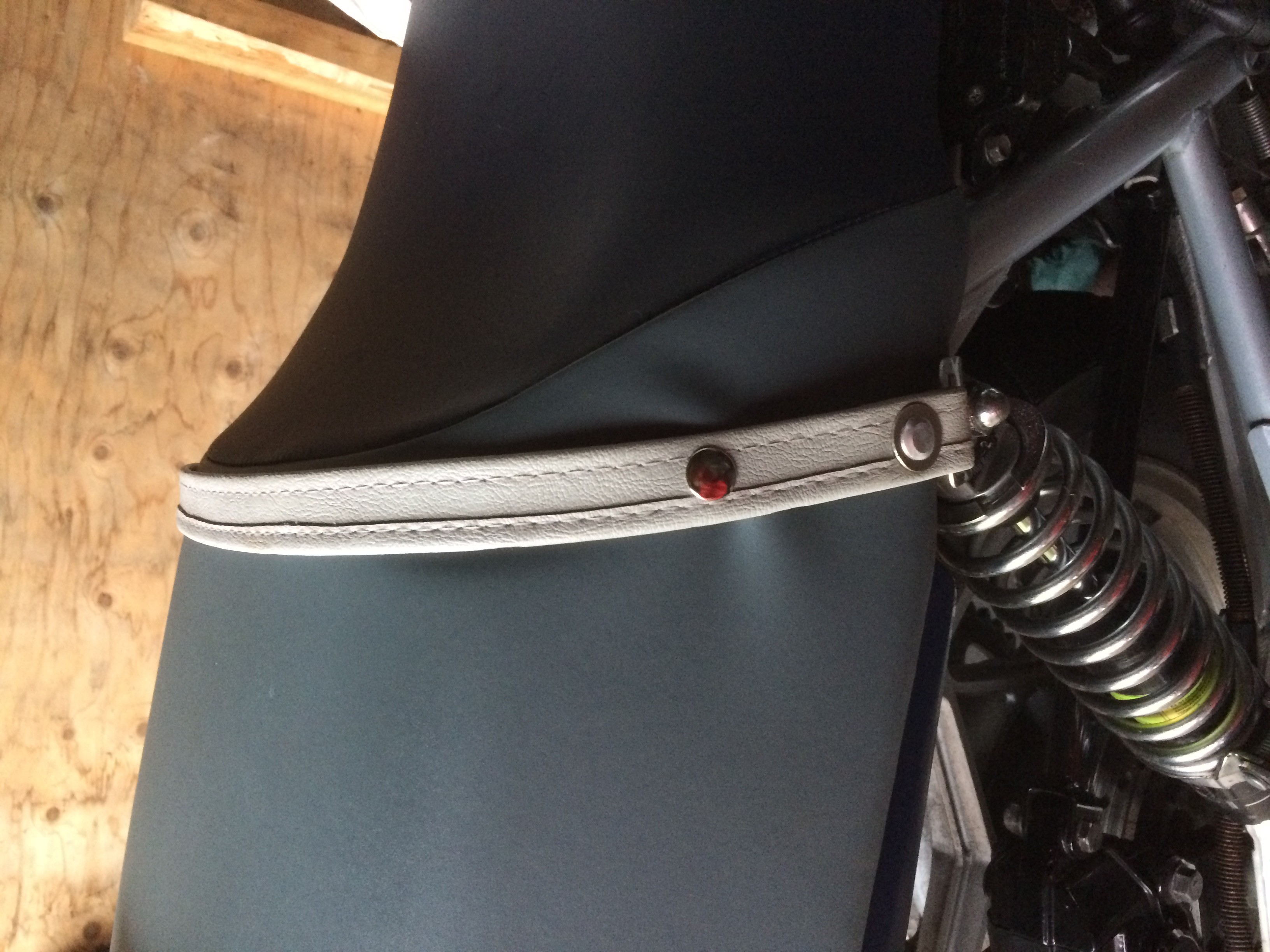

Finished and fitted to the bike

Thanks for taking the time to look it up for me John, your a star. They are very slightly different to the originals but only a rivet counter would know. For those that do care the originals are slightly different left to right, one is bent slightly different to the other. If you look at the pic below with the new one compared to the original you can see the original is slightly deeper for some reason? the other side is almost identical. The only other difference is the original is made from thicker gauge steel. A big plus for the new ones is they are made from stainless steel so no rust.
