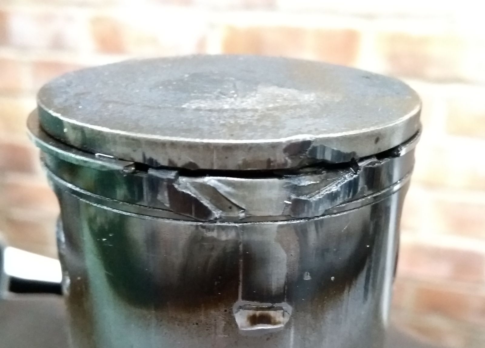

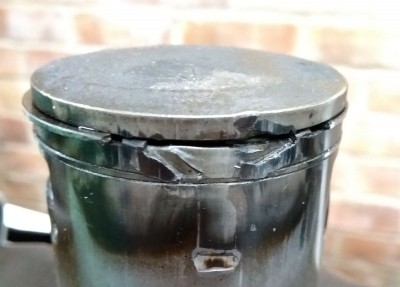

This is on my TZR but principle will be the same. As an aside can't remember if I posted here but last Oct. while on a spin it went clunk and lost power but got me home 20 miles. Took barrels off finally last weekend and this was the exhaust port side of the left piston...
