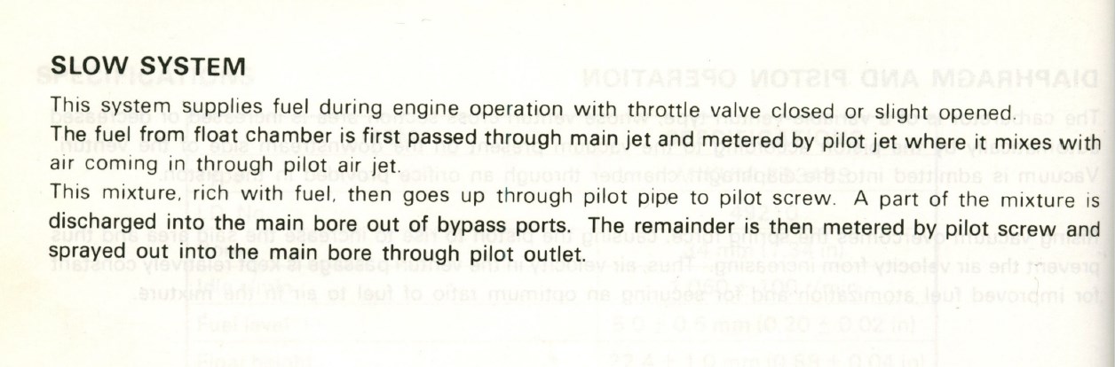

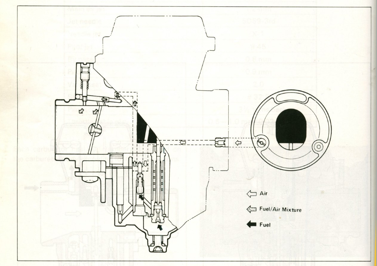

According to the Suzuki manual above: Slow running is achieved by air being drawn into the carb through the pilot air jet. It then travels through internal passage.
It draws fuel from the float bowl via the main jet.
Then the mixture is drawn towards the pilot screw, but part of the flow is fed into the carb adjacent the butterfly, this gives a baseline fueling for this stage.
The pilot screw then meters the remainder to optimise the fueling at this stage.
Unscrewing the pilot screw allows more fuel/air mix in. Screwing it in leans it off. So you are right that maybe in the past they have been set that way which would make it rich.
As for figures anywhere between 2 to 3 1/2 turns out from closed seem to be acceptable depending on the air filters, exhaust and general tune of the engine.
