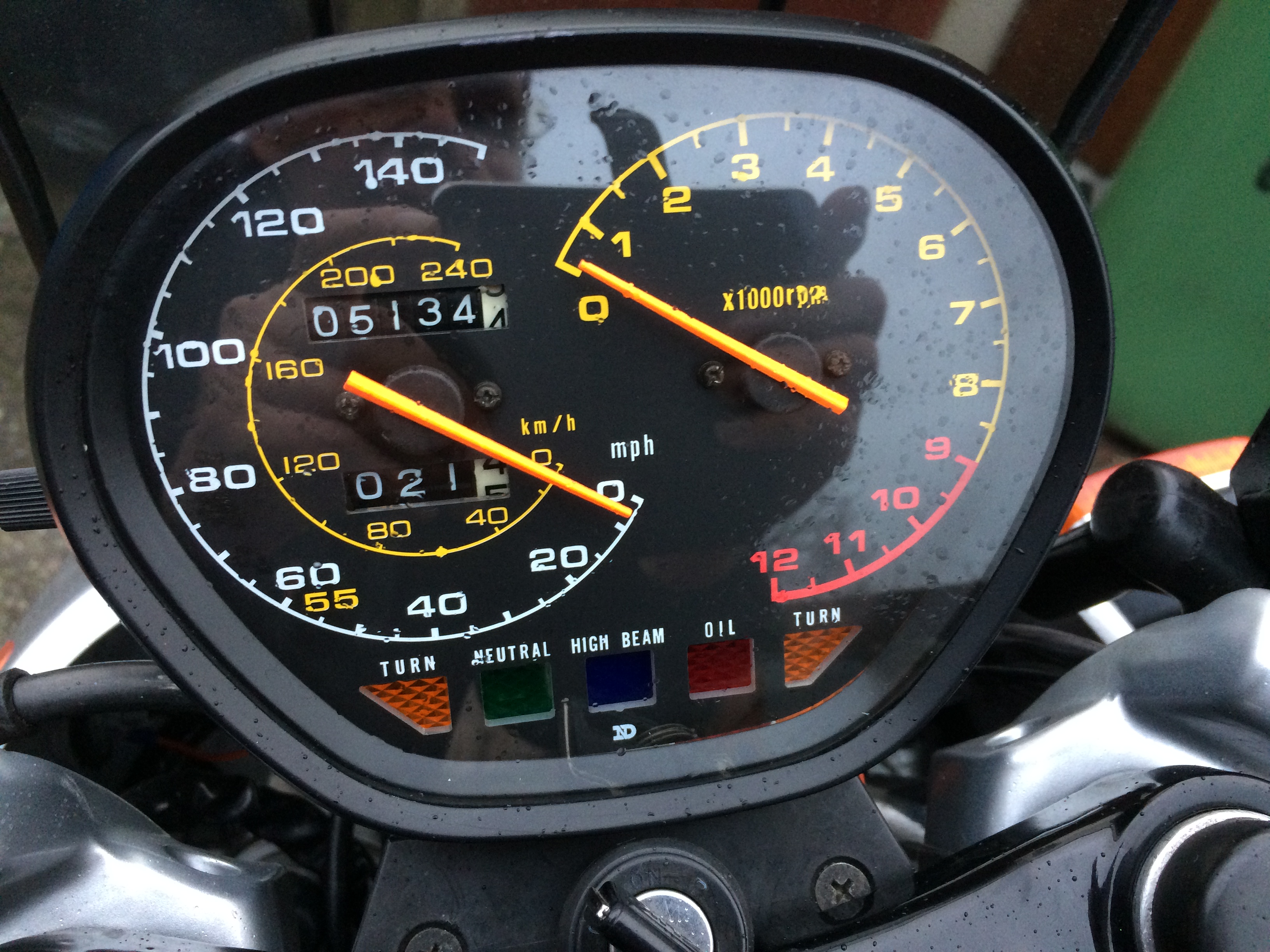

Our very own Fossie who lives close to me has seen the bike and thinks the problem might be the wrong drive fitted to the head? I don’t suppose in your spares stash you would have a correct drive you would be prepared to sell? My bike has a 19” front wheel and mph speedo

Paul I reckon if you pull off the glass remove the mph face and below it will be the km/h ones.
Placing a blue speedo cable convertor at the clock end will make the speedo read in mp/h but only the bottom of the clock will be used0-80.
