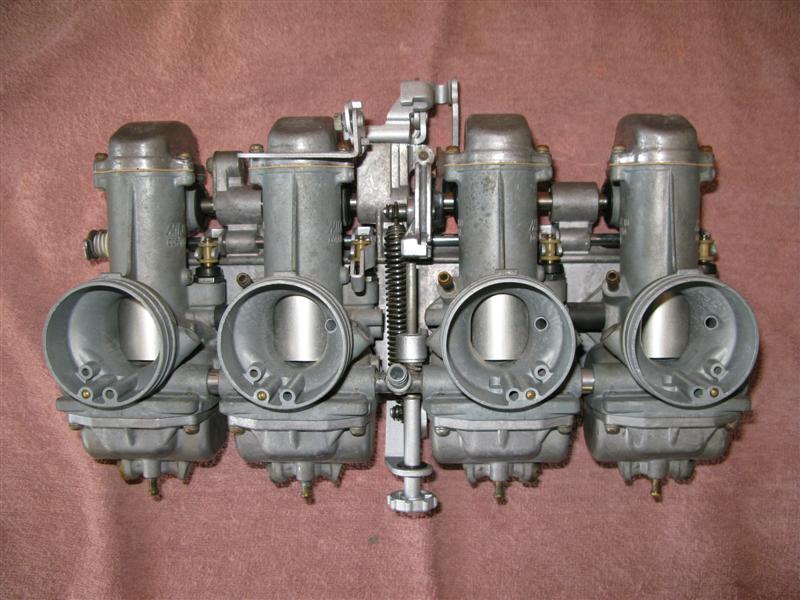

fossie, I have a big untrasonic tank, 30l, get a bank of four carbs in complete easy. If you can stand the postage send them to me & I'll give them a good cleaning for you. Just done my kat thou ones, pics below inlcudes some extra work on peripherals and they were completely stripped internally and all O rings & gaskets replaced but you get the idea.

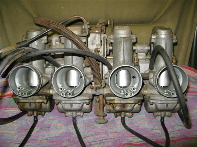

Post by fossie » Tue Sep 20, 2011 9:54 pm
Well thank you peoples , Kryten has offered to take these carbs out to middle of the north sea with him, where he was going to dip them in a great expanse of water. I assumed an ultrasonic tank but maybe he was just going to hoy them over board! BUT he can't do that till October.
So if it's ok I'll send 'em to Richie mouse , 'cos my should have looked like the second picture but look like the first.
To be honest john I don't know what they need , they are now a set made up of 2 or 3 , so they could well have been standing for years, and all the internals blocked, the only way to eliminate that is U/S cleaning.
