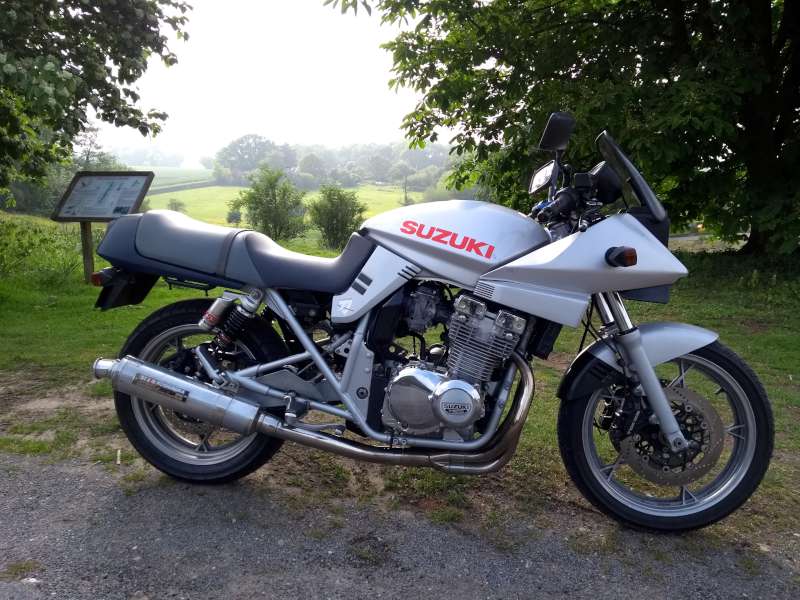

So the 400 is back together again, with the polished engine cases (were painted), Suzuki emblems on the side and some powder coated parts (mostly hidden but I did finally do the top yoke.
So this morning filled with oil and tried to start it, but no go. Took out a plug and no spark. I had repaired the signal generator cable as it had started to break so assumed I had broken it instead.
Had some work to do,so came back to it later, whipped off the tank and I think when I was running the sig gen cable, I must have had a senior moment as I had forgot to connect it up! Doh, but at least an easy fix. Still need to remove a snapped casing bolt, but MOT runs out Tuesday so need to get it to the test centre really - that can wait.
So I found some hills (in Norfolk!) to take a each side shot.
Photos still make it look better then it is generally, but for £700 it ain't bad.

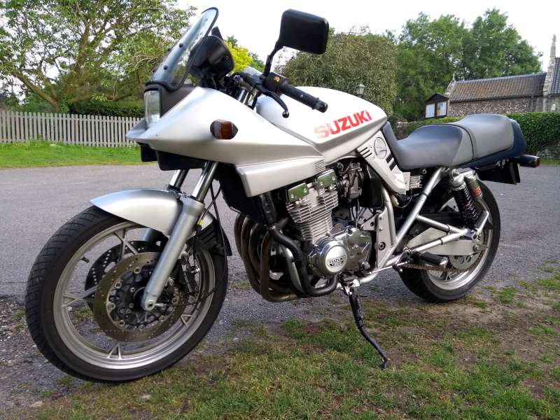

I always thought the 250’s & 400’s where watercooled, that looks suspiciously aircooled?
- Posts: 1792
- Has thanked: 118 times
- Been thanked: 254 times
Re: GSX400SSN 2018 minor revamp
They are, 2nd photo shows the rad and hoses.
Kryten wrote:They are, 2nd photo shows the rad and hoses.![]()
Suzuki stuck the cooling fins on to confuse people, seems like it works

I've had the 400 and 1100 next to each other and people haven't noticed! It is fairly well blended in.PaulD wrote:Kryten wrote:They are, 2nd photo shows the rad and hoses.![]()
ah right I can see it now, shudda gone to specsavers
