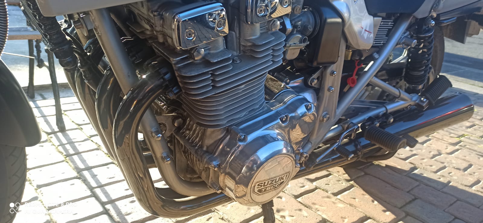

Hi All,
Was an oil cooler standard on the UK GSX1000S with the round slide carbs? There are two mountings on the front frame down tubes, but I have seen one bike with no cooler, and then the one below which has one. Anyone know the answer?

Post by Bikeazoid » Fri Dec 11, 2020 6:54 pm
Mine had one, but I don't know if it was an add on. I kinda think it wasn't because mine was super stock.

Post by GSF34058 » Sat Dec 12, 2020 3:10 pm
Mine does not have one. It has the plastic thingy that looks like an oil cooler (part number 94445-49300).
I know this is how my bike was originally, because my brother unpacked it from its crate, assembled it and did the PDI when the bike arrived new in the dealership in 1982.
David.

Post by fossie » Sat Dec 12, 2020 5:06 pm
Non were fitted as standard , just the fake cover .
