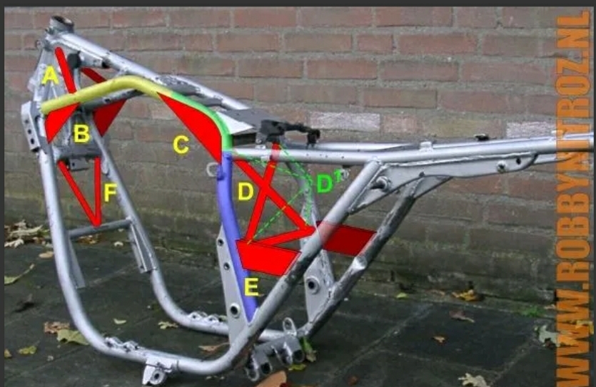

Now that I'm ok with "remodeling" it, I was going to have my mechanic do some gusseting on the frame.
Question, is there a plan or pix I can download of some guide lines for that part of it?

See here.
The pic shows a lot of spots for gussets, I even saw people doing every single one to their frames. But my experience says: bracing the frame in the center (area D in the pic) is all that you want, even for track days.
Not necessarily done like in the pic, but like you would do an upper mounting bracket if you did a monoshock conversion.
Did that on three Kat frames differently, one welded, two bolt-in versions, always good results.

Pedda, thanks for that, I really didn’t want to add to much to it. Are you saying, just the X in the frame, or is that the two smaller candy bar looking gussets below it?

Yes, the X if you want it simple.

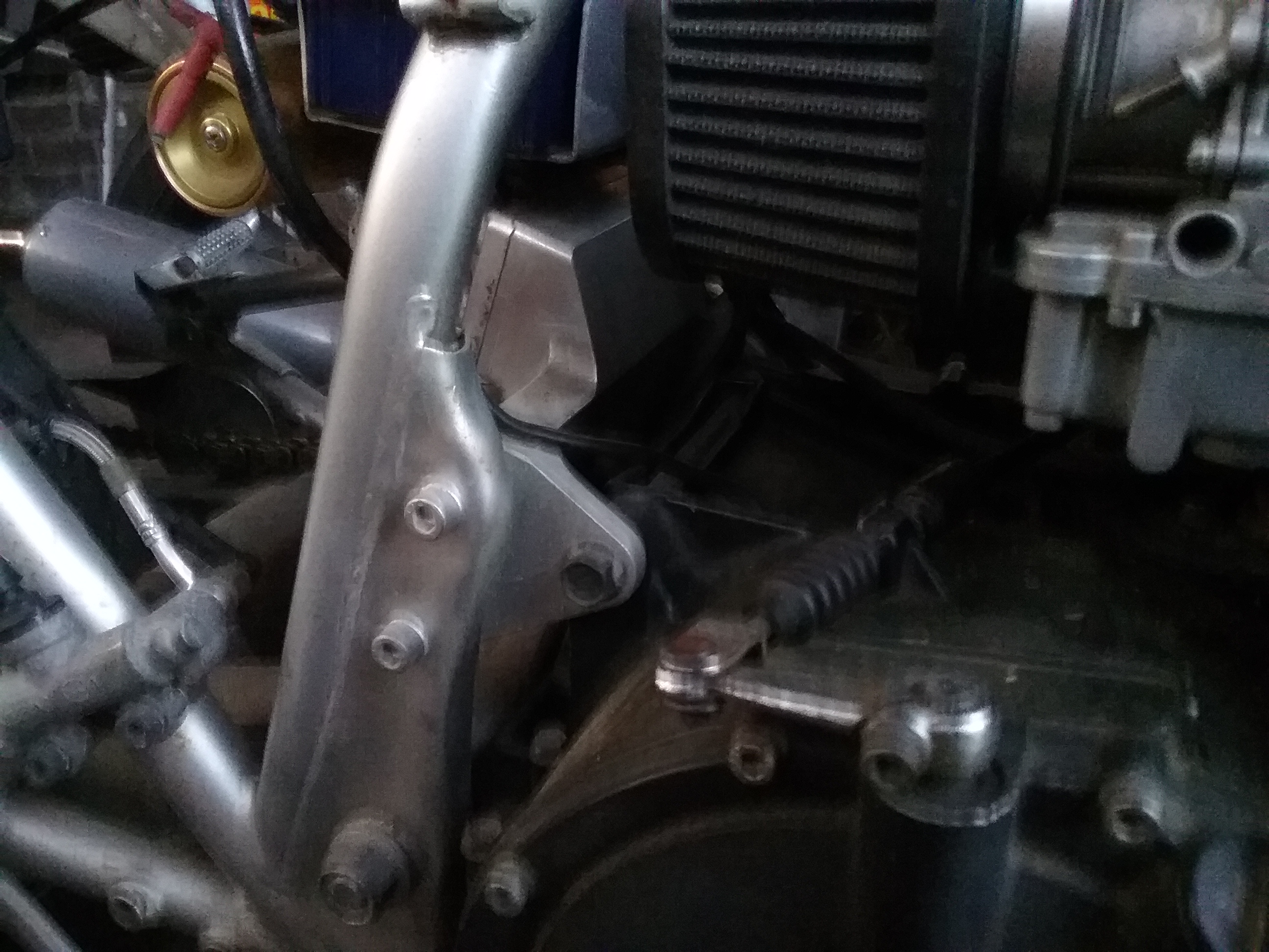

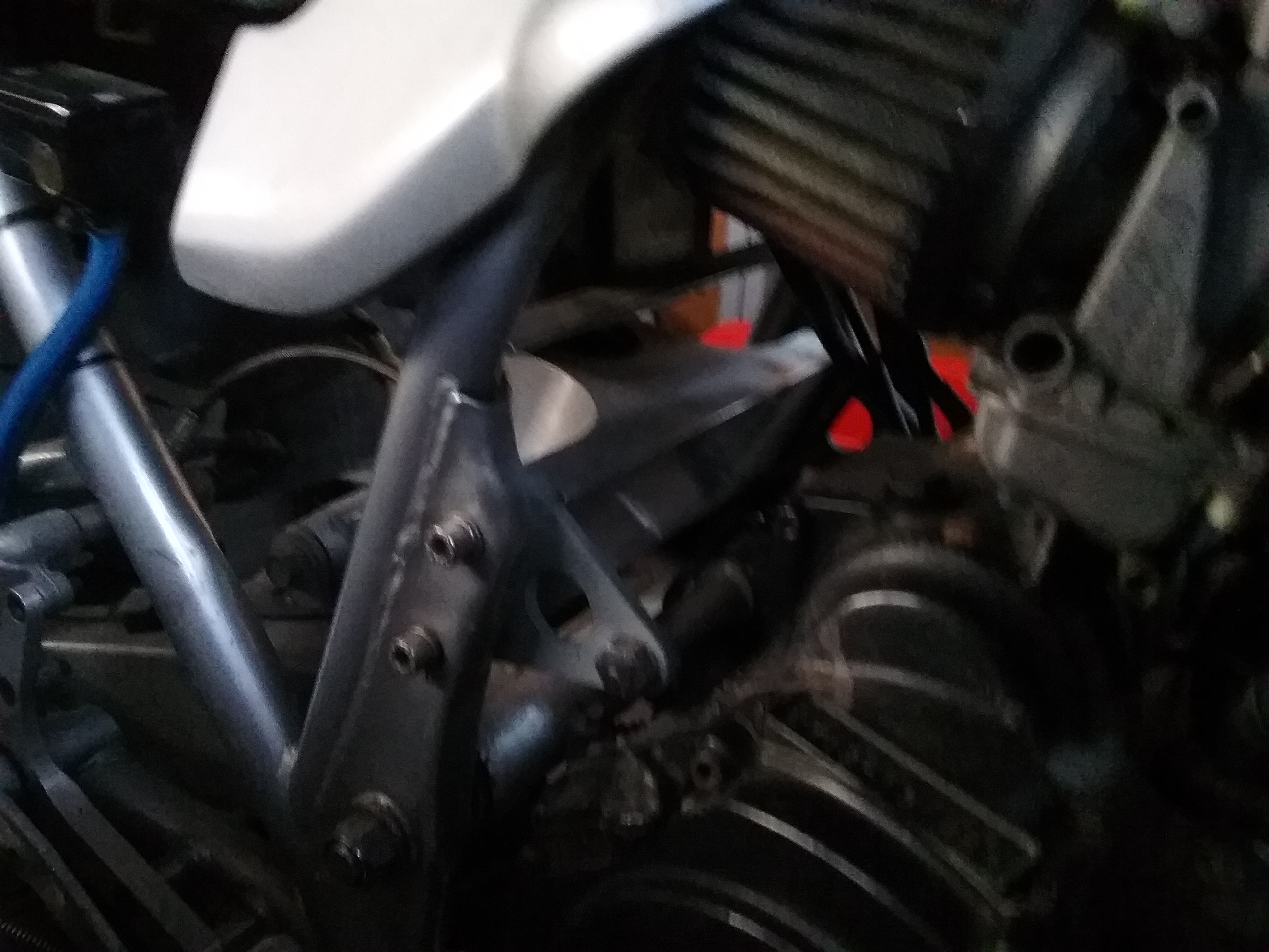

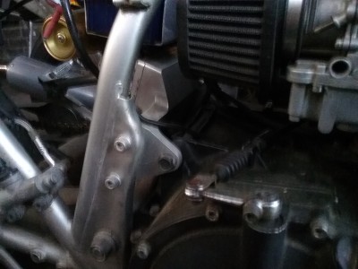

Took two bad snapshots of the recent brackets I'm currently using on the Kats. I bet there's some better ones in my build thread. I'm not saying you should do a monoshock conversion but consider a similar bracket. You don't have to do any welding and can always rearrange things back to stock looks by simply unbolting the bracket. Good to keep up the value of the bike in case you decide to sell it some day. Unmolested frames, you know?
