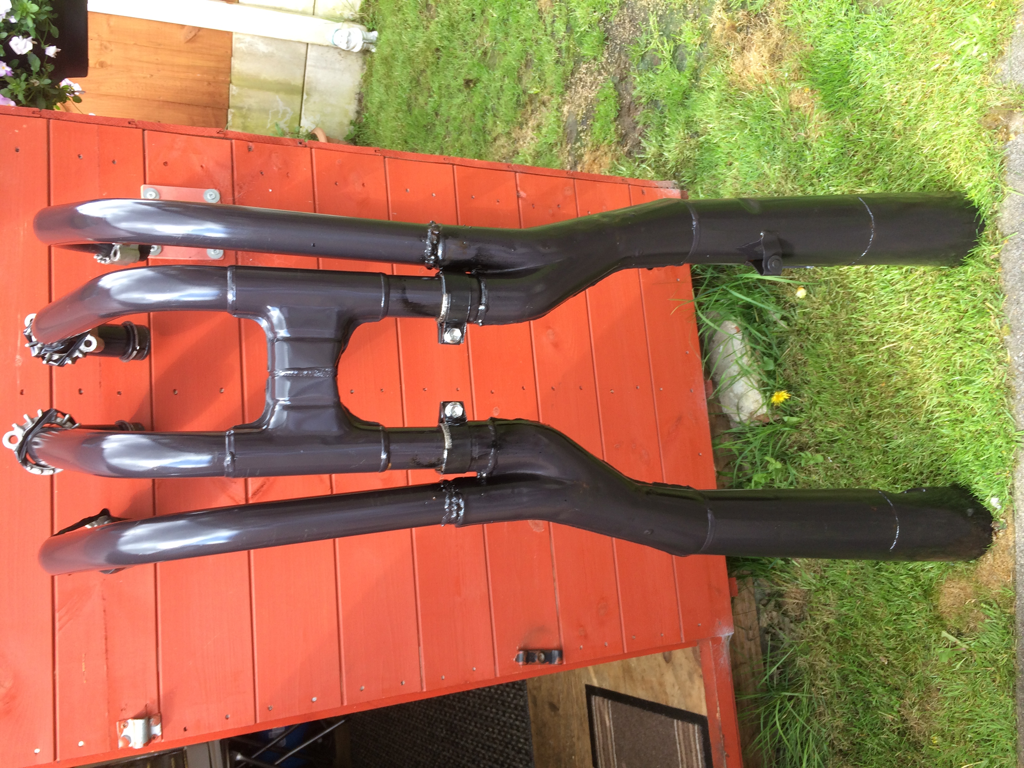

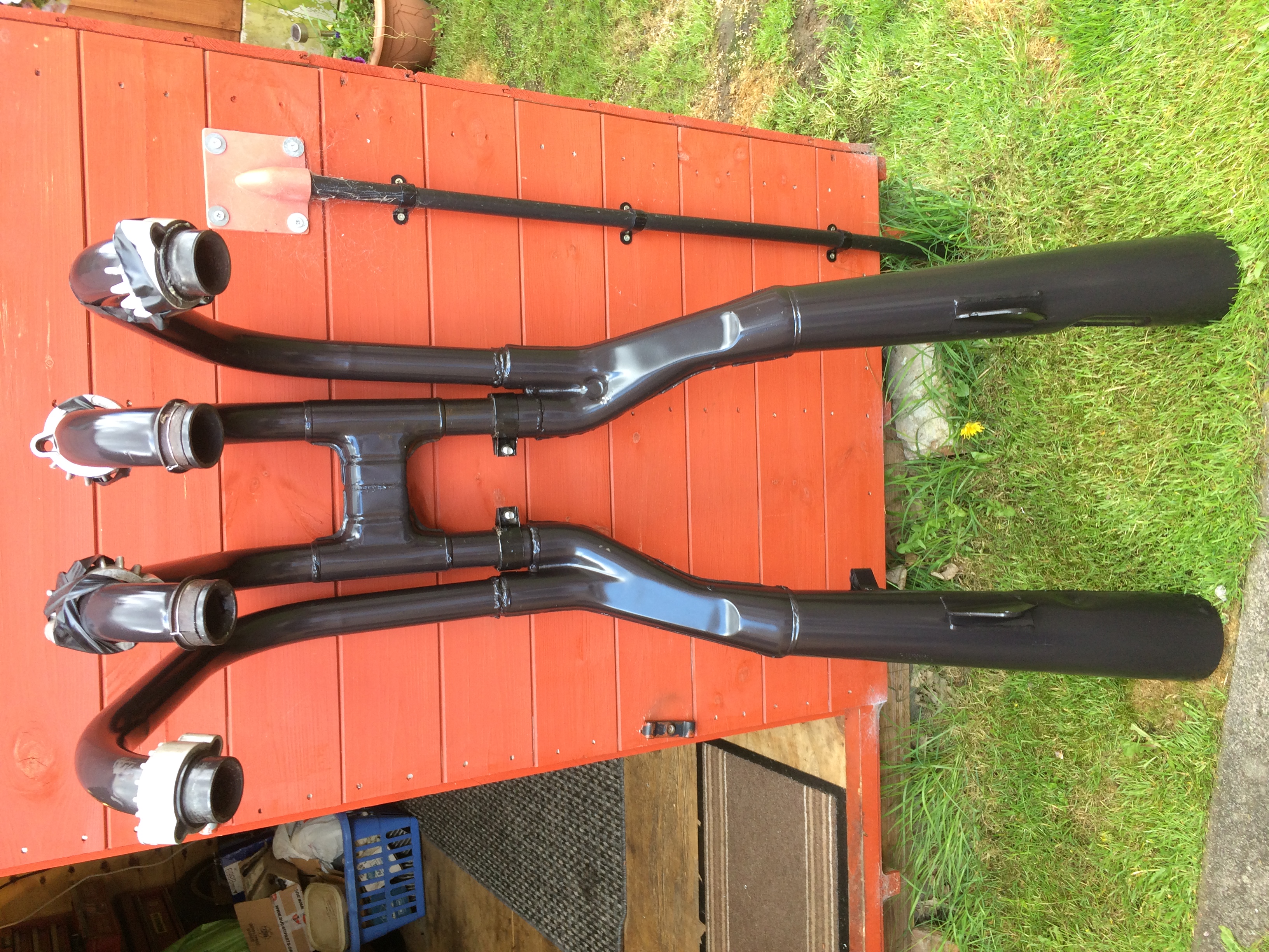

Well I’ve assembled the whole system ready to attach it to the bike. I’ve got new clamps and joint seals fitted ready to go. I paid particular attention to lining the downpipes up and making sure they are all leve where the fit into the head. Unfortunately rain has stopped play today so the big moment will have to wait for now. I’ve attached a couple of pics showing the system which the previous owner has nicely repaired and refinished.

Do you know how they were refinished? They look nice. I would have stored them and kept the 4-into-1 one, much better sound, but each to their own

finish looks lik ceramic coating, fab stuff but can be prone to turning grey after a bit of use, particularly the downpipes.
