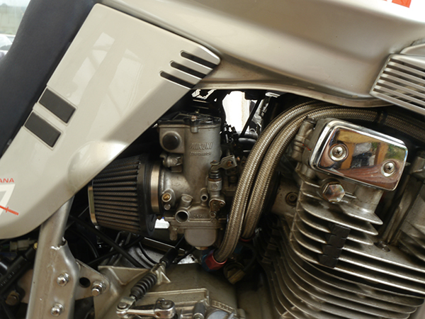

750sz sorted and running sweetly thanks for all help, appreciated -Unfortunately its stablemate, 1100 Kat is playing up at low revs, particularly in traffic -pulling off lights, stalling occasionally -methinks likely down to needle/jetting wear -Old set of VM33's, possibly not the most practical for daily rides in dense congestion, but luv em' on the open roads when wound up. Might be looking in all the wrong places but can't seem to find parts suppliers - Does anybody know where to get spares for these? Mikuni are currently running out and discontinuing old stock -and these carbs are pretty old now.
Another not completely unrelated topic -anybody know what's the difference between 'Standard' race Mikuni VM33's and Yoshi VM33's -would this just be in the settings/jetting for use with Yoshi profile cams/valves particularly? Aesthetic colour choice? Someone may know, I don't, but am curious...

and im told they work much better in terms of fueling and pickup/throttle re
sponse with bellmouths rather than just pod filters.

Bell mouths -with you, would howl with the intake roar, and breathing be a lot easier -didn't think about fuel, good point, but obviously less strain, more economy -so I can see that. Went to a Funeral in East Sussex on Wednesday, left Wales at dawn - 4 hours of constant heavy rain there, 4 hours in the afternoon back, and even with the K&N's it was spluttering and threatening to park itself on the hard shoulder several times, it really didn't like being waterboarded- Weather finally dried up and the Kat cleared its throat by the Severn Bridge for the last hammer home -just never know what's coming down from above -If I was back in NSW -in a heartbeat John. Love where I live with a passion, but at times it could do with a roof.
Do people use Bellmouths here on daily's?

and tbh, and this might get me some stick, as stonking as the carbs you have are, if its for daily use, the best carbs ive had on a gsx engine were the 38mm flatslide cv carbs off a gsxr1100m, they made mine go like stink, but were also tractable enough to let me pootle round town at low speed without going all spluttery, would scream away when the throttle was snapped open, as well as letting me run round in top gear at 2500 revs and wind the throttle open without bogging or stuttering. fab things. if its a daily ride, why not get a set and theen just swap to the smoothbores when youre off for a play or a trackday.

I read that the early GSX carbs are good -but wear on the needle collars unevenly, and quickly -stonking power from all accounts -36mm's usable as well? Swopping them would be the best option for 'playtime' -all comes down to getting hold of some, right jetting ( running Yoshi cams) and down to how many notes need to change hands to get a low mileage rack of them -Suzuki, so the spacing should be the same line up to the collars I would have though -pretty much plug and play?

Would the Kat Airbox fit? Be less prone to being temperamental in wet conditions, GSX-R carbs likely to be bit bigger at the induction end would have thought.

yeah, but i got some hydraulic hose that was big enough to make some adaptors. stock airbox would work, but then again, theres nothing to stop you fitting bellmouths with the open end inside your k+n's.
