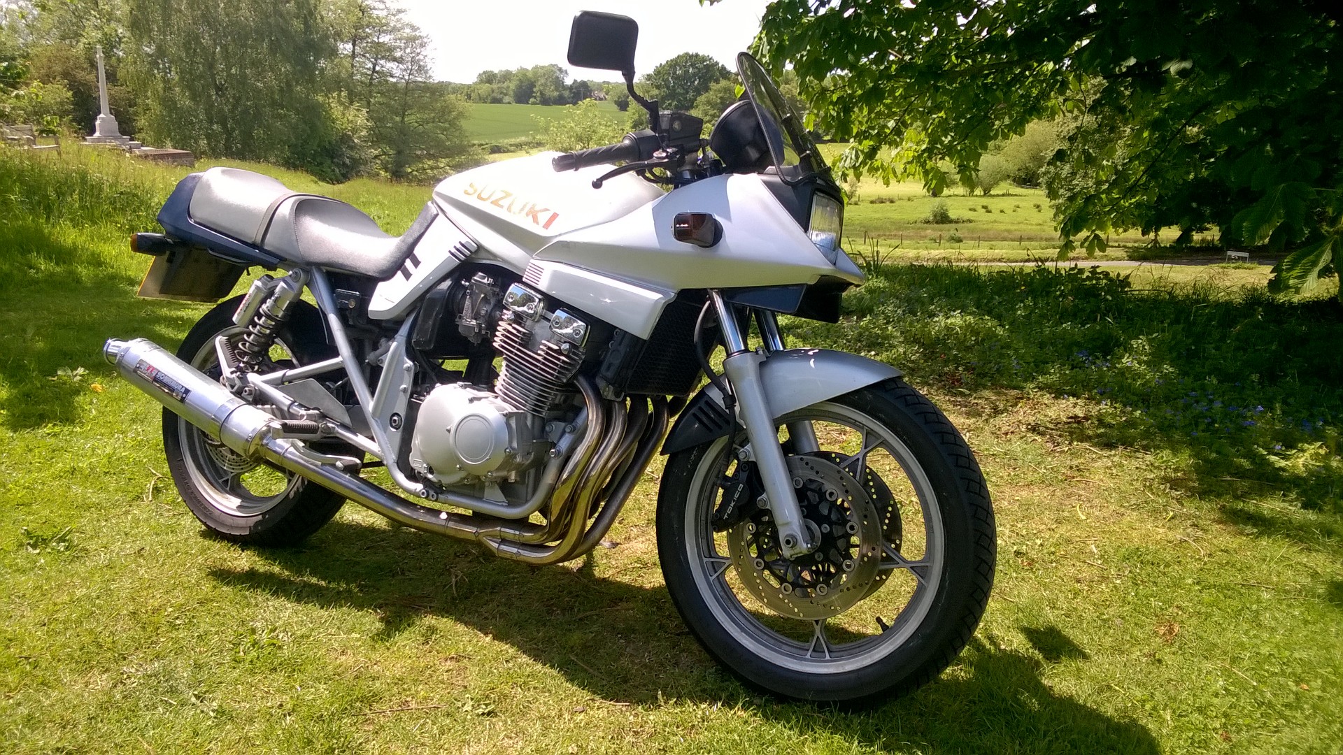

mk1 impulse pipe wont fit. mk2 impulse will and has the added bonus of being a nicely made stainless steel 4 into 1 system. bolts straight on with no mods required.

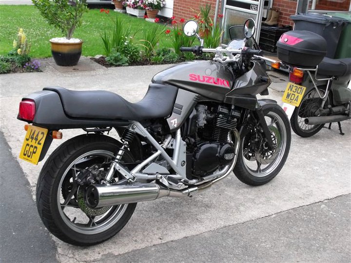

Trouble is as these bikes were Japan market then there are few spares for items that are bike specific in the UK. Looking on Yahoo Japan then there are quite a few but although the prices are not bad initially, time you add on the in between service, postage and import duty it can mount up.
https://buyee.jp/item/search/query/gk77 ... ?suggest=1
Luckily I had a stainless Yoshi on mine when I got it
I also strongly advise, unless it has been done, you get a Viton O ring kit for the carbs from here:
https://litetek.co/Carb_Kit_Suzuki_GSX400_Katana.html
Kit A will do, though Kit B is cheap as well but just for the fuel and choke seals not the Throttle screws / washers (which are a lot of hassle to do).
This will save you pain in the future if you are going to keep the bike and want it running nice (won't it JohnR!) Those carbs are a pain with the ethonol in petrol with OEM O rings and it causes really bad running (same with GSX-R400 of the same period).
Be interested to know how you got on with the exhaust, esp. if you get one made as it would be useful knowledge for the club and future owners (though there are not so many out there).
I think the 400 is a lovely bike to ride (I have 2 1100's as well) but on the B roads I tend to ride around Norfolk / Suffolk, it is a lot more fun and easier on my body. Not bad for touring on as well - took mine to EuroKat 8 in Denmark this year.
