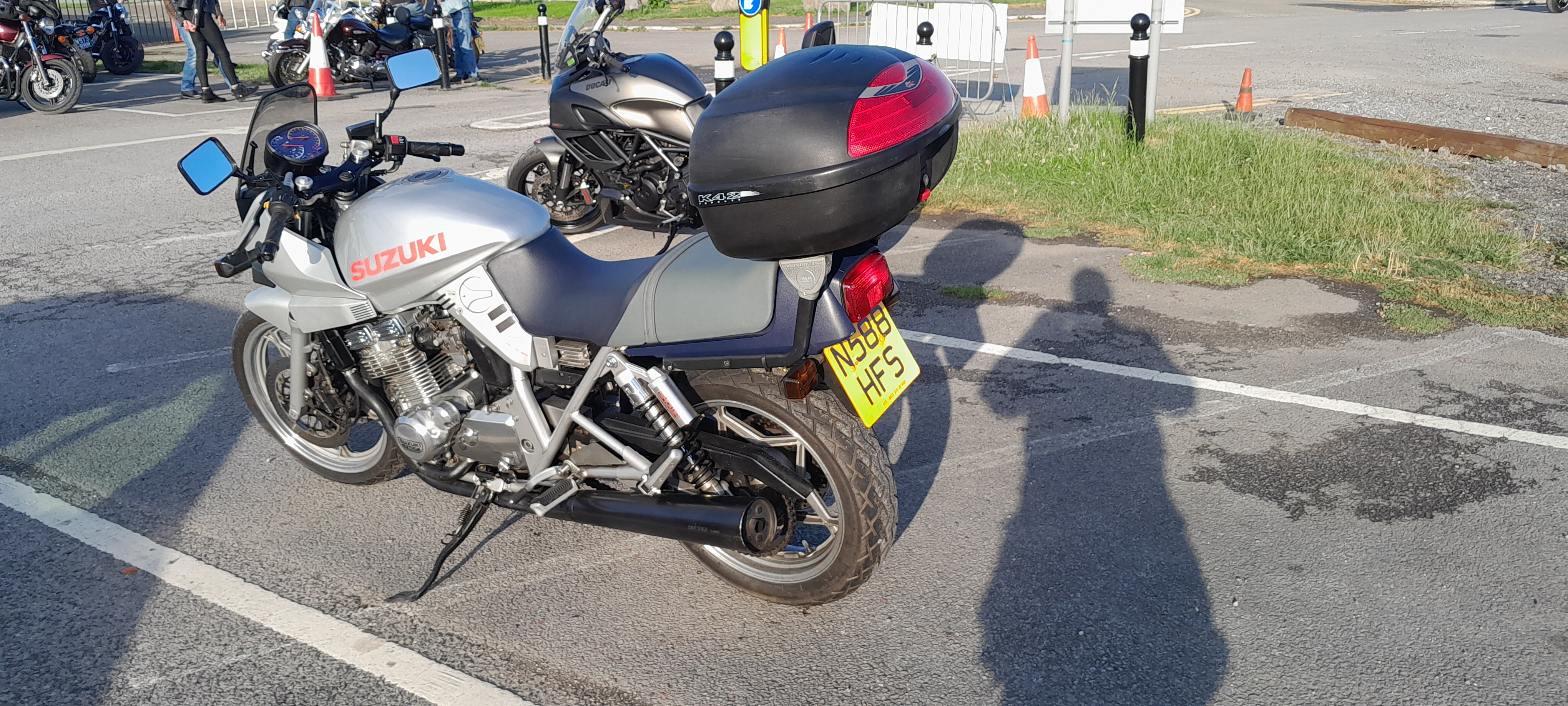

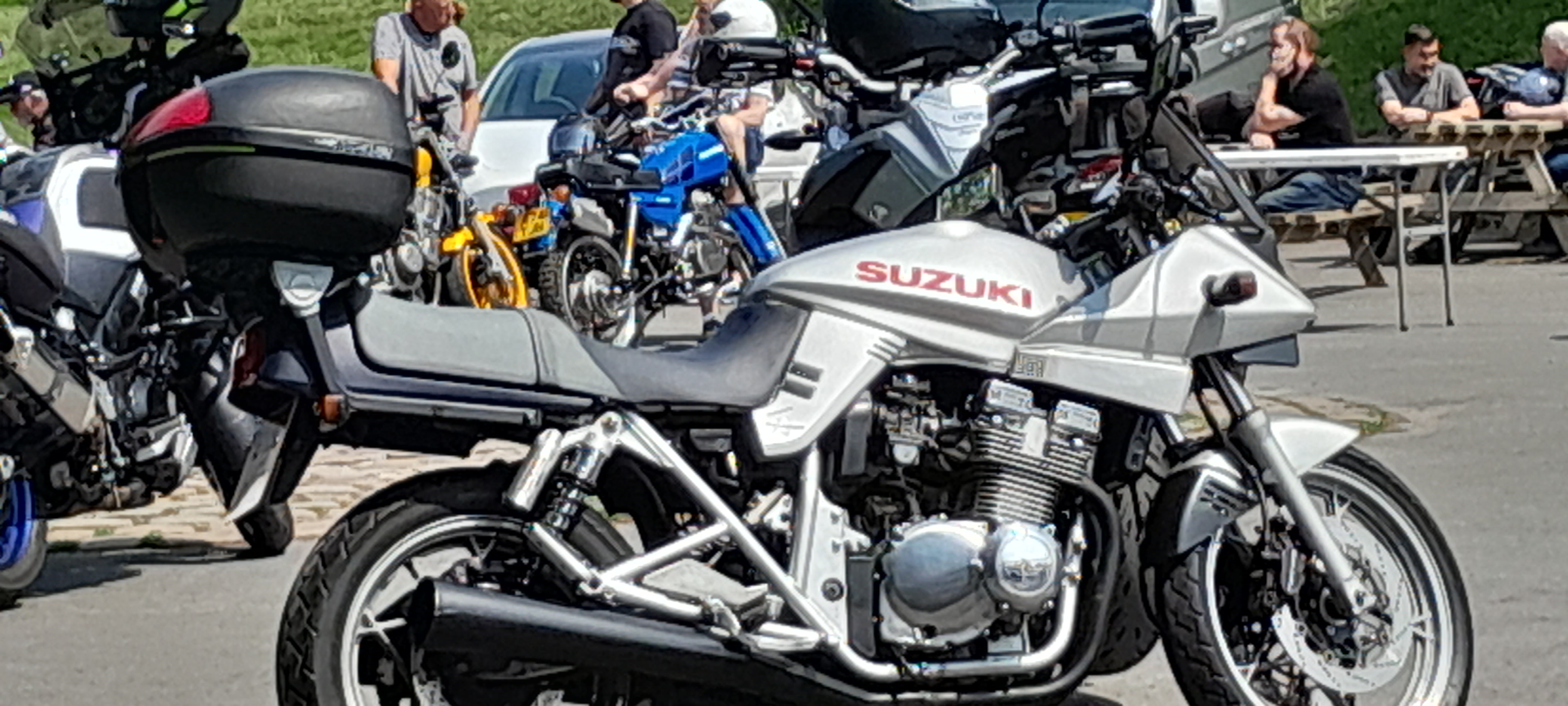

Anyway. Now that she runs like a top its time to turn a pretty toy into a useful tool. I know carriers and top boxes are anathema to some, but a bike is pretty useless to me without a Givi on the back. I seem to travel with a boxfull of wet weather gear, camera, sat nav, some useful tools, smoking sundries and a handy place to shove the helmet at stops. So, I set too with my go to Give rack, the ZZR600 unit, a simple straight bar with a nice angle arm up to the box mounting. A day spent carefully cutting and fitting and....
Next little task. I don't know why Suzuki chose the gear ratios on this engine. With standard gearing, 1st and 2nd are virtually useless, the revs going ballistic to move it up to 5 - 10MPH. Looking through gearing choices, the best compromise I could fine was a 16 T front sprocket (14 T standard). It transforms the ride, making the lower gears far more long legged and has not affected top speed in any appreciable fashion. The best of all the mods I have done and heartily recommended for the small price it costs.
